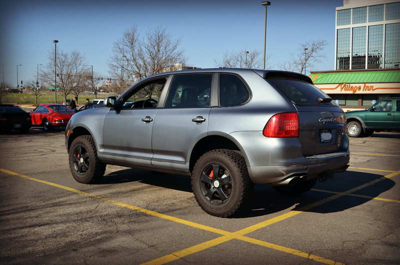

Question
Originally Posted by denversteve
Whether you "can" do it, and should do it, are two different things. It's a pretty big jump. You could probably go to 260 60R18 without problem. Why go 265/65? You're better off with full lock-to-lock turning radius and not rubbing under articulation - assuming you're off reading. If not, there's even less reason to chance rubbing and turning problems.
.....and what is your experience with these sizes?
Just curious because I've been running the 265/65/18s for quite awhile now with zero issue. It was also the size used on the Transsyberia race Cayennes, that were not allowed to modify the suspension or body work.
So, just curious what you are basing your info on?

Two things: One disregard as I now see this is 2 years old. Two you're obviously (from your photo) running a modified suspension or have the air suspension set to the highest setting - both of which negate your question and/or the parameters of my answer. Glad it's working out for you either way. I raced these for over 5 years and under full articulation and/or locked steering at speed 265's usually rub too much with a stock suspension.
