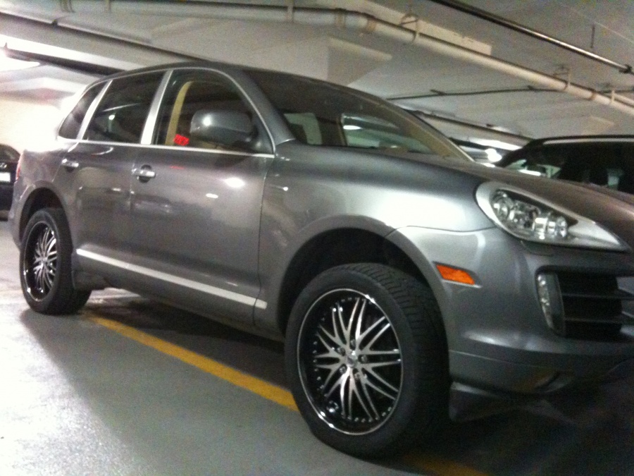

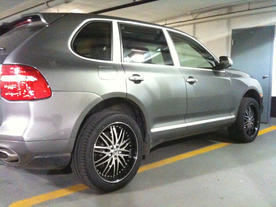

Old Aug 25, 2011 | 01:37 PM
getmefly's Avatar
Joined: Aug 2011
Posts: 5
From: toronto,ont.
getmefly is infamous around these parts
Pic with 20" today !!
HERE IT IS !!
Old Aug 25, 2011 | 02:08 PM
roxboxxx's Avatar
Joined: Mar 2009
Posts: 927
From: NJ
Rep Power: 70
roxboxxx has a brilliant futureroxboxxx has a brilliant futureroxboxxx has a brilliant futureroxboxxx has a brilliant futureroxboxxx has a brilliant futureroxboxxx has a brilliant futureroxboxxx has a brilliant futureroxboxxx has a brilliant futureroxboxxx has a brilliant futureroxboxxx has a brilliant futureroxboxxx has a brilliant future
Looks GOOD! - Now shine up those tires man!
Old Aug 31, 2011 | 09:09 PM
Renaissance.Man's Avatar
Moderator
Joined: Jan 2011
Posts: 1,504
From: (in my garage welding something vicious)
Rep Power: 105
Renaissance.Man has a reputation beyond reputeRenaissance.Man has a reputation beyond reputeRenaissance.Man has a reputation beyond reputeRenaissance.Man has a reputation beyond reputeRenaissance.Man has a reputation beyond reputeRenaissance.Man has a reputation beyond reputeRenaissance.Man has a reputation beyond reputeRenaissance.Man has a reputation beyond reputeRenaissance.Man has a reputation beyond reputeRenaissance.Man has a reputation beyond reputeRenaissance.Man has a reputation beyond repute
Looks good.
I think Roxboxxx gave you accurate information. However, I know I have ordered aluminum hub centric rings to replace nylons with for piece of mind.
The aluminum rings are much harder to come by and not in all size combinations.
So unless it is really bothering you, I would leave it alone.
