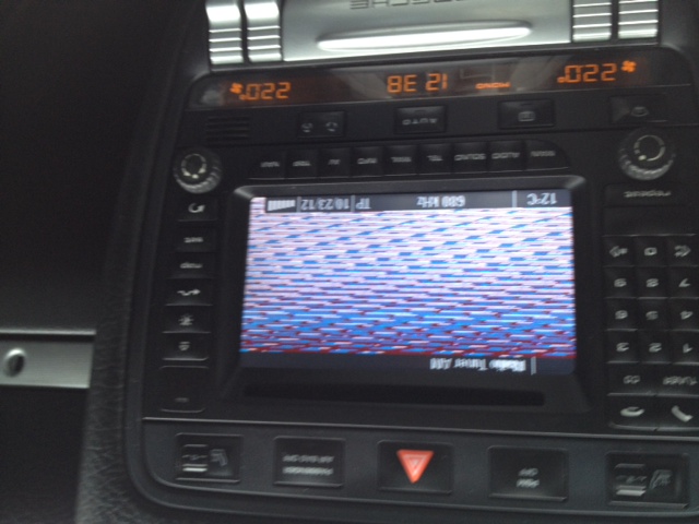

Hi, as of yesterday I encountered an issue with the PCM in my 06 Cayenne S. It turned on by itself a few times then the screen filled with multicolored lines. Everything works still except the screen is no longer legible. It returns to normal once in a while for a minute or so but that's it. It will also randomly reboot now and then when its been on for over 10 minutes. In July I had the Mobridge Ipod integration unit installed but haven't had any issues, other than the annoying background beeping that some people have mentioned. Has anyone encountered this screen problem before? Any suggestions are greatly appreciated.

I think I see the problem - it's installed upside down so all the electrons that are supposed to fill the bottom of the screen and get pumped back to the top are getting stuck.
Really - it's not hard using almost any photo program to rotate a photo so top is up. And given the problems you have, I think your PCM is kerjunked.

Before you throw it out or replace, I would take the unit out, disassemble and make sure that all ribbons/wiring is properly installed (reseating it all). It is possible some connections are not making proper contact and you get this result.
Something you can do in about 30 minutes and is worth a try.

I took the unit to an electronics shop, after a couple days they informed me they believe the problem is with the graphics chip. Unfortunately the chip is not available, as it is programmed at the factory in Germany.
Needless to say I still have the defective screen, the fact that it will shut itself off repeatedly and i cant see it is annoying but spending over $2000 on obsolete technology doesn't make sense. Sorry I couldn't be more of a help.

Thanks for the info @ciaka! I emailed him and sent him a screenshot of my display error. According to him, it needs a LCD replacement. He quoted me $230 shipped, cheaper than anywhere else on the internet. Hopefully it'll fix the problem!

I took a closer look at the screen online, and it does look like the LCD does have a PCB (printed circuit board) behind it, and that is where usually the circuitry and chips are located. It may well be where the graphics chip is located for your display.
If this is a straight display swap, I already took my PCM apart to see how it works, and there is nothing to it.
Here is some additional info:
1. tutorial and info from another 6speedonline member on taking PCM apart - CLICK HERE
Read his symptoms to compare to yours for reference. It has pics of disassembly, and videos of reassembly.
2. ebay auctions for lcd displays - CLICK HERE
The reason I am attaching these is to give you options - DIY, or send away. When I was taking my PCM apart, the most difficult thing is making usre you know which screw goes where, so as long as you can keep this stuff lined up (I used masking take to place screw near to where it will go back), you will be OK. Patience, confidence and time.

had the exactly same issues with my screen as shown in your pictures.
I ordered a replacement LCD from the ebay-dealer recommended by roxboxx in his replacement-tutorial-thread, but to no avail.
I disassembled the PCM again in the Pepper while being turned on to doublecheck the wiring, I realized that the distortion went away when i touched the metal box with the green connector on the right side of this picture:
http://s412.beta.photobucket.com/use...ml?sort=3&o=44
After pushing that box towards the main-PCB and moving it slightly back and forth, it seems to have settled somehow and the distortion is gone.
Will have to see whether it stays this way with all the vibrations going on during driving, but at least it seems to be some connection problem with whatever is in that shielding-box.
