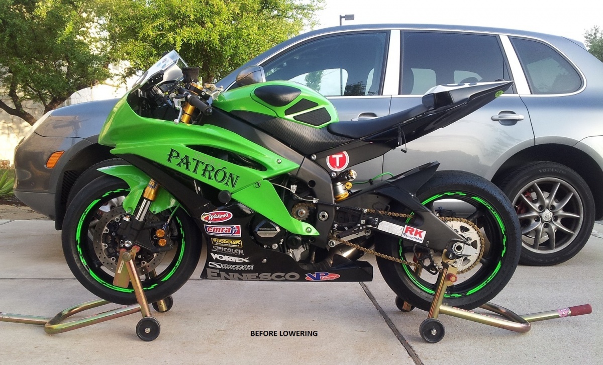

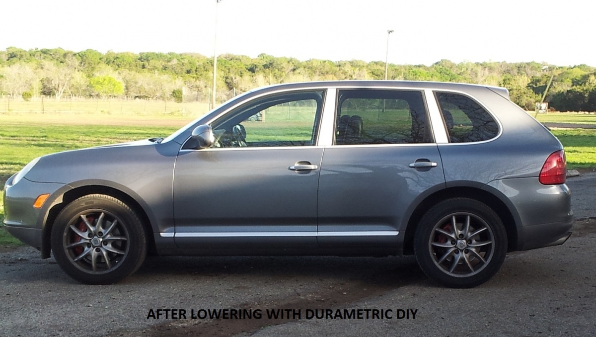

EDIT:
added pic 'after DIY lowering' for comparison.
here is a pic PRE LOWERING #will post post lowering for comparison later today#, excuse the fact the bike is in the way.
I was adding some wheel decals to the bike and was taking the pics of the bike, but car happened to be in the background. Coincidentally, did this a day before lowering the car, so that is the only type of pics I have with pre lower settings.
FYI:
WHEELS: 275/45 19"
SUSP SET: LOW with Sport shocks

Wow! Thats in Low mode? So high!

added another pic to my above post to compare before and after this mod.
Wow.. that is a big change! Now you just have to get some larger wheels on their to fill those wheel gaps.
