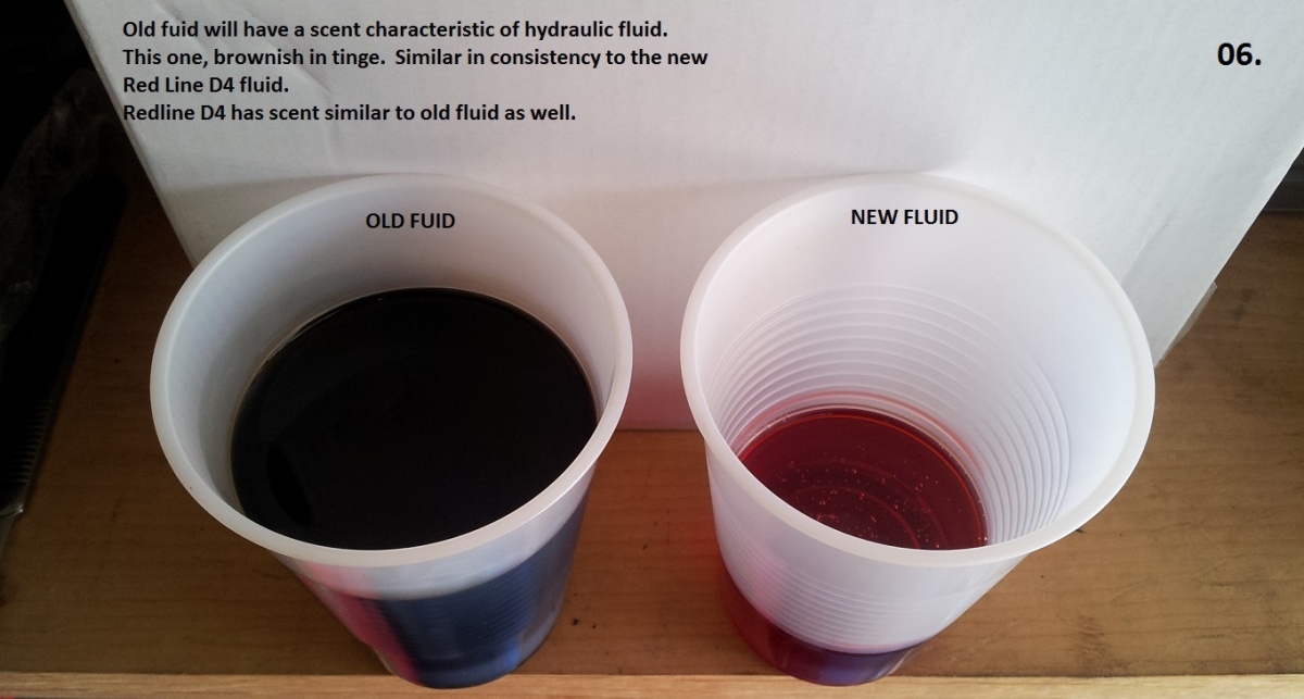

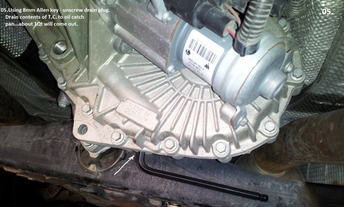

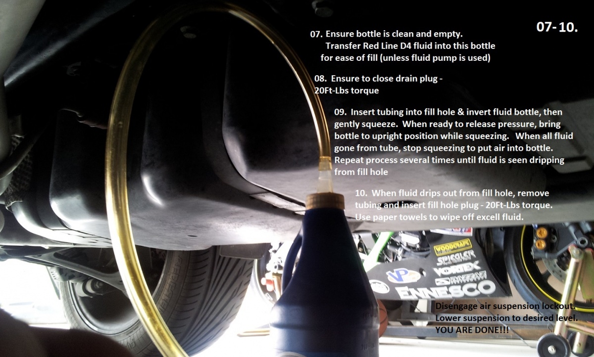

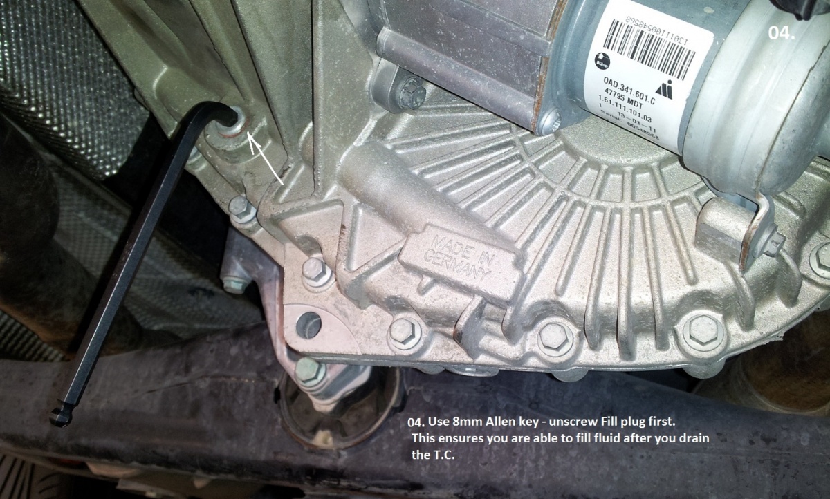

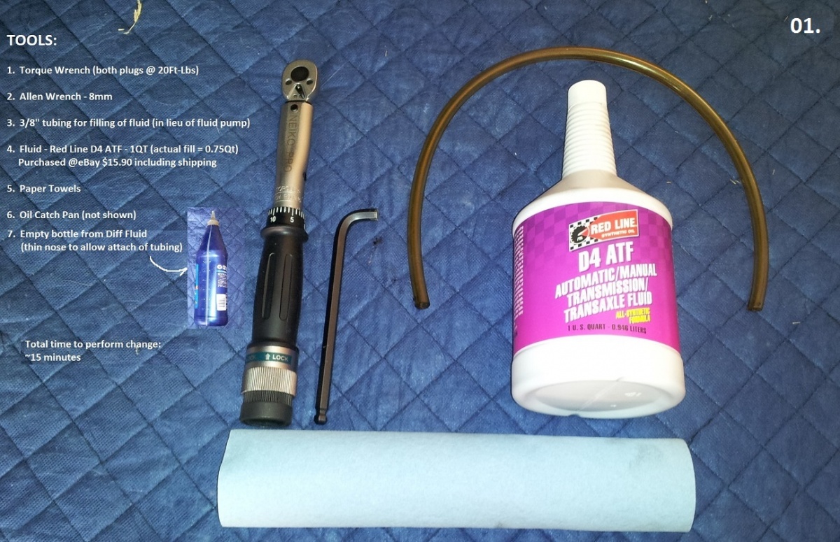

Here are steps to complete transfer case fluid change.
Used Red Line D4 fluid (about 16 bucks from ebay shipped)
Each pic is numbered in sequence of doing with step details.
Hope this helps someone here.

cont'd...

very important as ciaka pointed out that loosing the fill screw first before draining. just in case the fill hole is stuck.

Service manual calls for .75 Qt I believe, but since some is spilled due to fill process, you will use close to 1Qt. I used almost all.
