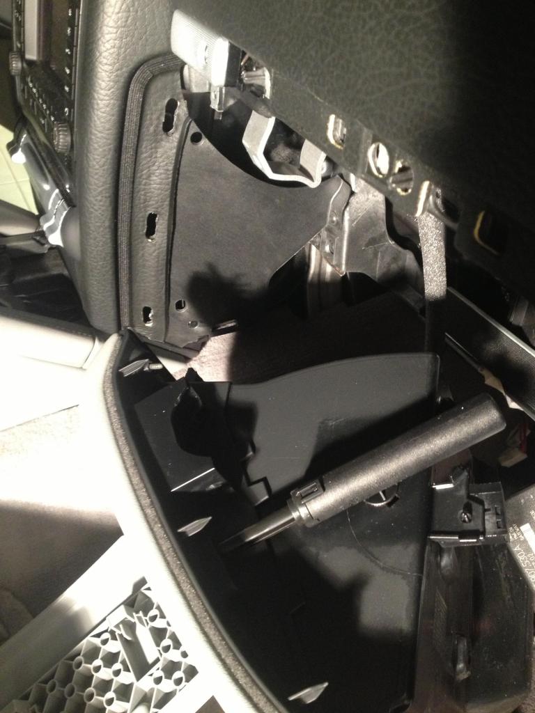

Finals are over so I finally finished this little project. I added a 5" LCD screen on the dash to view my iPhone for the Torque app and to double as a backup camera. Best app I found for streaming OBD information is "Engine Link" for iphones.

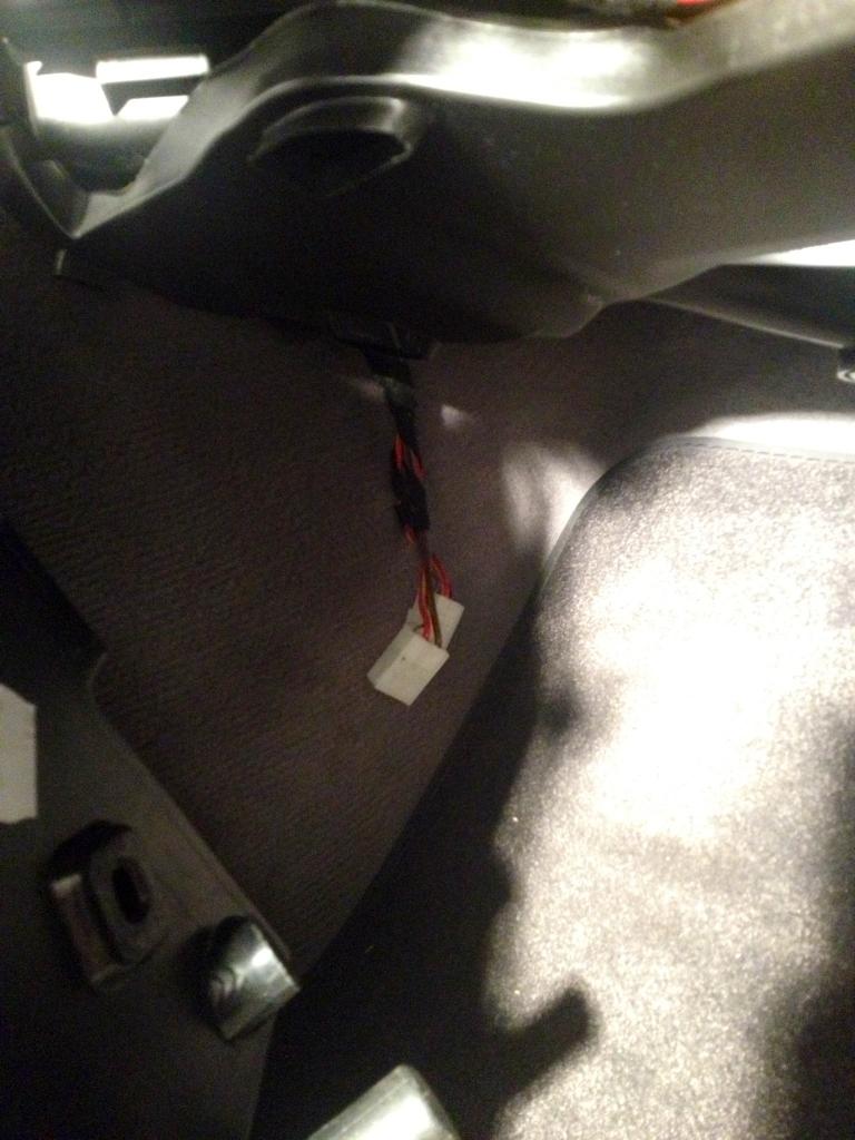

I did not want to drill any holes, so I ran the wire between the dash and the A pillar down into the fuse box.
I tapped into the fuse box so the camera receiver and screen will be on a 1 amp fuse. They will also turn on when the car is on.

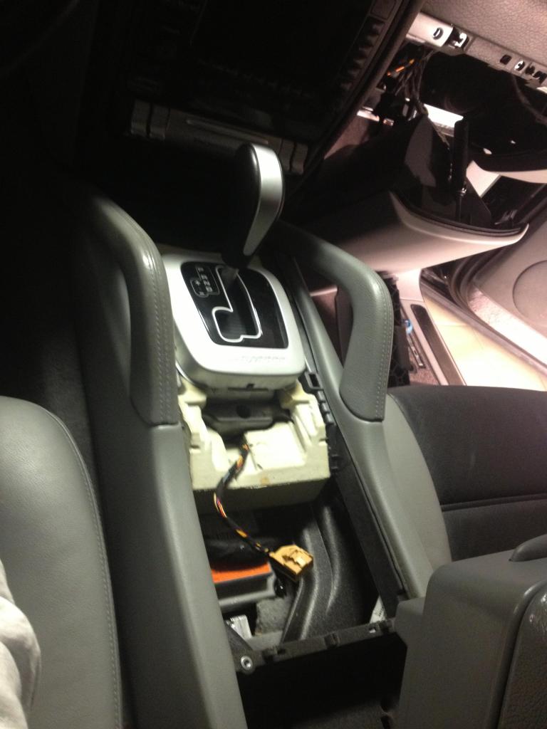

I ran an iPhone to AV cable into the console and fed it up to the fuse box. This way I can leave my phone in the console compartment and view it on the dash screen.

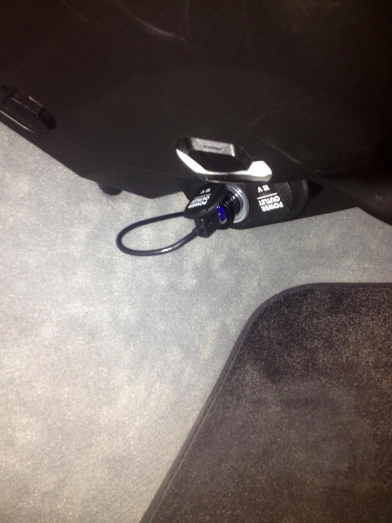

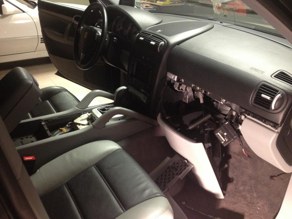

The glove box had to come out to remove the panel next to the radio and feed the wires through. I ran the usb wire that will charge the phone down to the power ports under the glovebox.
I did not want to hardwire the usb since the powerport to usb adapters usually die out after a year. It is completely unnoticeable unless you look under the glovebox.
Replacement screen arrived and is now installed.

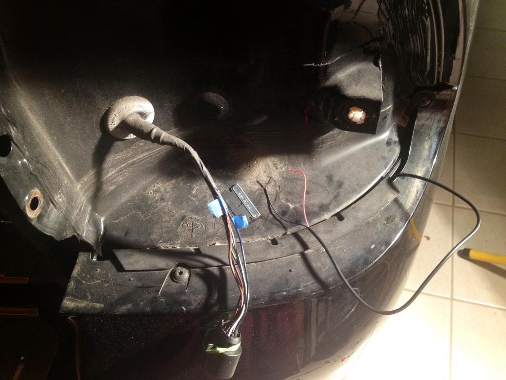

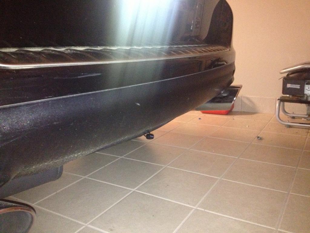

For the camera's power, I wired it to the reverse light and ran the wire down to the steel rear bumper where the camera itself is mounted.
