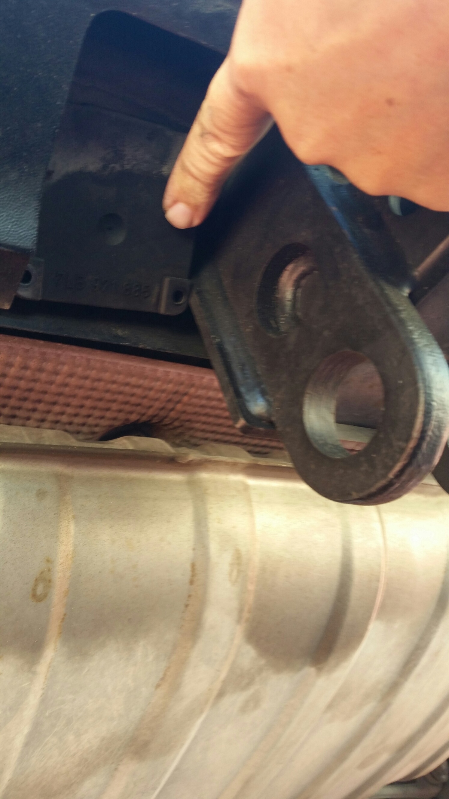

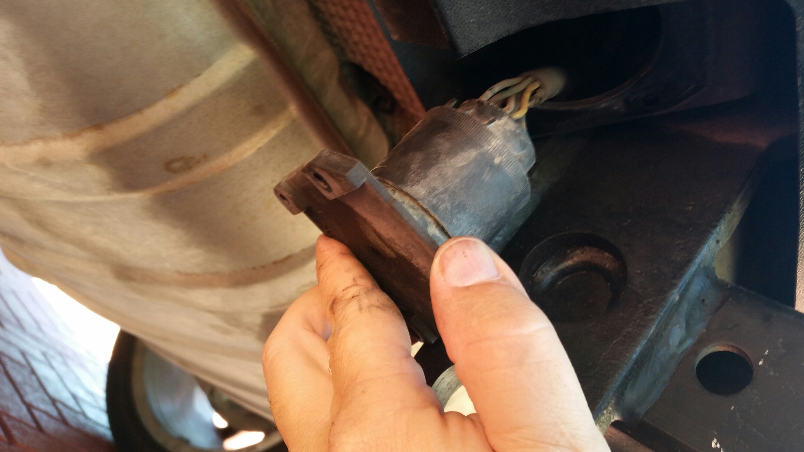

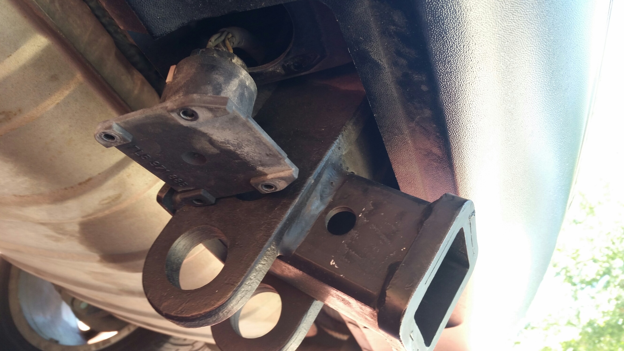

Hello, I recently bought an 06 Turbo S that has the tow package which was important to me because I often pull a boat. So I figured with the Tow package it would be ready to go like most tow packages. Hitch is there but where the wiring plugs should be there is a square cover with 4 screws. I figured oh great I have to buy something. I called the local Porsche dealer and the service guy said, oh just take the 4 screws off and everything is there. You will just need one of those round adapters (Which I already own). So I unscrew the 4 screw it is not all there. It looks like I need to add a kit or something. Anyone know what that kit is and where to get it for a good price?
That cover should release. The only item you should need is the 7-pin trailer coupling shown below. For more information Click Here.

That is exactly what I was looking for. I ordered it. Thanks for the help!!!
