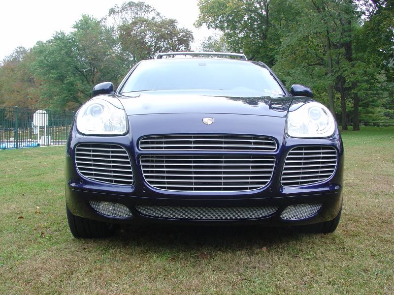

Mine would go on and off .......but like yours most of the time i would turn it on after over 12 hours of rest and it would flash but "correct itself" after a few minutes of driving..... i hope your dealer gets it this thursday......theres nothing worse than having the best SUV on earth and have it flashing malfunction lights at you!!!!!
Check out my gangsta lean on the old suspension.....

And to think some people try to do that on purpose...
