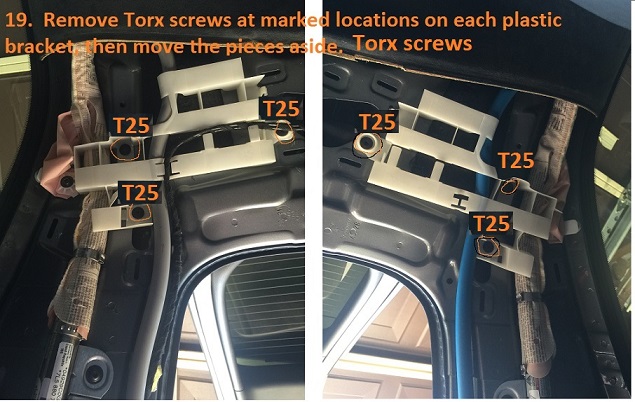

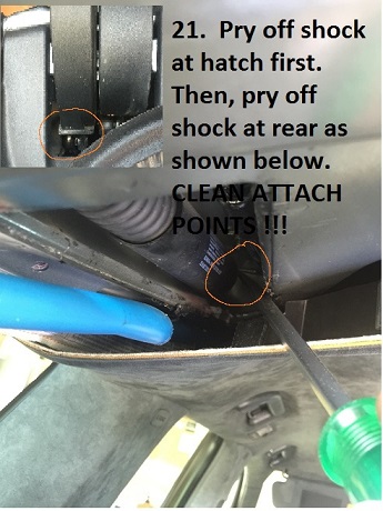

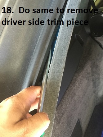

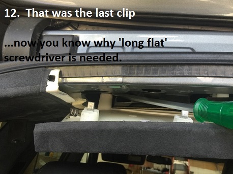

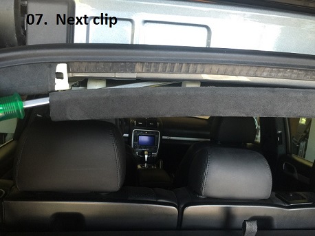

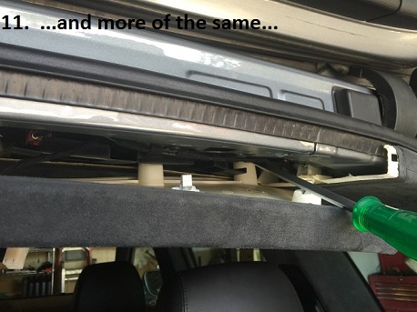

For those who notice their hatch hits them on the head when opened...lol.
If your struts go bad over time, you can follow this to do the replacement yourself.
Just did mine. Pretty easy. Take your time and all will be fine.
Recommend placing a blanket into the trunk, to cover metalic surfaces and bumper area.
I found it easy to work by getting into the trunk and lying down on my back to work the roof area.
If you wear anything metallic (on shoes, pants, etc), it will be easy to scratch metallic trim. Blanket removes the worry.
Follow my steps...

One BIG caution - you need some way to securely hold the very heavy hatch up before even thinking of starting this repair. It has to be something that can take some jiggling since some is bound to happen when disconnecting the existing shocks. I like the pole you used if it has a way of securing it to the hatch at the top. A stepladder will sometimes also work if it's tall enough.

The pole I used was a paint extension, with one of those twist to tighten mechanisms.
I extended to hatch, and then tightened as much as I could. As long as you disconnect one shock at a time, you will be fine.
Anything that props the hatch in place when opened all the way will work, but yes, it is heavy so if you do cheesy job propping, your head will pay the price.
