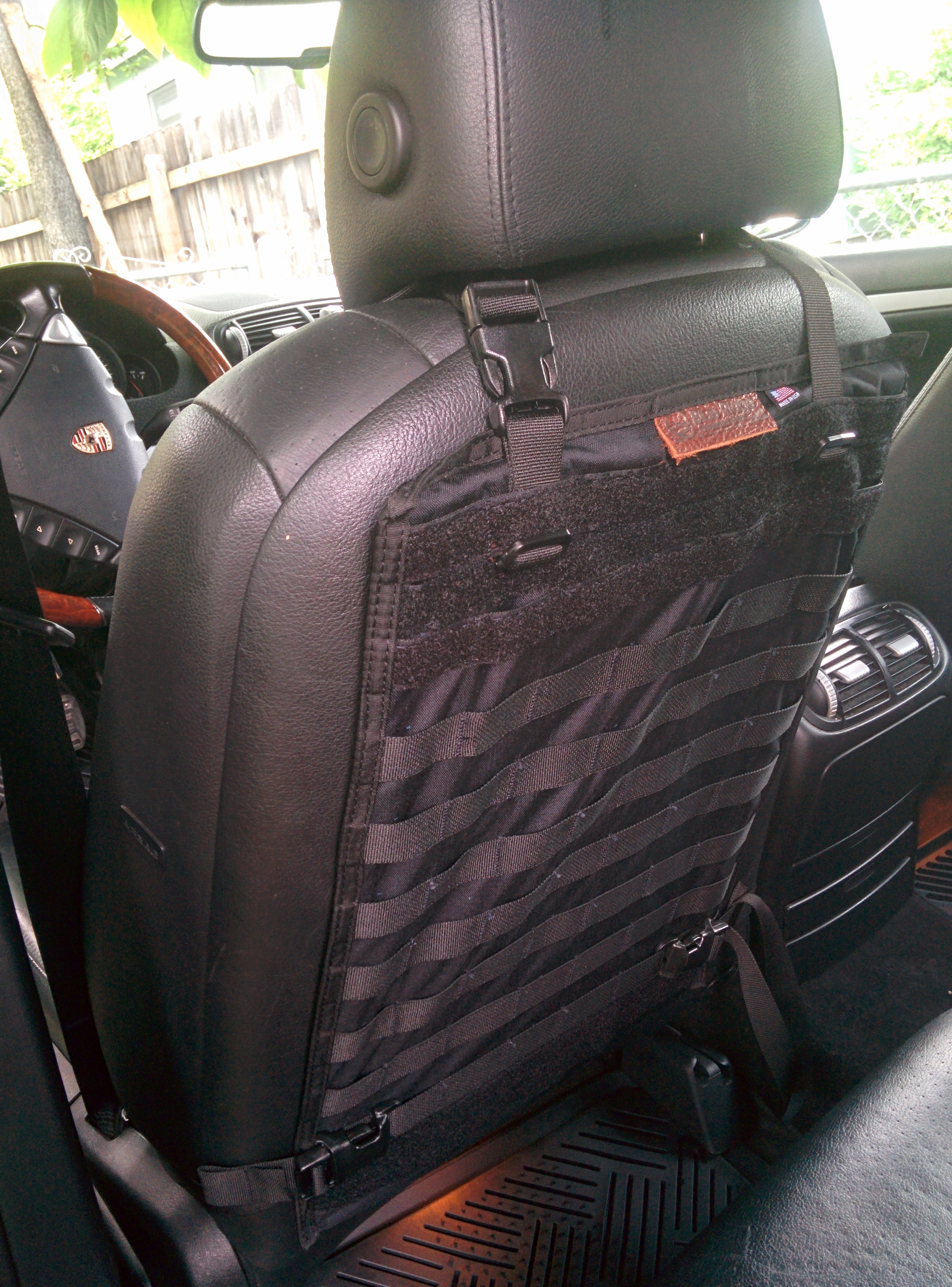

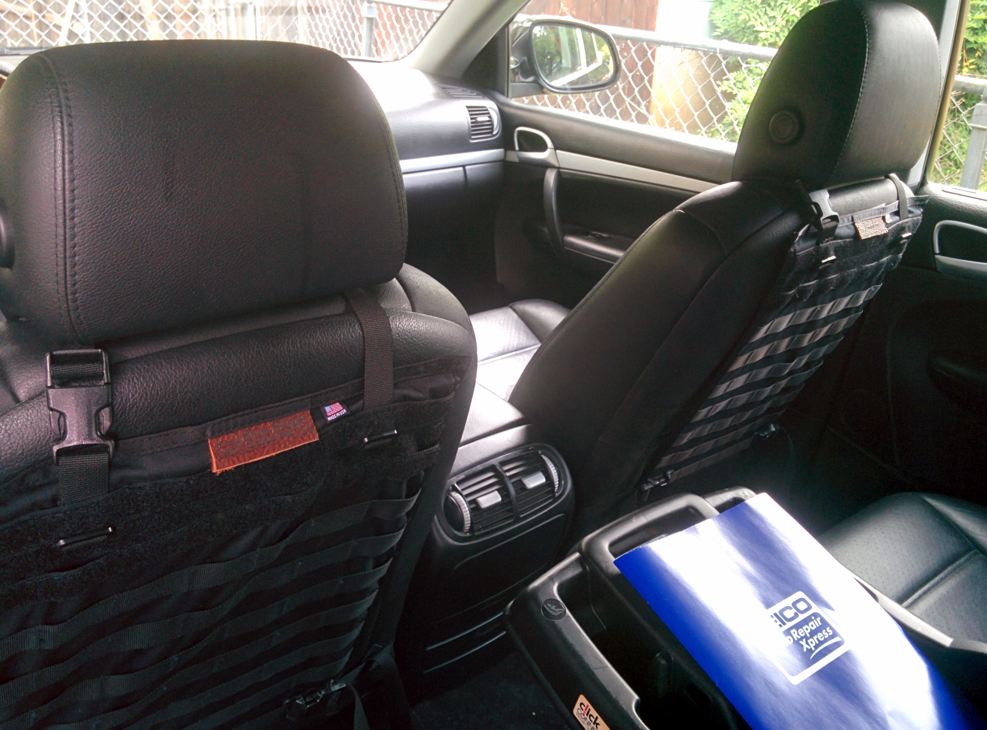

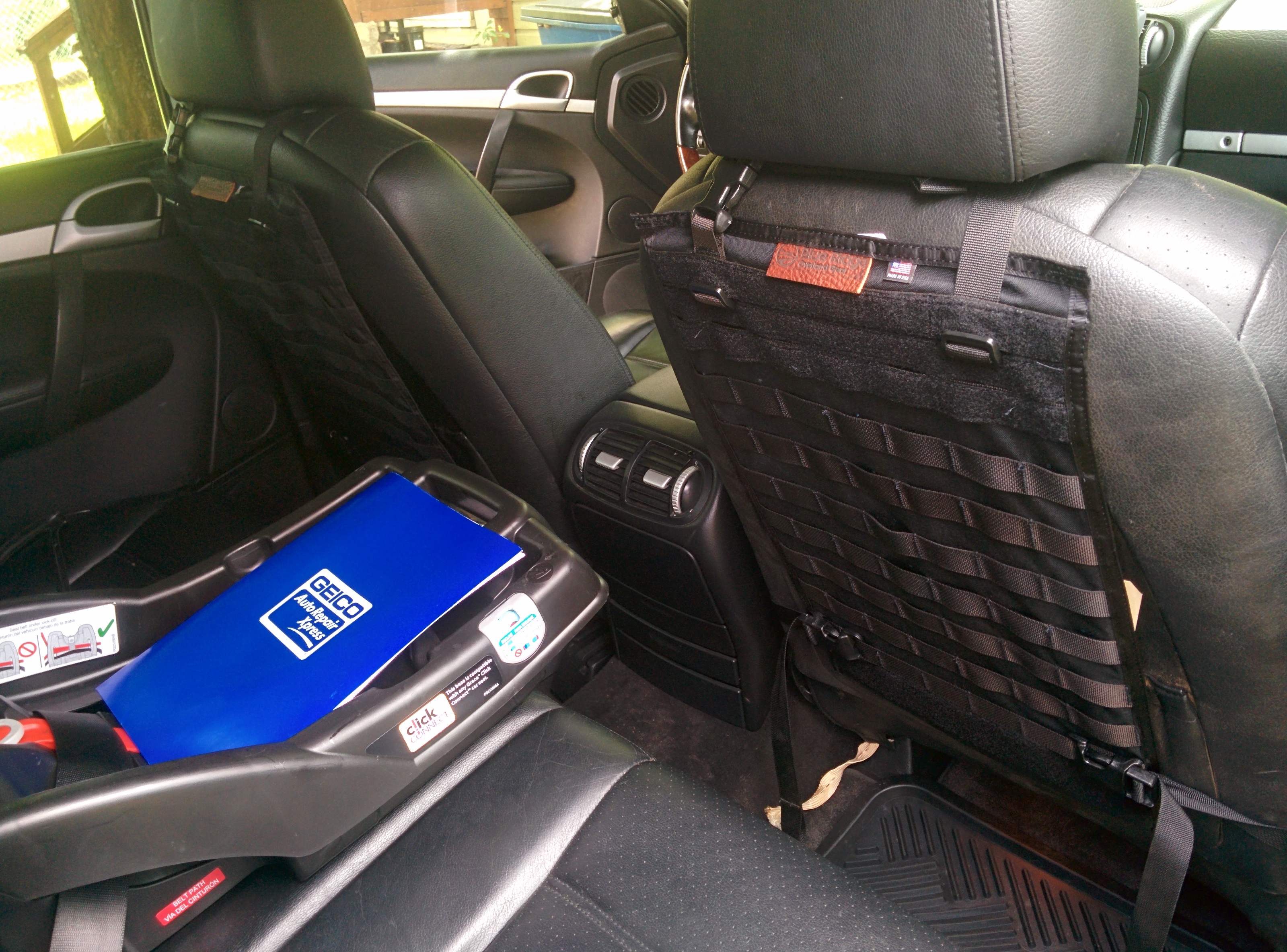

I found these Blue Ridge Molle panels are great quality and stop the seat back regluing I've been doing for 3 years.
100 buck's

Living in Texas you will find out how the seat backs are glued onto clips and they melt in our July/August heat after a few years of exposure.
I can buy 3M glue, the same glue I use to attach felt onto slate pool tables and it still fails within 2-3 months or any active use of seat's up or down. If you never put your seats up, you'll probably avoid the issue.
