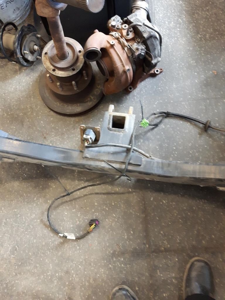

The control module has a female receptacle for 2 wiring plugs. I had my local body shop owner help with the install.
Neither of us can find the second pigtail in the vehicle's harness ...the wiring harness plugs into the rear wheel well harness. My question is does the vehicle's wiring harness have another pigtail that we just can't find, or do I have to unplug one from the other module on board just ahead of where the other module attaches ?
