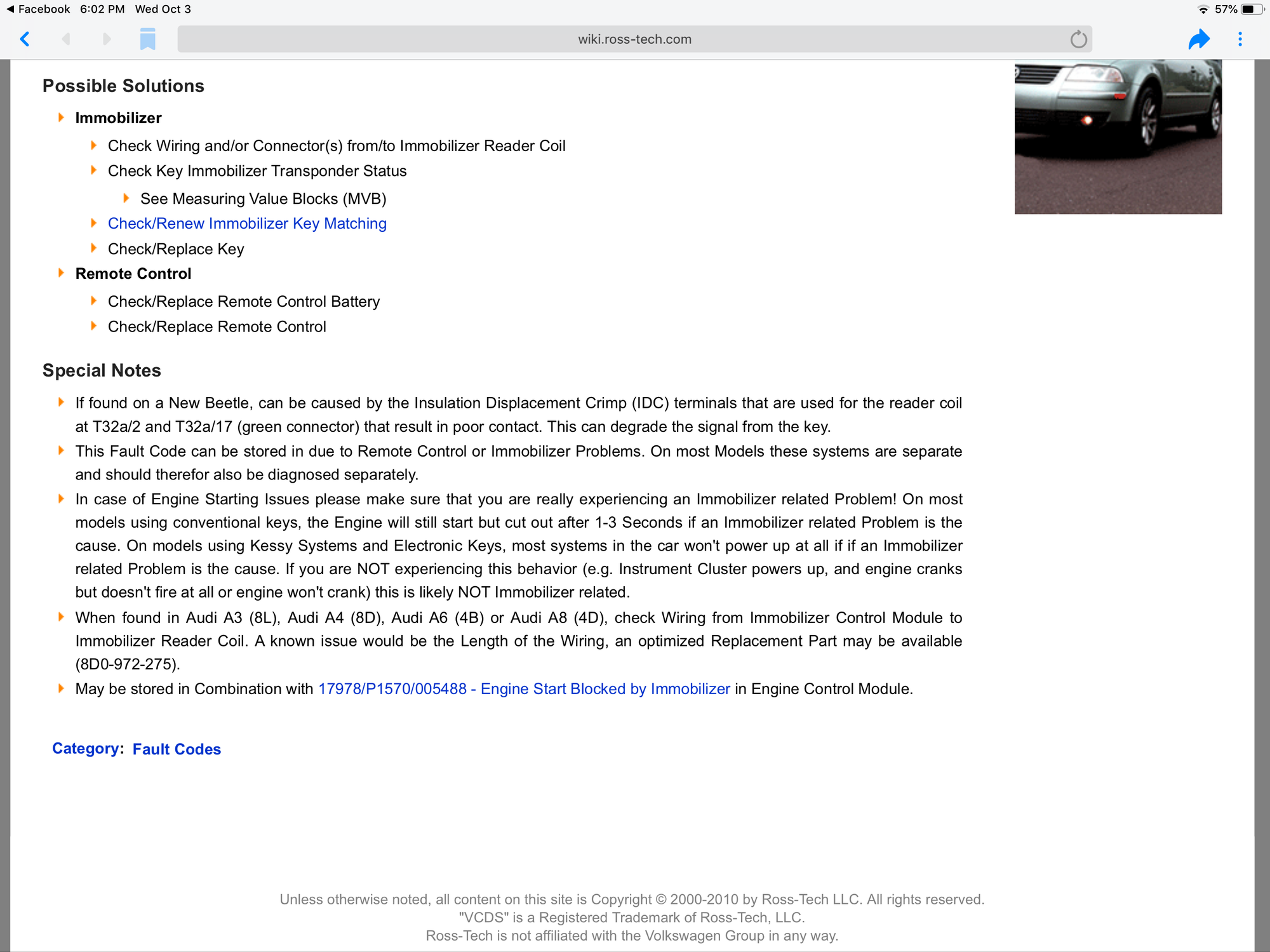

So today I pulled the drivers seat and installed a brand new battery. I also did a new remote battery and reset all of the codes in the car. They car is currently showing no faults besides code 1176 and still keeping the Immobilizer active and not allowing me to start my new to me cayenne. Can anyone please help with a bypass and or another way to start the car. I have the title in hand and not sure were to go from here. 300 plus people have looked at my post and not one person had an idea.

What diagnostics tool are you using? If it isn't Porsche specific you won't be able to do much, and even some Porsche specific ones (Durametric for instance) have trouble with some modules in the car. I haven't heard of anyplace that rebuilds the modules. There is a place that rebuilds the electronics in the steering column (Porsche only sells the entire column.) There is a relay in the column and a few reed switches that have been known to be a problem.

It appears you're using a VW tool to read and reset the system? The Porsche AllDataDIY website has a listing of all ECU (and TCU) codes - and there isn't a code 1176. The fact that the VW one references the immobilizer is certainly a clue - but the actual error may not be entirely accurate, and since you can't seem to clear it, it would seem to be pointing to the cause of the vehicle not starting. Perhaps you can find someone with a Porsche specific tool (Durametric, iCarScan)?
