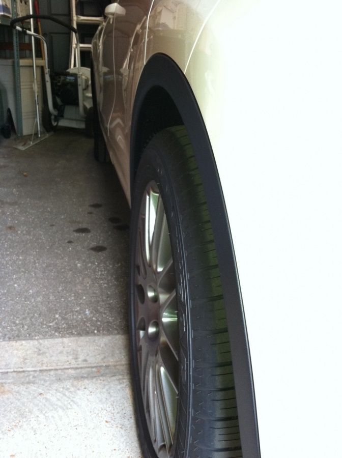

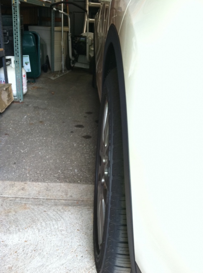

Install was simple, do you mean pics of them installed before the wheel was put back on? If so, no I dont.
Attached are some pics I just took, its bad lighting and conditions, just think of your rear wheels 3/4" further out on each side.
No noticeable difference in handling, although I installed right after delivery.
Sport exhaust installed tomorrow, get on it GBXSport!
Attachment 156231
Attachment 156232
Those pics are exactly what i wanted to see. Thanks! Spacers and sport exhaust, here i come
