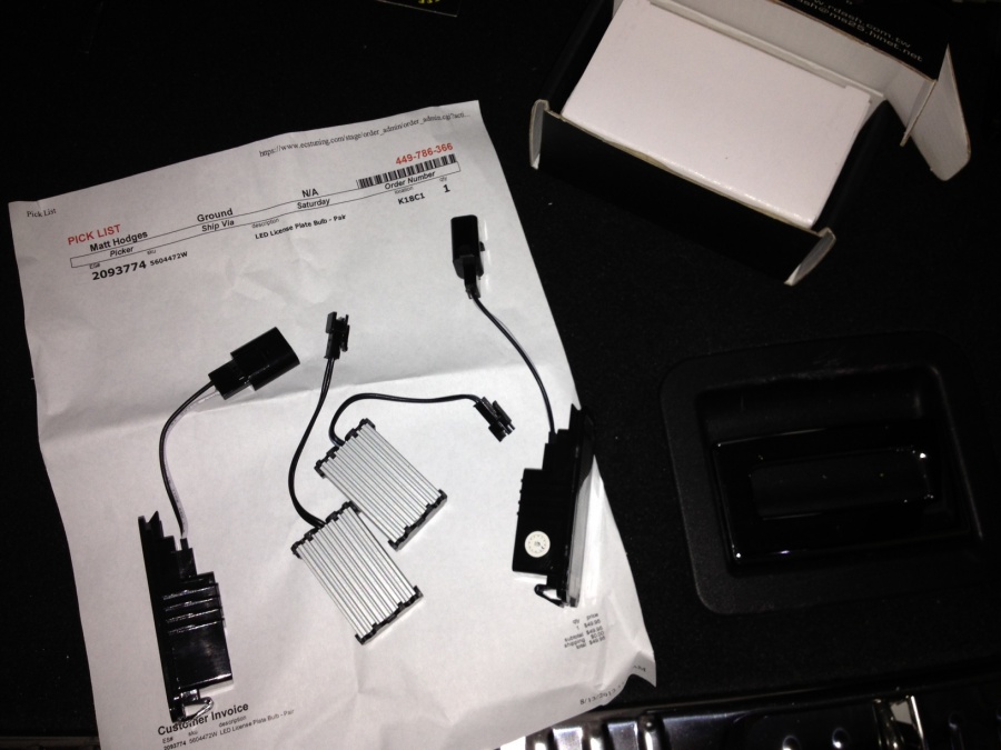

ondarza, thanks for the advice. Just an update, so I went ahead and ordered the LED lights from ECS Tuning and installed over the weekend. You weren't kidding about the right side being a tight fit. It literally took 10 minutes and every imaginable placement configuration to tuck the resistor and wire harness into the small space (I did not remove the panel). One thing I did not expect was the lights are quite bright..maybe too bright. I'm gonna leave it for now to see if it grows on me.
Thanks for all the helpful posts.

really dumb ? but where in the hell do the resistor plug into? the led housing plugs directly into the oem plug but i have no idea where the resistor goes and no instructions with the kit. they have a link that states install info but all it is a website selling more stuff....

Are you sure you ordered the right one? The harness should have two wires and two different plug ends. One small plug to the resistor and the other smaller plug end to the LED housing. The larger single plug on the other end of the two connects to the existing car's harness.
