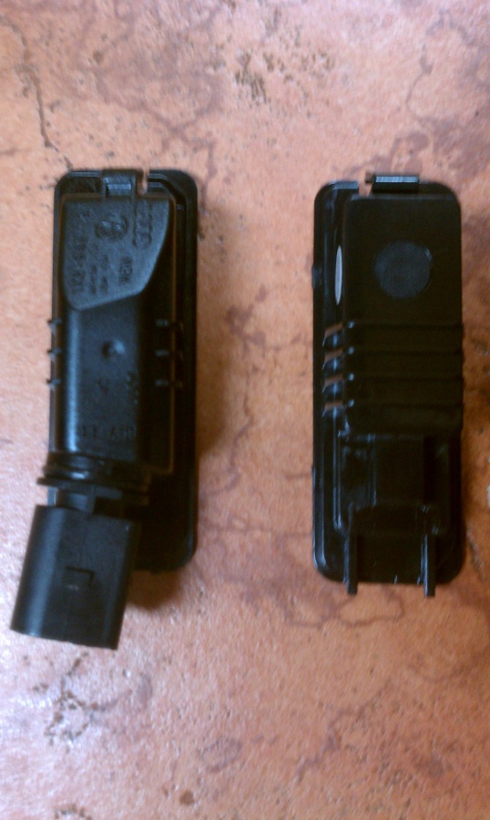

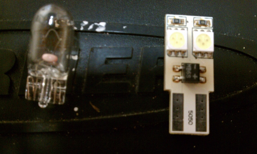

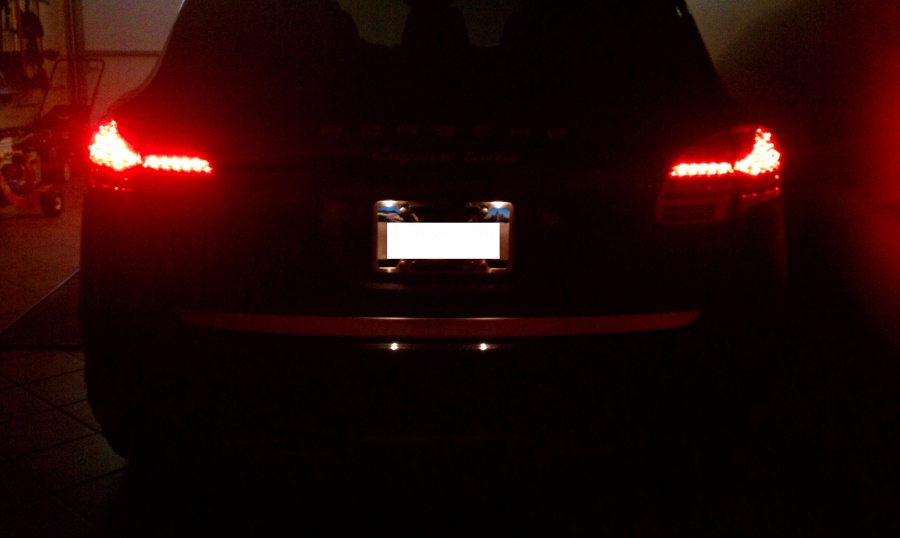

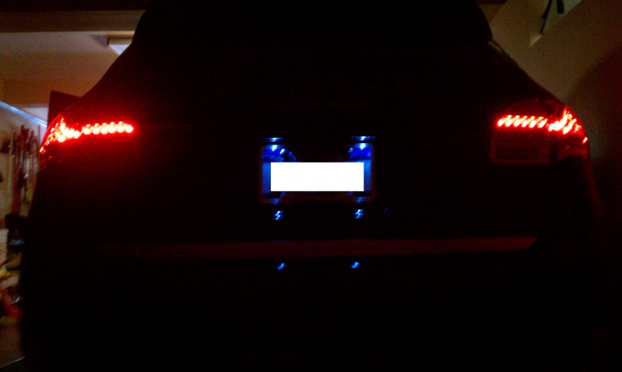

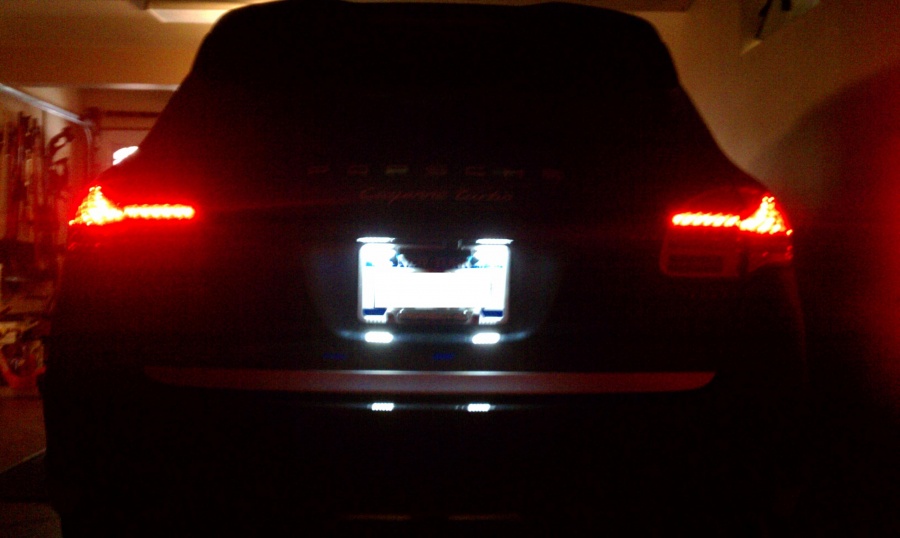

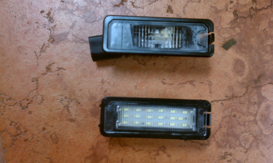

Received my Racing Dash LED license plate light from ECS Tuning this morning. Took me about a hour to install. Here are some pictures of the stock lighting, regular error free led lighting, and the Racing Dash LED license plate light conversion kit.

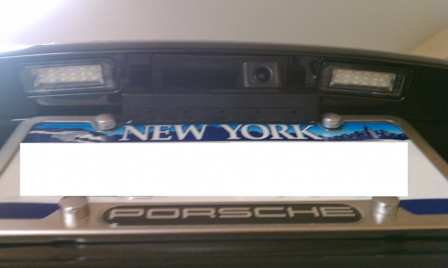

more pictures

Those LED's look great! Thanks for the positive feed back and the install shots
