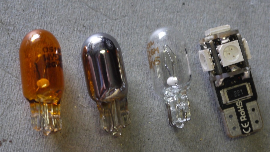

I've been too lazy and have not installed the LED's. After reading your post I figure I should put them to good use. So with the fishline method, I was able to pull the markers off with ease. And I actually spent some time with my infrared thermometer to see how hot each bulbs get.
From left to right:
aftermarket amber bulb: 230F
aftermarket silver coated amber bulb: 279F
stock clear bulb: 150F
SuperBrightLED.com's LED: 197F
Measurement were taken outside the housing after leaving the bulbs on for a few minutes until the temperature settles.
So the silver coated amber bulb melted my housing after one evening of driving, kinda expected at 279F degrees. I was a little surprised at the LED's being 197F degrees.
The LED's have these nice amber tone that's pleasant to look at. I went ahead and left the LED's in the housing and will be driving around in the next few days with them. Hopefully they will not melt my housings more than it is now!

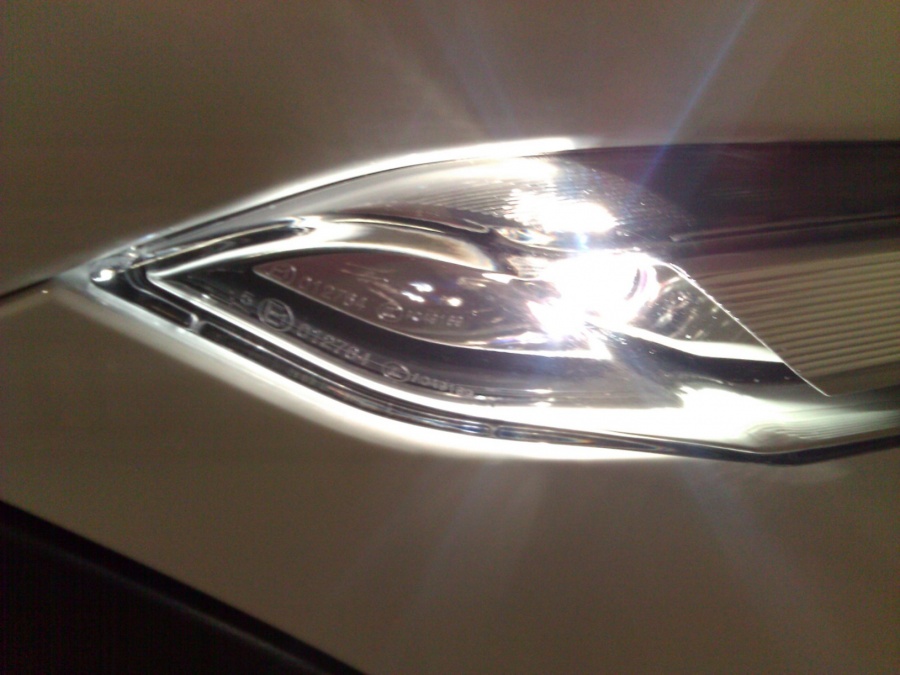

Here is a good place to order white LEDs for your clear turn signals:
http://aznoptics.com/index.php?main_...&products_id=8
$19 for a set - very quick delivery. Used them on three cars now, no problems, very pleased with the clean look.
Forgot to mention that the color temperature of these LEDs match the color of the day time running light and front markers
