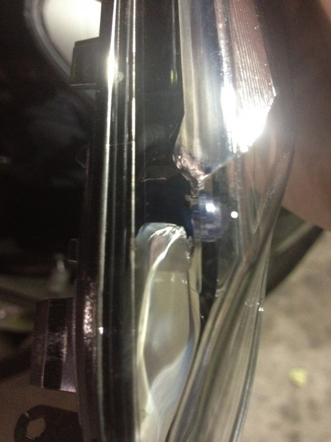

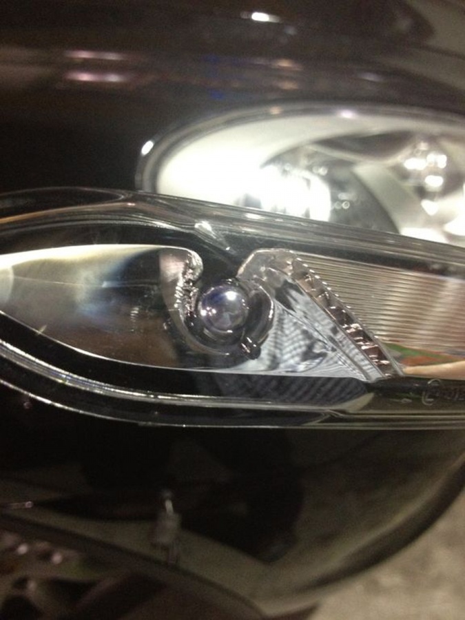

What kinda of light bulbs you guys use with the clear sidemarkers?? I have tried couple different clear bulbs but they all got over heated and melted the surrounding of the housing. I was thinking about LED bulbs but it might look weird from outside. Any suggestion??

dimseem: how many watts are those bulbs? I am running similar bulbs for about 2 months and haven't seen anything unusual yet, but the light seems darker than stock so I was wondering if I had lower wattage compared to yours. I think mine are 5 watts.

The OEM bulbs for the amber side markers are clear. They should be 5 Watts. Check the wattage of the bulbs you've been using. Here are some options.

Here's what I've been using for the past year and a half or so... You don't see the Amber when not in use, but they light up Amber. Definitely 5W.

I put in led's. Make sure if you do you need the ones with several LEDs and the insert part looks like a microchip board. If you put a regular led bulb you will get an error light on the dash even tho it still lights up. I learned the hard way

I am not too sure about the wattage. I got the bulbs from Solaris InvisiBulbs. I bet they are over 5 watts.

I shouldn't say Clear bulb. What I meant was Xenon white bulb. Thx for the suggestion anyway.

I think this is the way to go!! I'll check them out!! Thanks!
