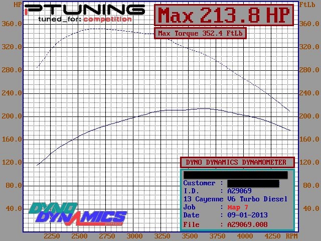

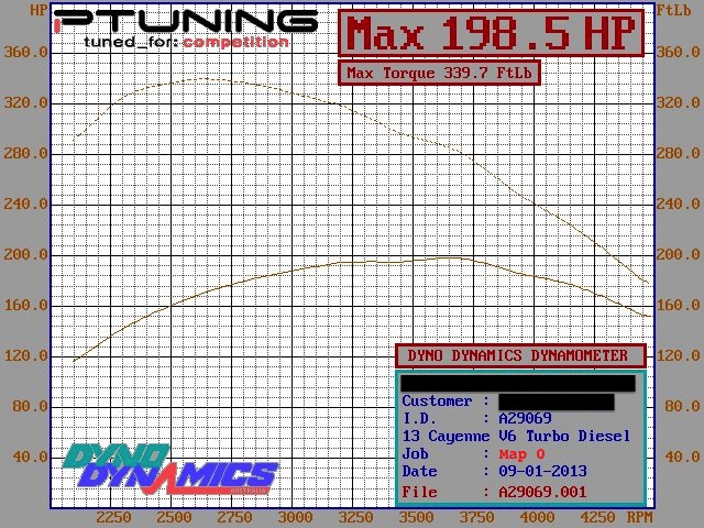

Now with Dyno results!
As promised, here are the graphs. These are the individuals so each is easier to read, I've asked for the all-in-one graph as well and will post it so you can visually see how close they are to one another.
The particulars are:
  1. It was a Dyno Dynamics dyno.
  2. I was the one that adjusted the BlueSpark between runs. Yes the unit power cycled between runs (took it's damn time too).
  3. The readings were taken in 6th gear.
  4. No cetane boosters were used and all I have around here is plain old 40.
  5. The drivetrain loss is depressing
According to the Map 0 run it appears that there is a 17-18% margin from the factory numbers which will mostly be due to drivetrain loss, but also will be impacted by the accuracy of the dyno and the gas quality.
  • Map 0 = 198.5/339.7
  • Map 6 = 212.7/354.3
  • Map 7 = 213.8/352.4
  • Map 8 = 211.5/352.9
  • Map 9 = 212.2/356.6
I'm shocked how little difference there is after the 0-6 jump. I feel a large difference between 6 and 9 and I find it hard to believe that only 2 foot pounds makes that much of a feeling difference.
I'll analyse the numbers in a bit more detail later if someone doesn't beat me to it, but I've been looking at numbers all day and am tired of them right now
Let the discussions commence!
