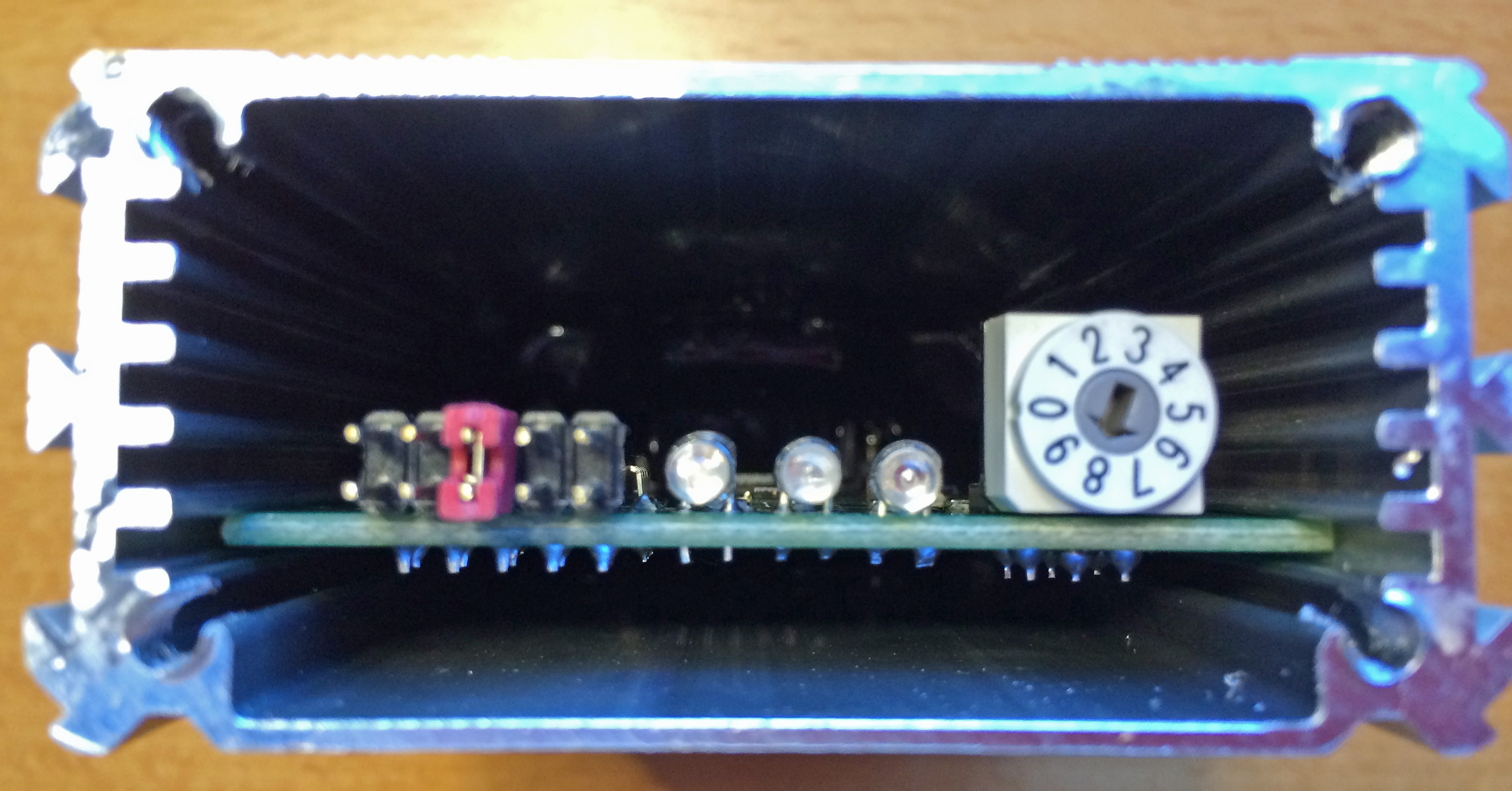

BlueSpark v2
Based on the feedback on this forum I ordered up a BlueSpark Pro + Boost Control for my 2014 CD. The unit arrived in California just 5 days after being ordered. The design has been updated, see attached photo.
Jason of BS described the changes as follows: "We have actually updated the hardware to be more robust and also changed the adjustments to be easier to use. As confusing as it sounds the adjustments are the other way round. The 0-9 dial now takes the effect of the rotary blue adjuster because it is easier to set than the blue screw with limited markings. The 0-9 map selector is now changed to the jumpers 1-5 as this is plenty of maps for most people because on the old box most people tended to use maps 5-9 only anyway."
Based on that I've set the jumper to the middle (i.e. old 7) position, and the rotary dial to 8. Should get it in stalled this weekend.

The 3 LEDs are interesting to me as mine only has one. Any info on what their significance is?

I've attached the updated doc.
"When the device has been fitted, turn the ignition key to the ON position, but do not start the engine. There should be a Blue light on the back of the unit which is now flashing. Once the engine is started the Blue light will turn steady. TheGreen and Red lights will flash in accordance with rpm when the engine is revved."
Because you can see all that from the driver seat with the unit under the bonnet? Seems kinda silly when the blinking vs solid blue single LED works just fine...
