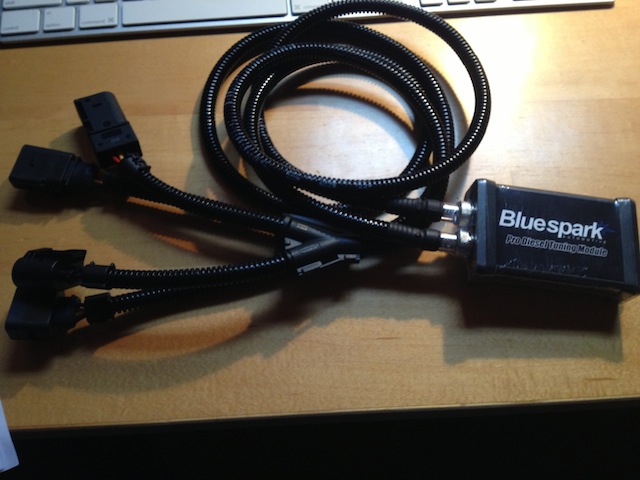

The unit:

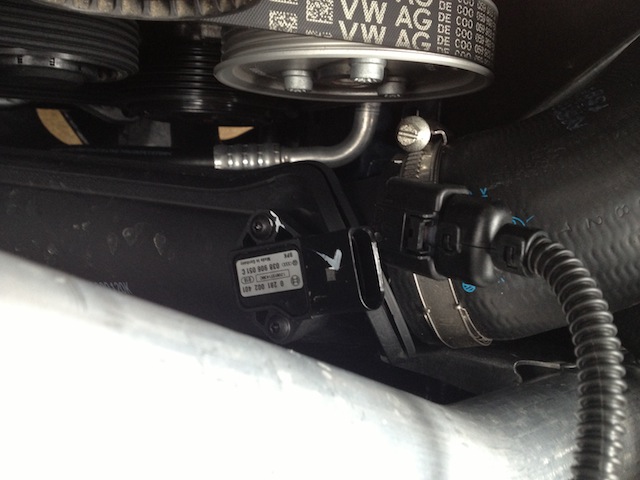

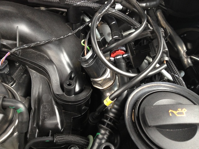

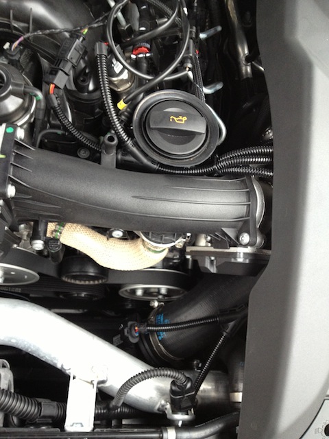

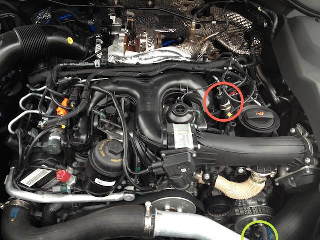

As Greg previously noted, the installation was exceedingly simple and I spent far more time deciding how to route the cables and where to store the unit itself.

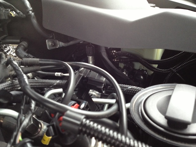

Taking the engine cover off was simply pulling up on it at the front and back corners. It's attached by some rubber grommets that pop over 4 posts with ball ends. As Greg pointed out when I asked him, one of the grommets came off in the process, but I was lucky it stayed stuck on the post rather than falling down inside. Definitely something to watch out for. Here is a pic of the engine with the cover off. The red circle is around the fuel rail plug which is exactly where the directions say it is for the newer engine. The green circle is the boost sensor which was a bit more difficult to find as they don't include an actual picture of the new engine and the part number they list appears to be an older P/N.
Unit plugged in and routed. I stuck it in the empty cavity over the front left suspension where it seems to sit pretty good without any tie downs. Once I get it dialed in I'll probably tie it down though.

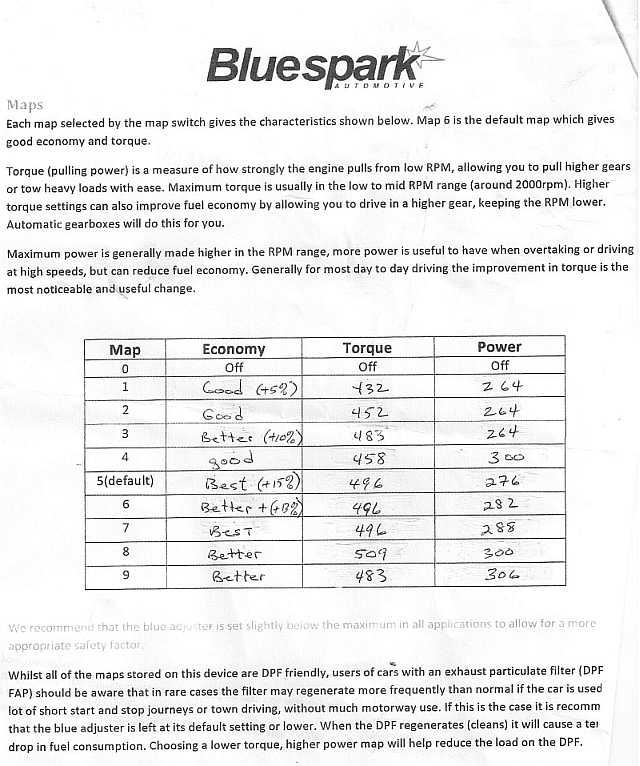

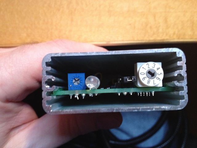

As shown above the default setting for mine was 6. I took it out for a spin and honestly can't say I noticed anything. I dropped it to 1 and 2, but also did not notice anything significant. My last test for now was at 9 and that is where all the torque seems to be. Greg reported some "flat spots" on the highest torque setting, but if 9 is it I didn't notice that during my short test. What I did notice, however, on that setting is that it clearly sounds more like a diesel during the middle of the RPM range.

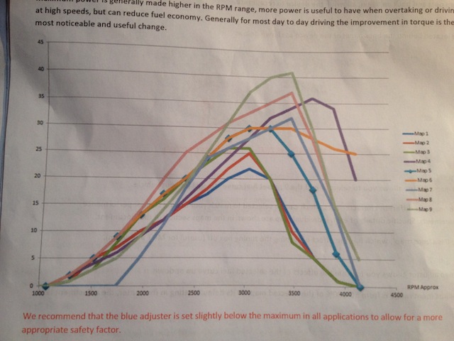

Here is their graph for the maps, but unfortunately it doesn't mean anything to me since they don't include a 0 line so you can see how it all compares to the factory setting.

My main issue was a lack of understanding what the graph is trying to tell me and how it relates to the factory setting. Apparently I'm not alone as he said that was a common question (fix your documentation maybe?).
The key point of missing information is that the Y axis is the percentage gain over the stock config which explains why there is no line for Map 0.
The other piece of useful information is that the sooner the line rises, the more low end torque is available and the longer tail provides more HP. So based on that Map 8 would be the best low end setting (which as I understand it would also be the best MPG too), 4 would provide the most HP gain, and 6 (the default) is probably the best middle of the road. Of course that's all by the numbers. I suspect I'll settle on either 8 or 6.
Now that I understand it better I can hopefully get a better feel for it, but it does help explain what I've experienced so far (1,2 = meh. 6 = I think something's going on, but not sure. 9 = holy crap that was a kick).
Another useful bit I got from talking to them is that you can change the map setting while the unit is on, it just has no effect until it power cycles (I found that it would stay on for a minute or so after the engine was turned off).

I too took exception to the lack of specifics about each map setting. When discussing it with BlueSpark, I was promised an engine-specific set of curves illustrating each map. So far they don't seem to have gotten past the colored graph you describe. That one seems to be some kind of hybrid representation of torque + horsepower across the rev band. I prodded them again last week, but now understand why they've not yet responded. In the absence of meaningful data from BlueSpark, I used the original chart to extrapolate my own engine-specific numbers. See attachment.
Lacking similar graphs from BlueSpark for the various mapping selections, the best I could do myself was a numerical chart of the respective peaks. All chart values assume power control (blue adjuster) is fully clockwise (100%). I also followed the instructions to back the power adjuster off slightly, but it's got a very narrow adjustment range. I tried to guess, and hope mine has been backed off to about 95% or so.

I tried Maps 9 and 8, and found them inconsistent once I had my right foot firmly planted on the floor. I'm now using Map 7 to take advantage of the highest torque/hp combo that gets the best fuel economy. Flatter response than 8 and 9 as well. Horsepower is actually of the least import to me, as it doesn't peak until well after torque has already fallen off. This Porsche graph illustrates the factory default torque and HP curves of our US-spec engine. You can clearly see the 1000 rpm gap where torque falls off rapidly from 2750 while horsepower eventually peaks at 3750. Pretty sure that explains some of the Map 8 lags I experienced full throttle.
Lacking similar graphs from BlueSpark for the various mapping selections, the best I could do myself was a numerical chart of the respective peaks. It's now been edited into my previous post. All chart values assume power control (blue adjuster) is fully clockwise (100%). I also followed the instructions to back the power adjuster off slightly, but it's got a very narrow adjustment range. I tried to guess, and hope mine has been backed off to about 95% or so.

Comparing your colored graph to my home grown chart, I noticed that the orange line seems to indicate Map 6 as producing the flattest hybrid curve. Interesting. I'll be road testing that one down the line as well.
