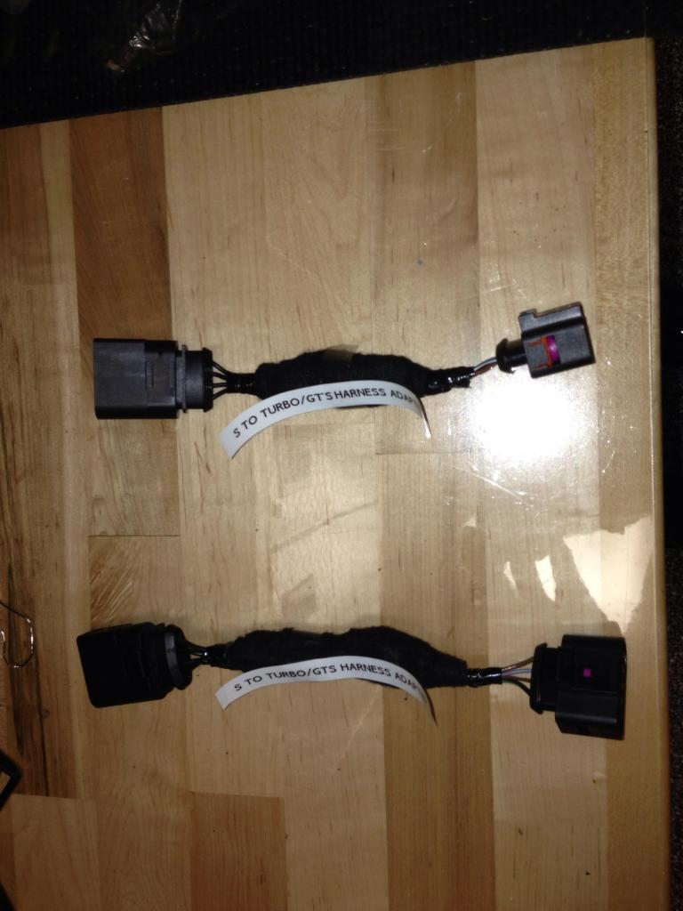

Yes. That's right. I have the GTS/Turbo headlights installed in my S now. I did the GTS/Turbo bumper and sport design kit install and wired up the LED bar in the bumper to act as the DRLs. Since they aren't very bright I have both the DRLs in the headlights and the LED bar working at the same time.
It's not that impossible. In fact, you could get the both the S DRL bar and the headlight DRL working at the same time as well even the the S DRL bar draws more current than the turbo LED bar. I tested it in my car and it worked. I think the threshold for any codes is set at about 2X of the current draw of the DRL. You could build a harness and make an adaptor that doesn't require any splicing at all. I decided to just populate the empty slots in the headlight harness with the two pins needed for the DRLs in the headlights. I didn't get the dealership to do. I did it myself. I'll post a schematic for this mod.

Typically you lose the DRLs with this swap because of the DRLs being integrated in the headlights for the GTS and Turbo. I made a little harness adapter that allows the LED bar in the GTS/Turbo bumper to double as both the parking lights and DRLs without any ECU warnings. I can still disable the DRLs if I want from the PCM.
I've attached the schematic for the custom harness.
How long did it take you to do the bumper swap?Originally Posted by snp_cayenne
Just did a GTS/Turbo bumper swap on my 2013 Cayenne S. Turned out great! Typically you lose the DRLs with this swap because of the DRLs being integrated in the headlights for the GTS and Turbo. I made a little harness adapter that allows the LED bar in the GTS/Turbo bumper to double as both the parking lights and DRLs without any ECU warnings. I can still disable the DRLs if I want from the PCM.

gnat is selling these using the design I came up with. they are the same and he should be able to give you more info.Originally Posted by Gene Culley
