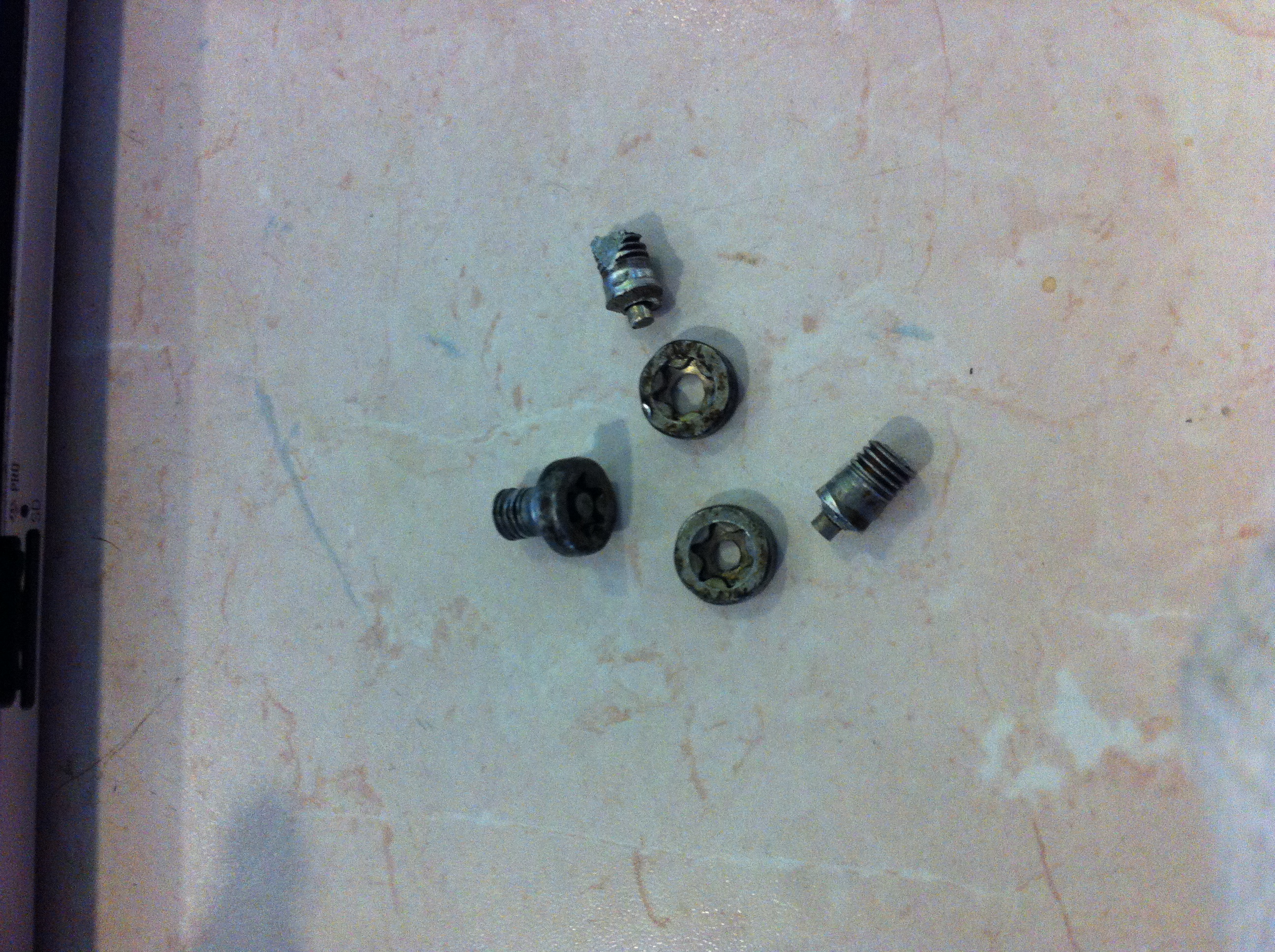

Hello All
I have the same problem last week on the highway Cayenne S 2011
I open a Bank 2 Cover and i found 3 bolt fallen and the 4th is missing
I am not sure now maybe i bent valve too ..
What should i do now Any advance please
Thank you

Leakdown
Originally Posted by boxs1
Hello All
Thank you
First thing you need to is a leak down test and go from there
How is a leak-down test going to be done if one camshaft isn't turning?

Leak down test
You need to move the camshaft by hand to make sure the valves are closed then bring the piston to the top and test
The problem here is - the camshaft MUST be moved in sync with the pistons rising and falling in the bores, or you WILL end up with bent valves due to the another cylinder having the cam-lobes in the exhaust position (fully open) as the piston in that cylinder rises.
It's an easy test to do IF the camshafts are turning as they should, and near impossible to do if they aren't.
