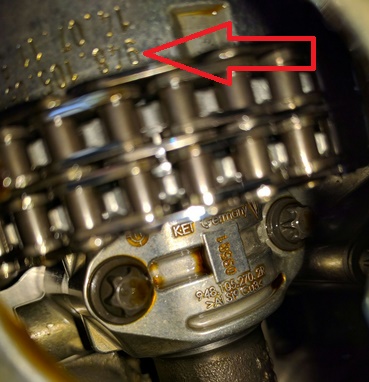

Double checked on which part I have installed and it looks like my car is also affected by this.
My part number - 948 105 051 21 ; replacement part number is 948 105 051 ( 23 )

It looks like my part number is 948 105 270 2R
Or did I take a completely wrong part picture?
Edit - NM, realized it's the wrong part in the picture. I'll recheck/retake tomorrow.
Originally Posted by boxs1
Even my Vin is not issue attached but i have the defect adjusters with part number 948 105 051 21 and the new and upgrade part is with number 948 105 051 ( 23 )
You can open your tab oil and check the part number !
this one

It looks like I'll be calling the dealer on Monday about the service bulletin again.
Last two numbers show its the old part number.
