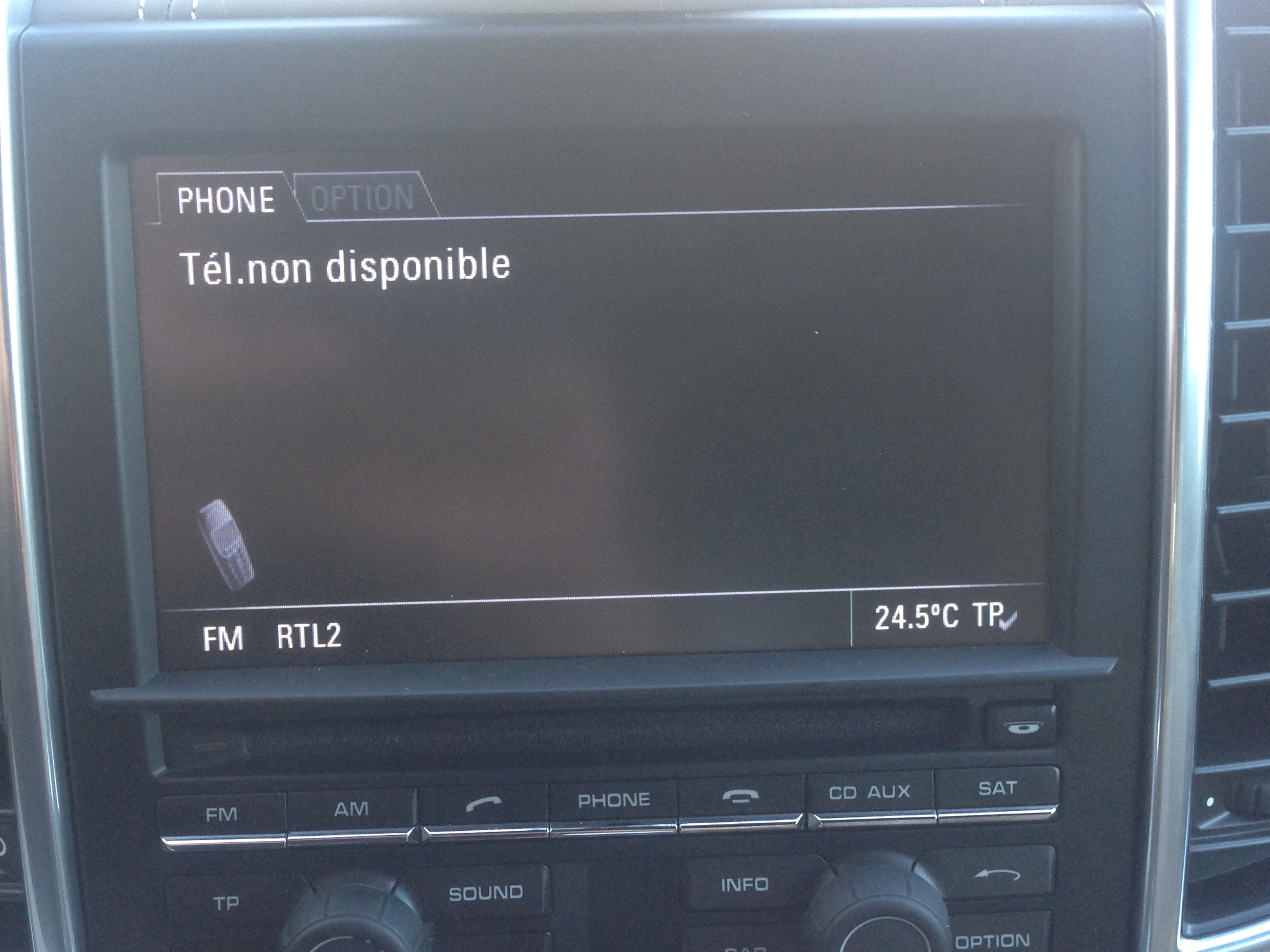

Dear G_A not sure to get all...
see my console in picture, phone buttons, phone menu but nothing to be activated...
Regarding voice features, I don't have it.
this is my VIN number, does it help you to get my situation?
VIN:WP1ZZZ92ZCLA01419
Thanks
