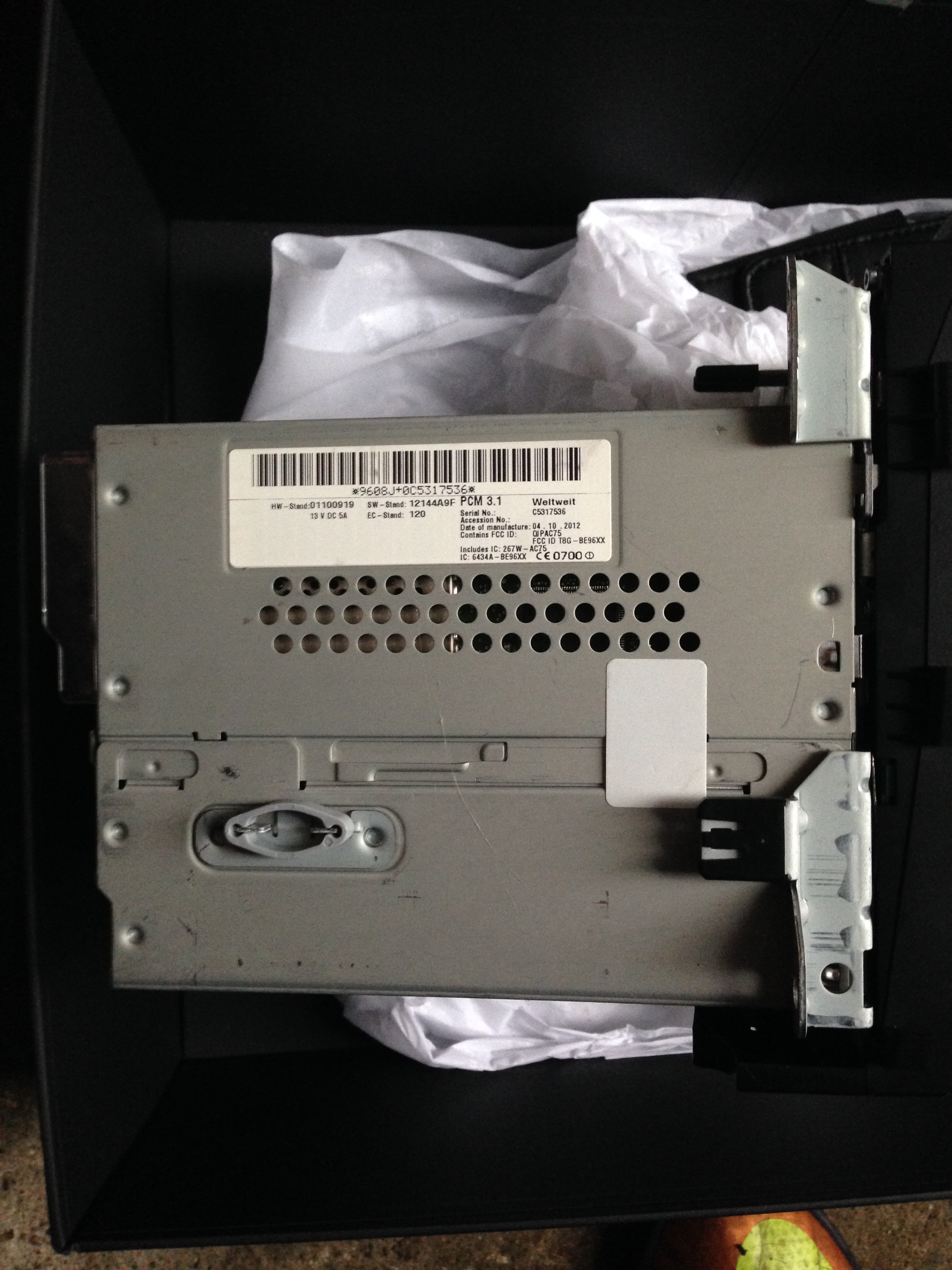

PCM 3.1 which I bought is removed from 2013 Cayenne.
made on 04.october.2012.
Part no is: 958.624.970.01
I will recieve it in 10 days.
How do you think, Will I have new functions? hdd and album art?

95862497001 - looks like wromg number
oh, it is not part number, i see.

This Pcm is made in october 2012.
They said "Jukebox is a standard feature on all Cayennes production starting Nov, 2012. We will see..
I noticed, some pcm have DISC button and some have a MEDIA button?
Mine is with MEDIA button.
Part number is not on the sticker?

Yes, this is part number.
Not exact, but it is.
suit for cars MY "C", so I do not know exactly will jukebox works or not.

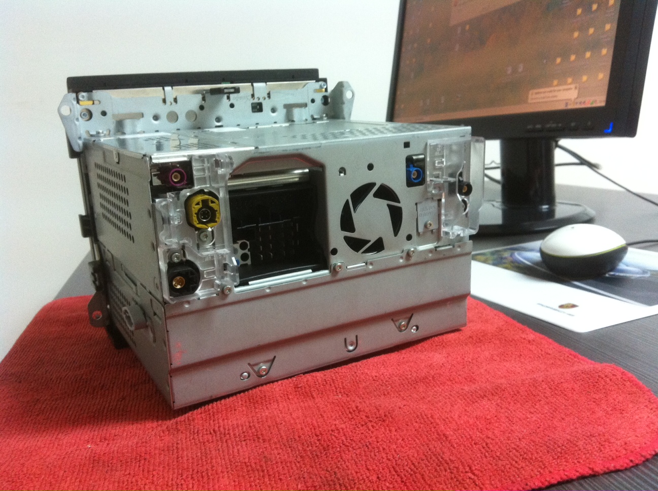

But first to finish the conversion of PCM system
PCM has finally arrived. looks great!
I'm just waiting to get the GPS antenna. I ordered on ebay 10 days ago.
wiring and apm I will order in a few days.
One question about purple connector on pcm, what is it?
