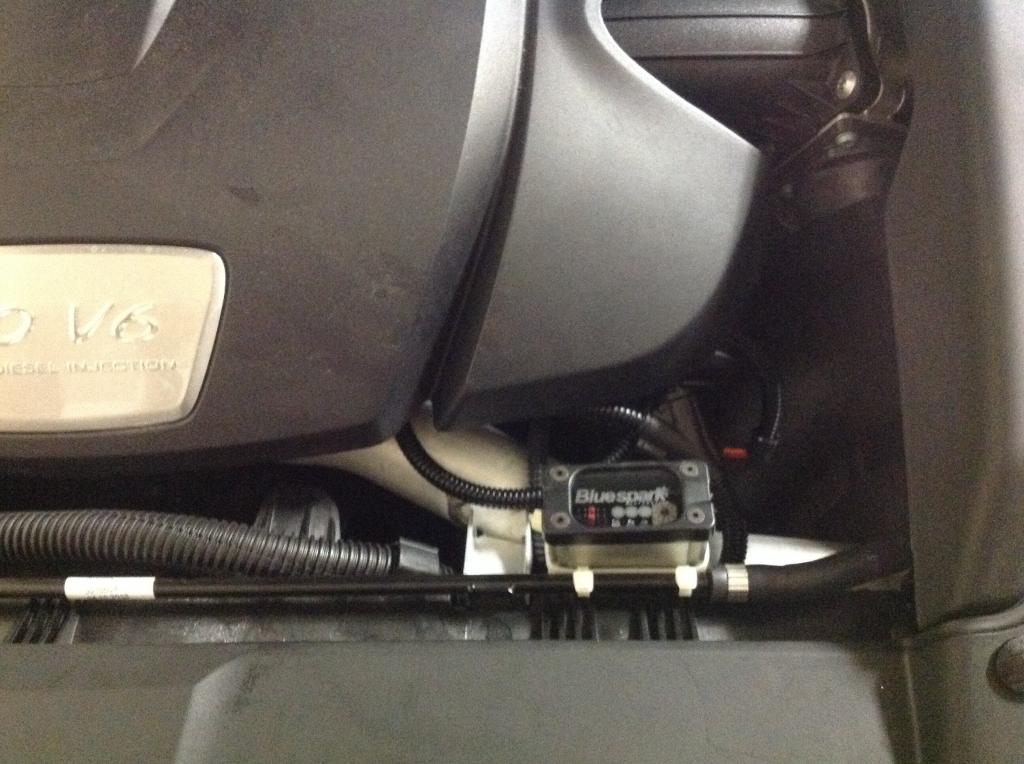

Here is how I mounted it... at least temporarily until I find the setting I want to stick with. Hook up was super easy finding a suitable mounting place took much longer. I drove to the fuel station on C5 last night and honestly couldn't tell a difference from stock. I plan to step it up and find that extra torque and HP.
