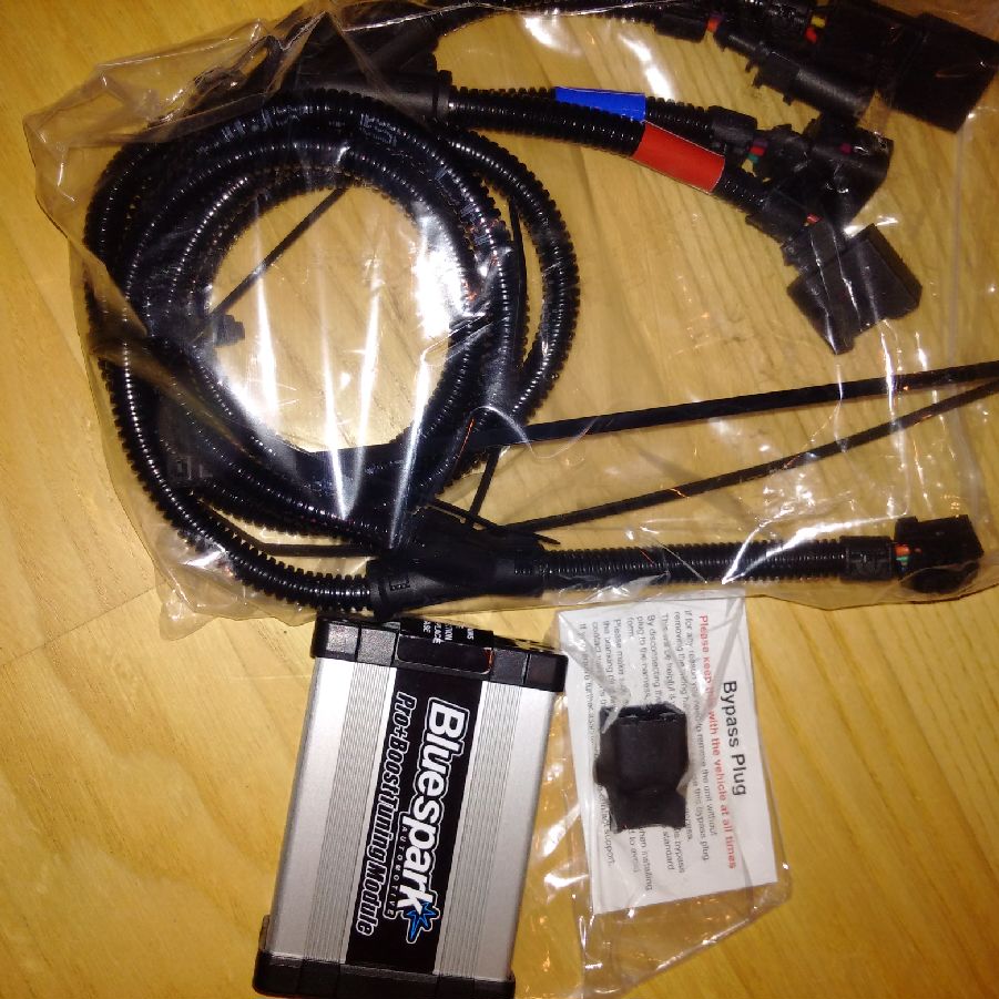

Old Oct 25, 2015 | 04:06 PM
  #86
abatis's Avatar
Joined: Mar 2014
Posts: 24
From: MT
abatis is infamous around these parts
Bluespark sent me a replacement unit. They did include a bypass plug that plugs into the wiring harness if you want to revert to stock. That beats taking the cover off if you had a problem and the weather was not nice.
