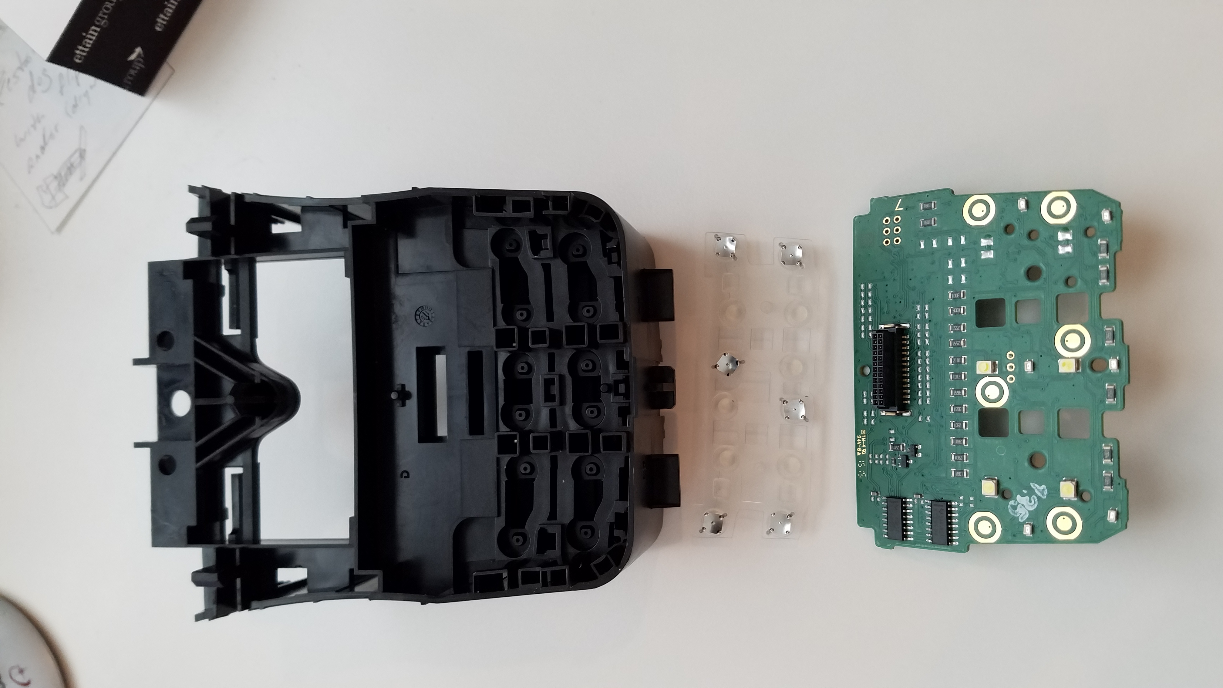

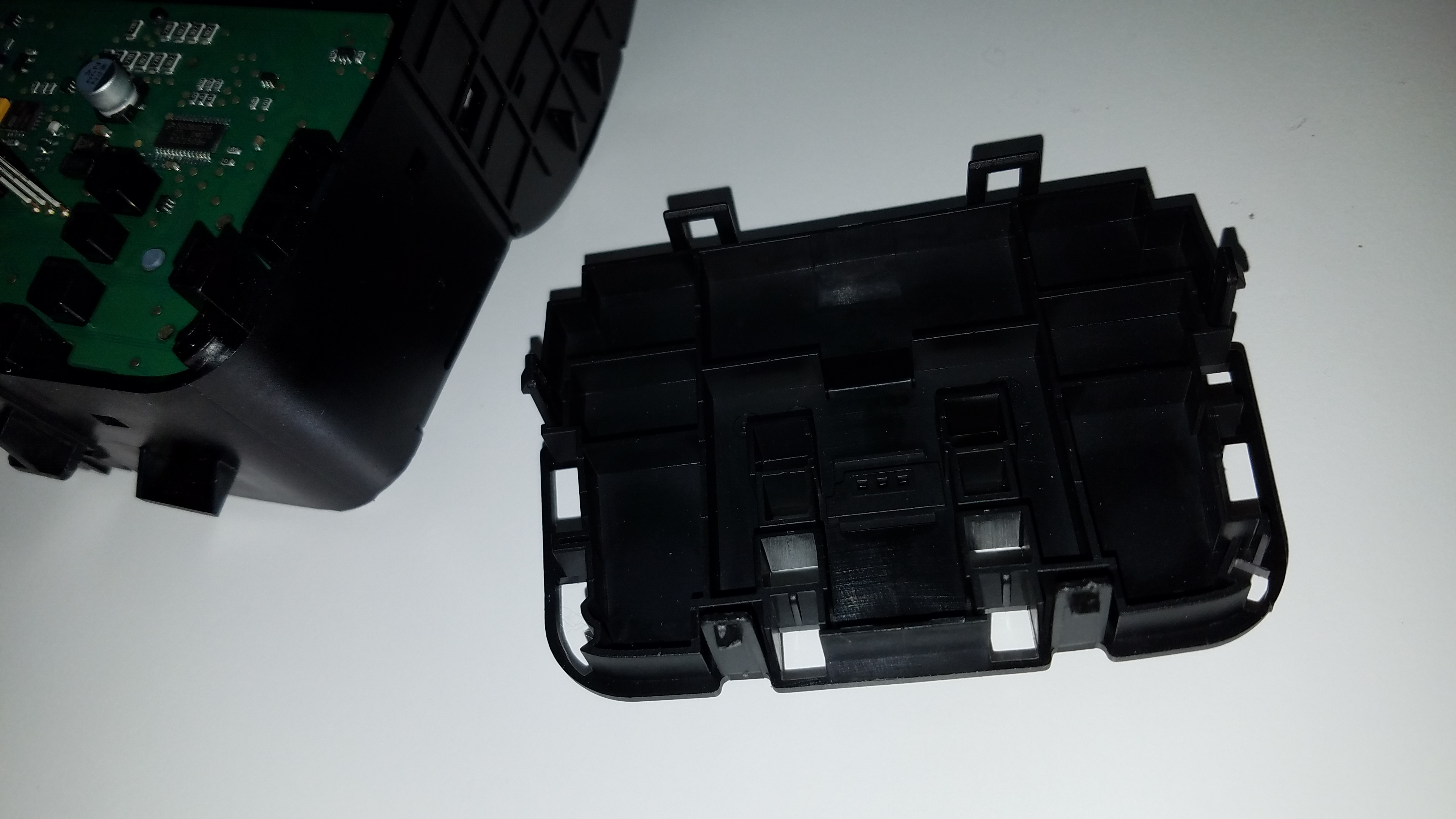

For anyone wanting to pull apart the button module, here's some pix.
Note that around the sides there are some small slots. Gently put some pressure inward in those slots to release the tabs.
Also note that all modules come with the same rubber button membrane, and appear to use the same circuit board. But the hard buttons on the top are different depending on features, and the circuit board may or may not have an LED on it depending on the button feature located at that position.
From what I understand a replacement button panel would have to be programmed specific to the features in the vehicle (while IN the vehicle). They don't come pre-programmed, nor would the control module automatically recognize the buttons on them.

I have successfully removed and reinstalled the center console buttons and, well, all of them. The folks from T-Design came out to DC and sampled the LIN bus signals my '17 958 sends for them. Now they have a memory module that'll overcome the auto stop/start 'feature' along with being able to remember sport and PSE modes.
