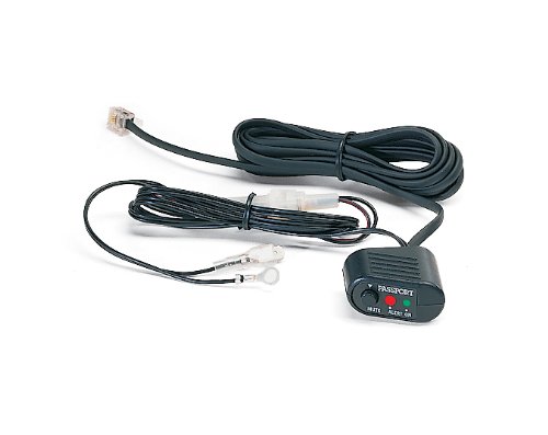

ID:	467372   Click image for larger version
Old Jan 8, 2017 | 08:04 PM
deilenberger's Avatar
Joined: Mar 2011
Posts: 1,493
From: Spring Lake, NJ, US of A
Rep Power: 126
deilenberger Is a GOD !deilenberger Is a GOD !deilenberger Is a GOD !deilenberger Is a GOD !deilenberger Is a GOD !deilenberger Is a GOD !deilenberger Is a GOD !deilenberger Is a GOD !deilenberger Is a GOD !deilenberger Is a GOD !deilenberger Is a GOD !

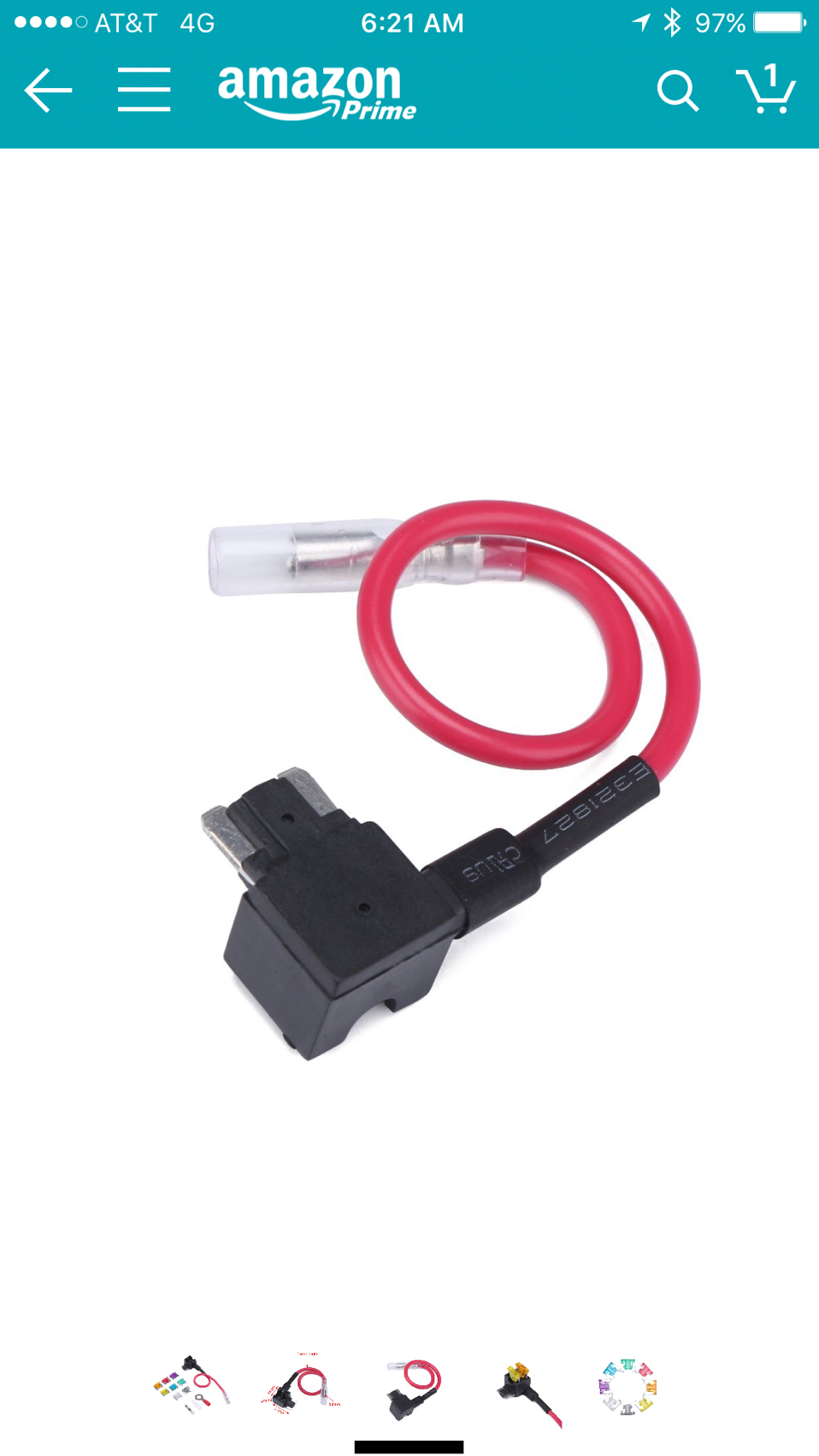

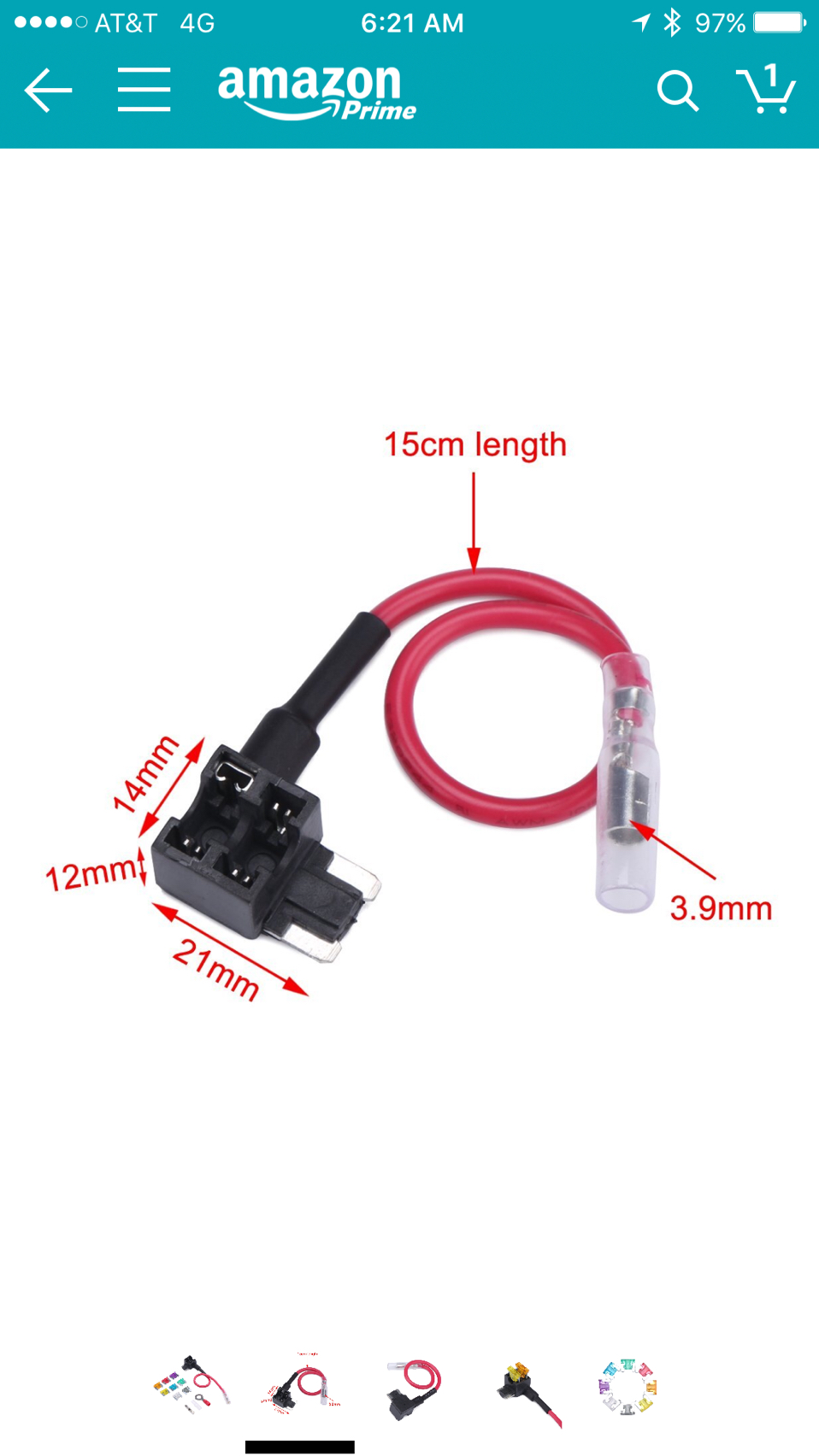

Ideally - one could purchase the connector used in the fuse box and attach a wire to it, then pick one of the empty spaces where there is a + connection already and use that space.
Unfortunately - I've never been able to located the needed connector. It should be sold as a "repair part" for the electrical system - but it would take a savvy parts guy to actually locate it. It would likely come with a pigtail wire attached already.
I thought about trying to locate a wrecked Cayenne and strip out some of the connectors from the fuse box - but when I've talked to the wrecking yards specializing in Porsche - they sound like they think I'm crazy. I've also thought it might be worth checking for a wrecked Tourag - since the bodies are both made in the same Czech factory - in the hopes the connector was used on both, but inertia of the *** has prevented that happening.
Other possibilities are a "tap a fuse" sort of thingie. http://a.co/9Lap9md - probably the easiest way. Make sure if you order this that it's for the right size spade fuse. There are several different sizes. This sort of thing is usually also available at your friendly big-box-auto-parts and chrome crappola stores.
Old Jan 8, 2017 | 08:27 PM
wkearney99's Avatar
Joined: Jul 2016
Posts: 279
From: Bethesda, MD USA
wkearney99 has a spectacular aura aboutwkearney99 has a spectacular aura about
I powered my cell phone cradle off the fuse for the mirror, in the left panel. I powered my dashcam off the same circuit as the accessory sockets, off the right panel. In both situations I used an add-a-circuit. I replaced the fuses they came with for 3A. Best to use as low a fuse rating as possible. Better to have a fuse blow than a circuit overheat and set the car on fire.
Old Jan 9, 2017 | 04:22 AM
958 S's Avatar
Joined: May 2016
Posts: 72
958 S is infamous around these parts
I have used something like these before. They allow you to not cut or splice, just be sure to use a a lot that has enough extra amp capacity. It allows you to keep your original fuse and add a second one (within reason) or you can use these in a fuse slot that is powered but not being used.
ID:	467385   Click image for larger version
Old Jan 9, 2017 | 05:03 AM
thebland's Avatar
Joined: Aug 2009
Posts: 323
From: Detroit
thebland is just really nicethebland is just really nicethebland is just really nicethebland is just really nice
Thanks all
Got it. I have many empty (and I assume powered) fuses in my left side door box - the many empty slots are for the Cayenne Hybrid. I may just plug into one of them that powers on when car is on.
Most of the empty slots (3rd row in picture above) are Cayenne Hybrid fuses - all 5 amp. I assume these will work fine?
Thanks!

And the empty slots aren't going to work if they have no connector/socket in them. SOME empty ones may have a powered feed going to them - they'll have the silver colored socket in one side of the slot. It looks from your photo as if most of those don't. And some of the slots that DO have a connector in them may be switched on with the ignition, or always on connections. I'd suspect you would want one that is switched on with the ignition.

Old Jan 9, 2017 | 11:47 AM
thebland's Avatar
Joined: Aug 2009
Posts: 323
From: Detroit
I have vented seats - and it's only 7.5 amps - compared to the 30 amp sub - I think #13 is the one.
Thanks for the help!
I'm going to use the Escort Smart Switch:
