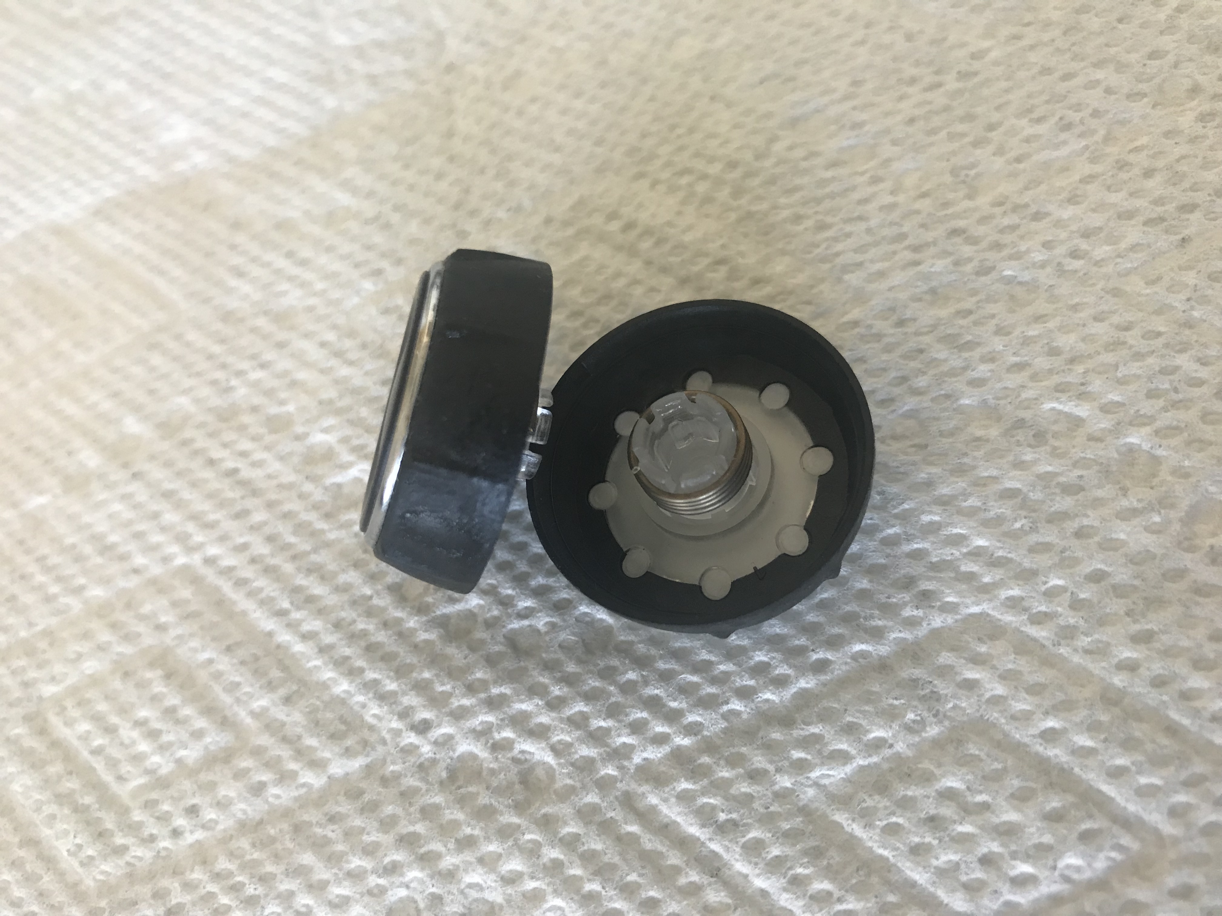

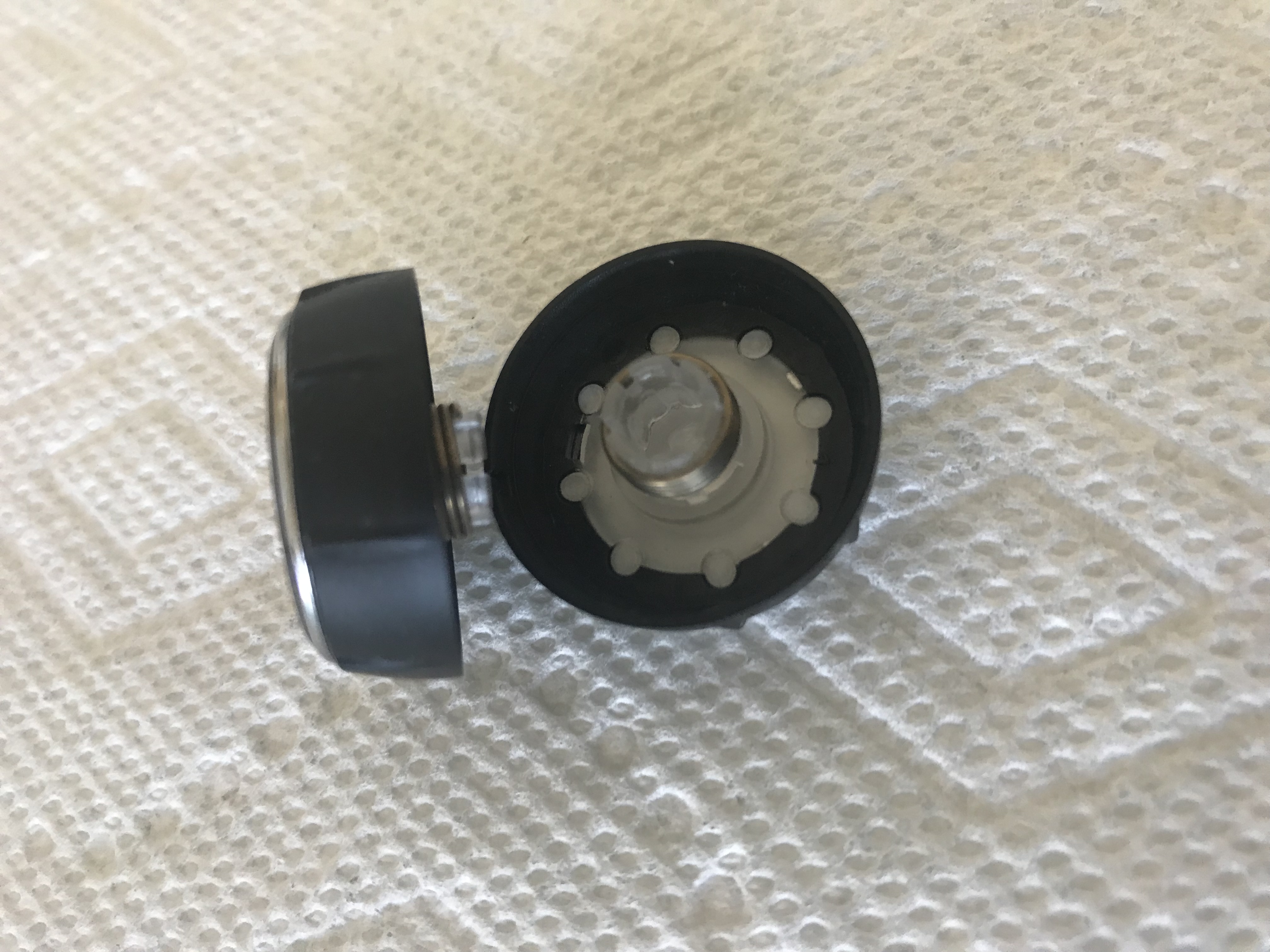

removed mine using two of those metal credit cards, one on each side. they popped off but needed good force.
the 958 I have uses springs to hold them on well as shown below
cleaned up like new with alcohol. damn sticky stuff. maybe I have to wash my hands more often?
before and after pics

Was it gunk on the ***** or is the plastic itself gumming up?
Old Dec 15, 2017 | 09:30 AM
nhirsch's Avatar
Joined: Jan 2012
Posts: 485
Rep Power: 35
nhirsch is infamous around these partsnhirsch is infamous around these parts
I don't know. Now they feel like regular plastic. If yours feel like it has some coating, then it's that coating that somehow morphed into stickyness. It was evenly sticky on both ***** all around so I suspect it was some coating that deteriorated. you could drag your fingernail across it and some of the stuff would remain under the fingernail and you could see where you had scraped it. They feel fine now and I'm pleased the way they cleaned up. It wasn't the plastic itself that deteriorated.
