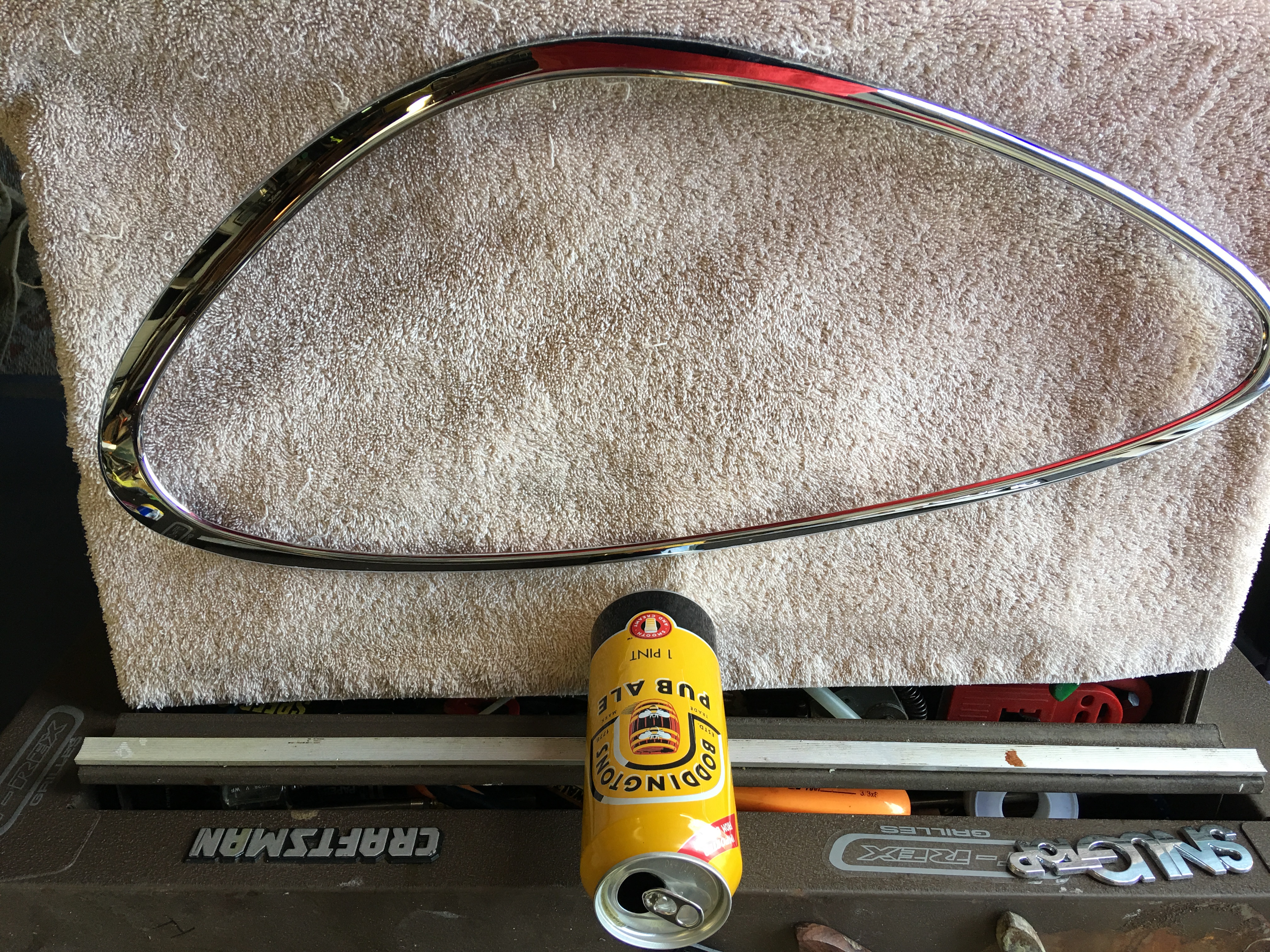

Anyone seen a DIY for making replacement headlight gaskets?
mine are brittle and gooey to the touch.
Replaced my horns this past weekend and noticed what a sad shape they were in.
Dealer says not available for this model, but available for the 2015 and up models. or the 955's

in Porsche's ultimate boner decisions, this gasket can not be replaced, it is part of the HL assy......... so my fix was these headlight rings to cover up the matreial ............

Nice work, I didn't even know that was available.
I have a few "High-Temperature Hollow Rubber Flange-Mount Seals" picked up from Mc Master-Carr.
Will attempt a repair in the next few weeks looking for something to bond the old frame to the new rubber seals, thoughts?
3M™ Scotch-Weld™ Plastic & Rubber Instant Adhesive or 3M Super Weatherstrip Adhesive.

i had them wrapped when I Blacked out the rest of the car, the are attached with a super sticky two sided tape............ my one beef is the still do not cover the black gasket material completly. Might need to run a bead around them, I was looking at the 3M sealant used to install windsheilds, should have the UV properties needed. Pictures attached.

I had some time to test fit the sample gaskets I ordered. Color a bit off
These were 1/4", I ordered some 3/16"
McMaster-Carr, High-Temperature Hollow Rubber Flange-Mount Seals, Temp range -100°-480° PN#1129A978
These bulge a bit on the top
east fit with a hole punch no adheasive
What great quality
