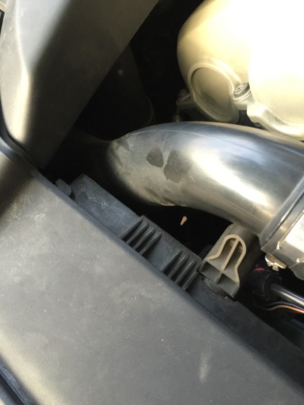

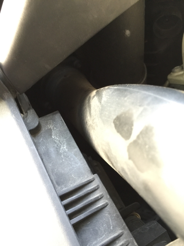

and here are the pictures as promised
Oh and in the pictures the plenum is not secured in place, check the screws. That is a tricky part that took me 1+ hour because one screw fell through the engine and I had to loosen 3 screws on the skid plate to put my hand through and get it.
The new 82mm Plenum is longer and stickes further out as you can see.

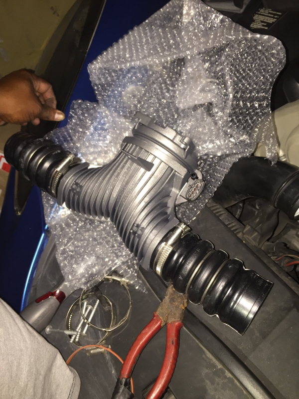

Yes but minor stuff not to be worried.. My new turbo s plenum is the one from the 957 turbo s. Here it is finally assembled.
Plenum part number: 955 110 046 60
