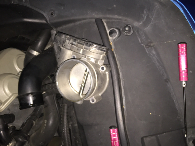

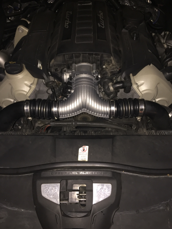

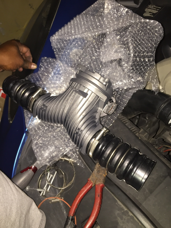

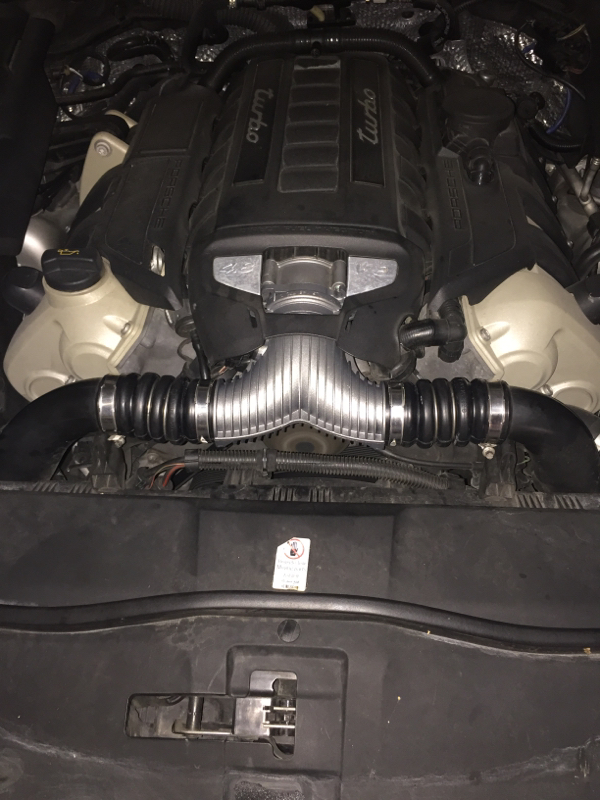

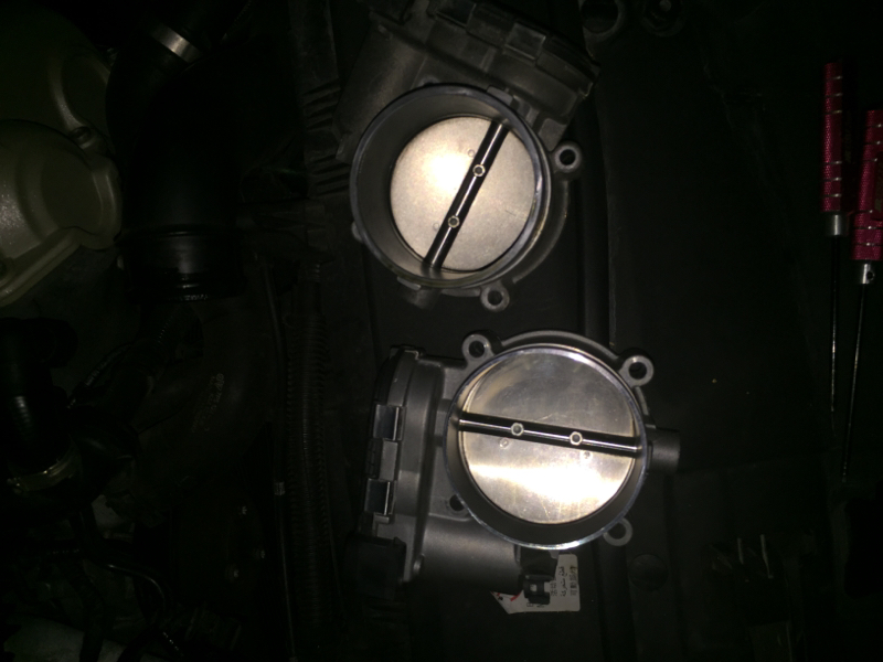

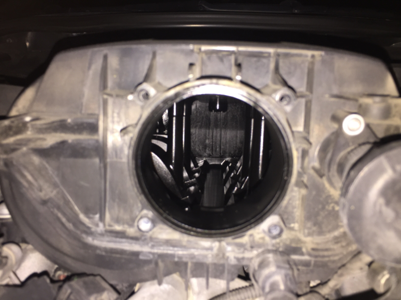

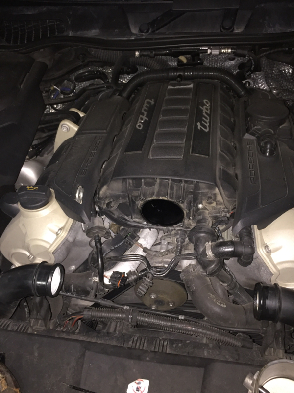

Originally Posted by amablemiguel
and here are the pictures as promised
Oh and in the pictures the plenum is not secured in place, check the screws. That is a tricky part that took me 1+ hour because one screw fell through the engine and I had to loosen 3 screws on the skid plate to put my hand through and get it.
The new 82mm Plenum is longer and stickes further out as you can see.
Attachment 431201
Attachment 431202
Attachment 431203
Attachment 431204
Attachment 431205
Attachment 431206
Attachment 431207
Attachment 431208

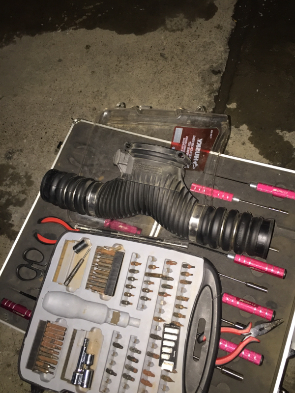

My old Ypipe, had two bolts on the side to fix it to the throttle body.
The Y-Pipe I bought from you does not have two bolts on the side
left: black old
right: grey new
It seems you must connect the y-pipe directly with the throttle body into the manifold.
That is why I think I need longer/different bolts.
I saw a picture online showing bolts connecting all here:
It must be longer than the bolt that I have.
The bolt I have now is this
