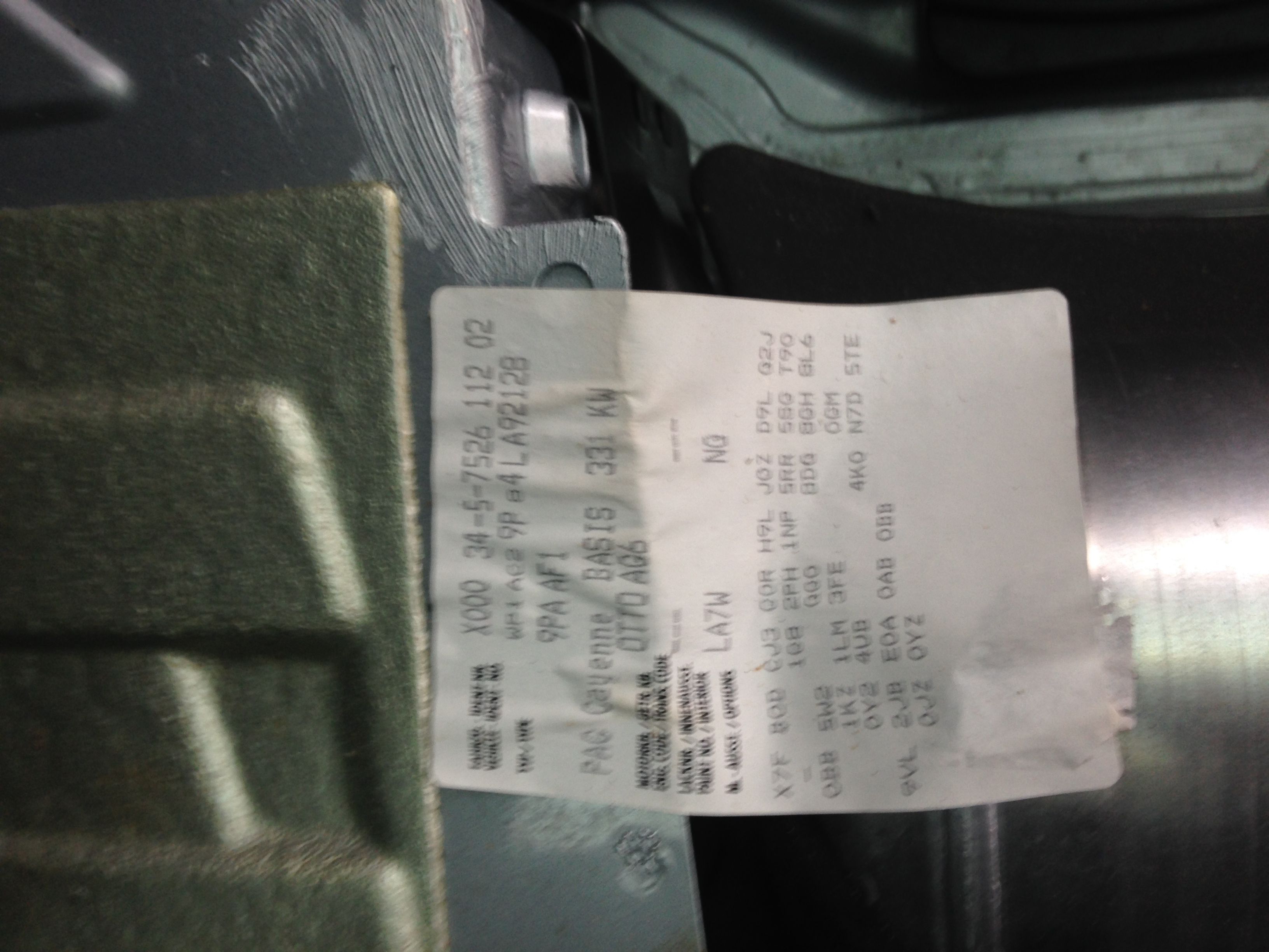

Soooo.. On to my first forum question. In everything I have read, I can't seem to find the details of what the 04 Turbo S offered that the standard turbo didn't. Can anyone enlighten me?? I think I heard the intercoolers were bigger and the suspension was different but it's tough to search on "S" in the forums.

Congrats. Great cars. On your question about the 04 Turbo S vs 04 Turbo. THere was no turbo S in 04. That didn't show up till 06. Some people have gotten the S decal and added it afterward. There was an E81 kit that could be ordered before turbo S showed up that had many of the parts that the Turbo S came with.
The Performance Kit includes:
- new charge air cooler with increased cross section, modified supply and ventilation guides
- reinforced spring struts (air shocks), larger brake discs and brake calipers
- reinforced tie rods as well as improved rubber mounting on the control arms
- new level control unit
- modified map for DME control module

Lift up your rear cover where the subwoofer and tire goop is and you should see a sticker from the factory showing all your options! Look for the E81 to see if you have the power kit! You can also check and see if you have the BBK on the front as well! The inter-cooloers on the E81 kit will be silver with metal end tanks! If they are black with plastic you just have the regular CTT. No biggie either way especially if you are doing some mods. I would do secondary cat bypass pipes, exhaust, and a good tune! Let us know what you find out!

Thanks for the great info! My friend didn't tell me it was an S but we didn't talk about it either.
I do remember that they had an incident when they left the rear hatch open and closed the garage door. He probably bought the new letters and put them all on. I have seen the kits come with the S and the Turbo.
I am totally in love with the truck and I know that it will only get better. I have to see about the options. I doubt it has too many add on goodies from the factory.
I took a picture of what I think is the label. Not sure though.

Congratulations on the purchase and welcome to the 6speed Post up some pictures when you get a chance and take a better picture of the tag. Hard to see, it might be my eyes though.

Standard intercoolers didn't change from '04-'06. The easiest way to tell if you have the Turbo Power Kit is to see if you have 2-piece front rotors.
