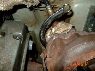

The best answer here is a combination of a ratcheting 13mm flex head wrench:
AND a ratcheting half moon 13mm wrench to give you the extra clearance to turn the nut around the pipe
Wow, I didn't even know those tools existed...knowledge is power .
I will go to sears this week and try again with both! Thank you!

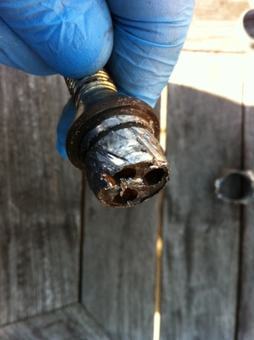

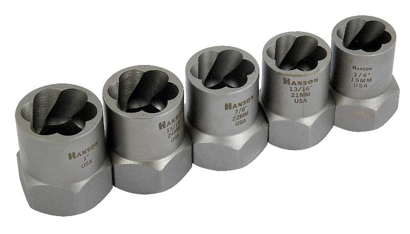

Also, if you have the space, buy a set of Irwin nut extractors. They are made to "cut" into rounded nuts for removal in these types of situations

oh man^ thats a do work bolt head lol
hahaha.. seriously. +1....
