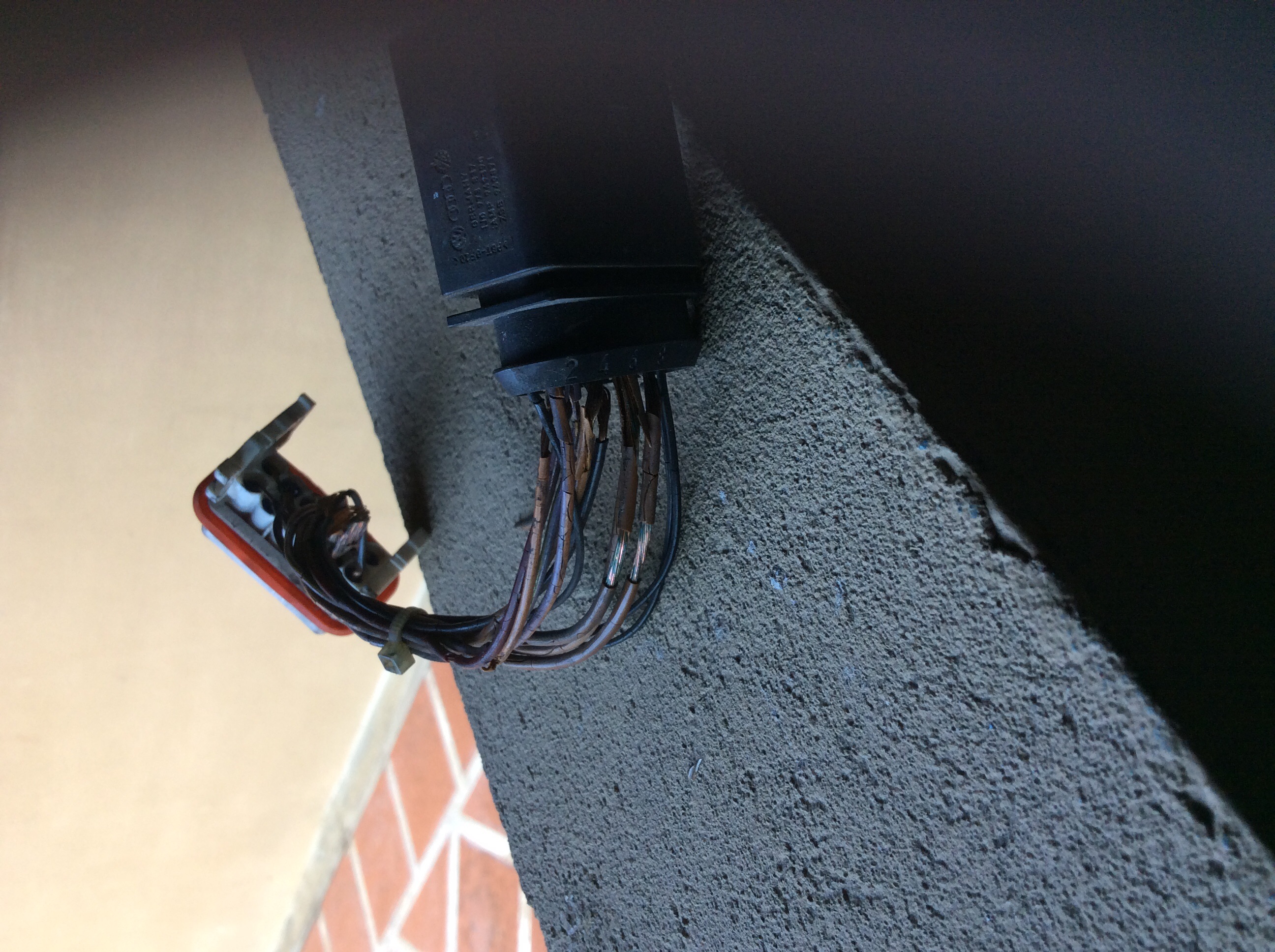

Man I just had the same thing happen last week to me. I thought it was the bulb at first. I started by removing the head lamp unit and found the problem right away. It was all the wires in the harness where bare as the plastic has come off.
It's an easy fix and the dealer down here in Costa Rica had them in stock for $100 each. I replaced them along with the fuse and wala all back to normal.

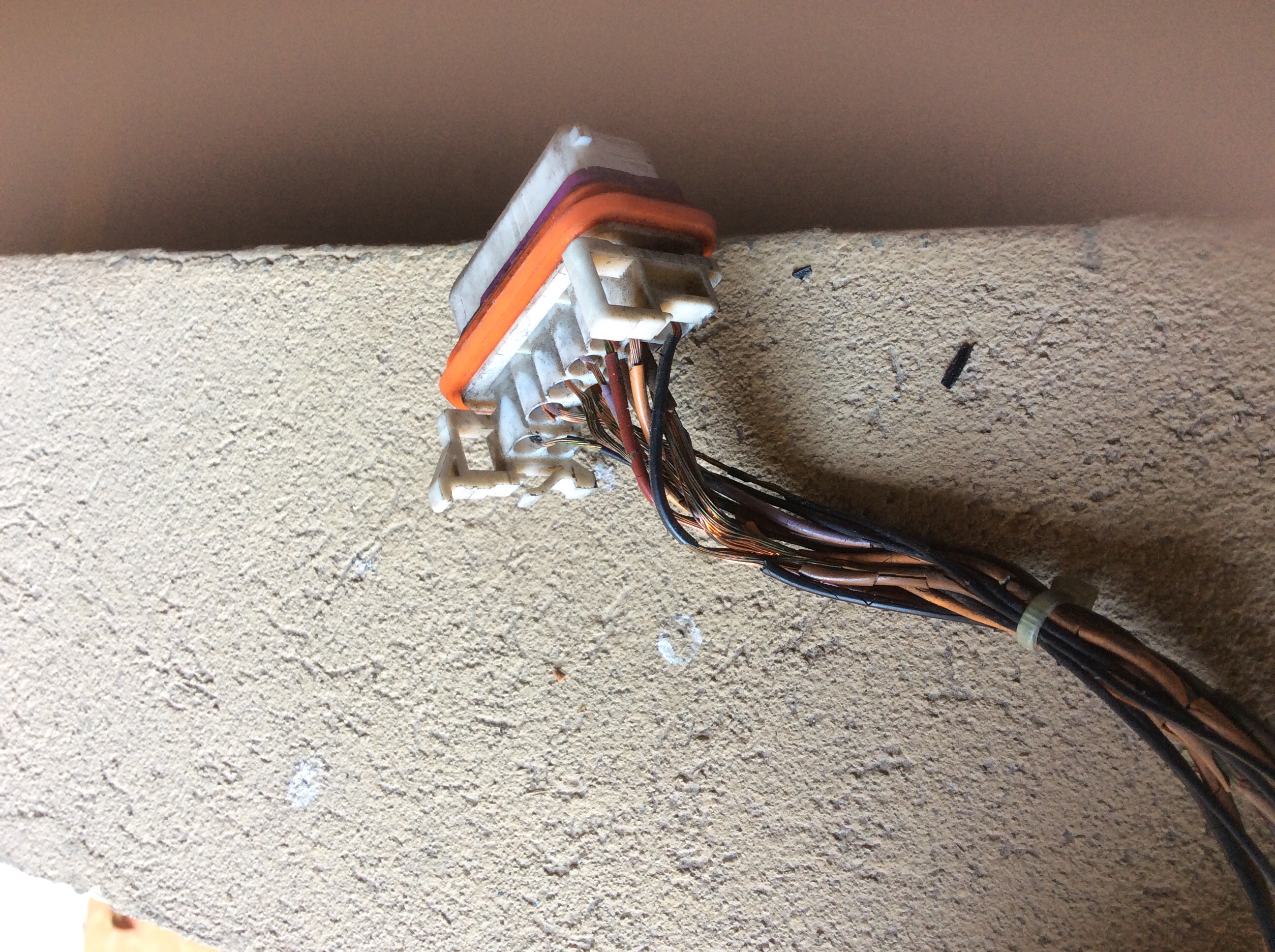

1 more pic

BG 305 , many thanks , what did the dealer actually replace , was it the wiring harness and not the lighting cassette ?

It's realli easy to take the lamp assembly out of the car as it is a 1 turn nut and it pops out. That pic is the wiring harness that feeds the entire lamp so if your wires where peeling like mine there is a good chance that they fused together. I would take out the lamp and check this first then check inside the lamp housing. The dealer just replace that wiring harness that feeds the entire head lamp.
