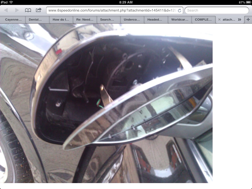

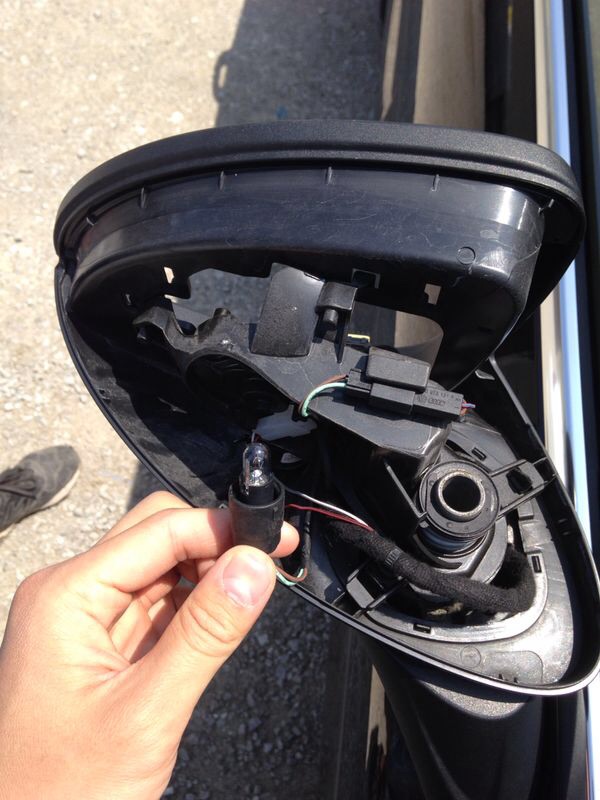

I changed mine to LED. It is a bit tricky but it can be done. First you need to pry off the mirror glass, and next thing is to remove the mirror motor, then you need to remove the body-color housing. At this point you can pull out the bulb socket.
Old Feb 3, 2015 | 06:23 PM
TGED's Avatar
Joined: Oct 2011
Posts: 773
From: Toronto
Rep Power: 45
TGED is infamous around these parts
See pic.
File Type: jpg
Old Feb 3, 2015 | 06:28 PM
TGED's Avatar
Joined: Oct 2011
Posts: 773
From: Toronto
Rep Power: 45
Bulb socket is pulled off.
