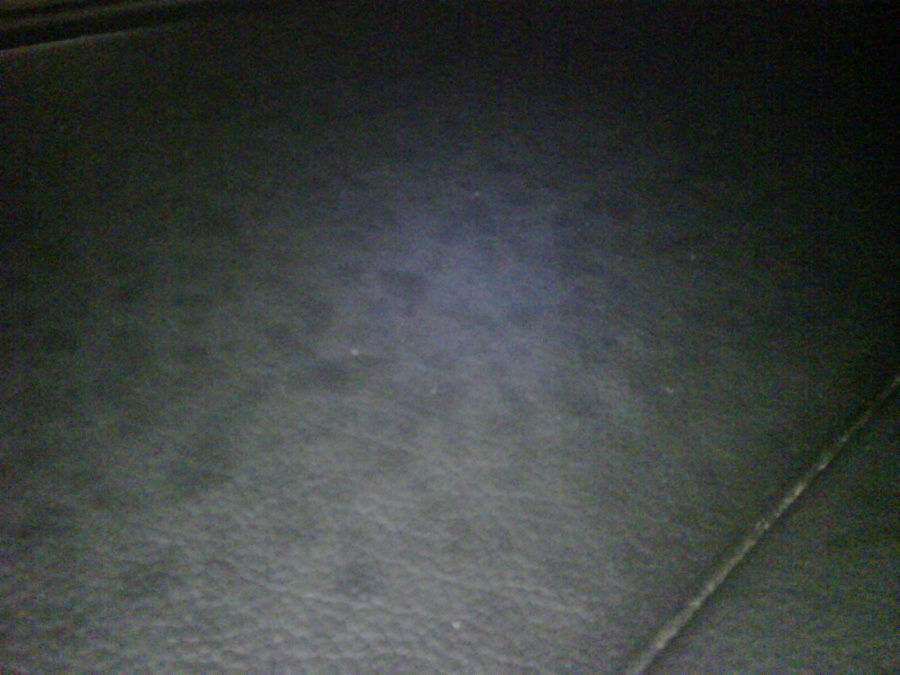

Can you post some pictures?

Not the best pictures (camera phone), but you get the idea...
Thanks for helping.

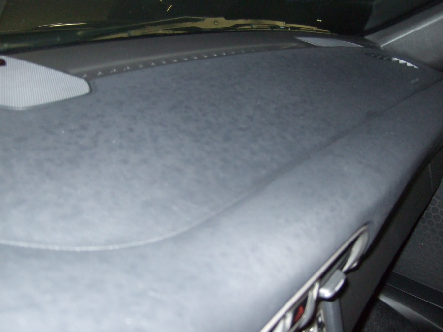

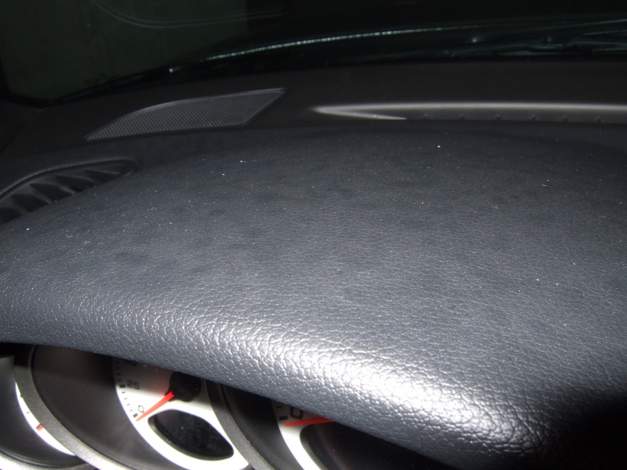

The pictures look too close...can you pan out a bit.
Old Oct 7, 2009 | 11:51 PM
xbar's Avatar
Joined: Mar 2009
Posts: 143
From: CA
xbar is infamous around these parts
Boy that's ugly.
Old Oct 8, 2009 | 12:09 AM
MoeMistry's Avatar
Premium Sponsor
Joined: Jul 2005
Posts: 5,112
From: Costa Mesa, CA
Rep Power: 263
MoeMistry has a reputation beyond reputeMoeMistry has a reputation beyond reputeMoeMistry has a reputation beyond reputeMoeMistry has a reputation beyond reputeMoeMistry has a reputation beyond reputeMoeMistry has a reputation beyond reputeMoeMistry has a reputation beyond reputeMoeMistry has a reputation beyond reputeMoeMistry has a reputation beyond reputeMoeMistry has a reputation beyond reputeMoeMistry has a reputation beyond repute
OK...that helps a lot. Looking at your picture that is of the dash above the speedo, I can see how shiny the surface is. The lighter gray areas are where the ****pit penetrated and cleaned. Your best bet is to get the autoglym interior cleaner I recommended:
http://www.glisteningperfectionstore...ttle%2C/Detail
You may want to get it in the gallon and 500ml bottle. You're going to spray the autoglym directly on the surface. Make sure you do this in a cool place, not in the sun or hot weather.
You're then going to agitate the surface with a soft bristle brush, like a shoe polish brush. This will get the product deep into the pores to pull out any conditioners from prior applications.
Then wipe the surface dry with a soft microfiber cloth. It may take a few applications over several day, but you'll get the job done. Once the surface is uniform and matte, apply a good leather conditioner that's not greasy like:
http://www.glisteningperfectionstore...-924805/Detail
or
http://www.glisteningperfectionstore...wissvax/Detail
Good luck and can't wait to see the after pictures.

The shiny surface illusion is from the flash. the dashboard is actually very matte, and had been treated with matte finish cleaners in the past.
The dashboard was perfectly clean, matte, and spot-free prior to einzsette ****pit premium. i guess it's the last time I'll use that product.
Thanks for the ideas. I'll give it a try.
