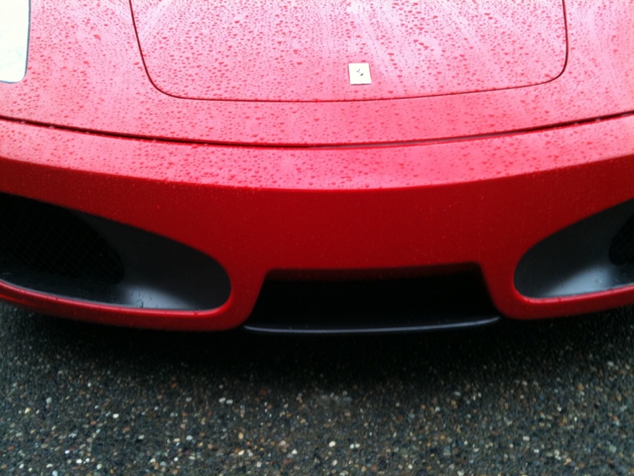

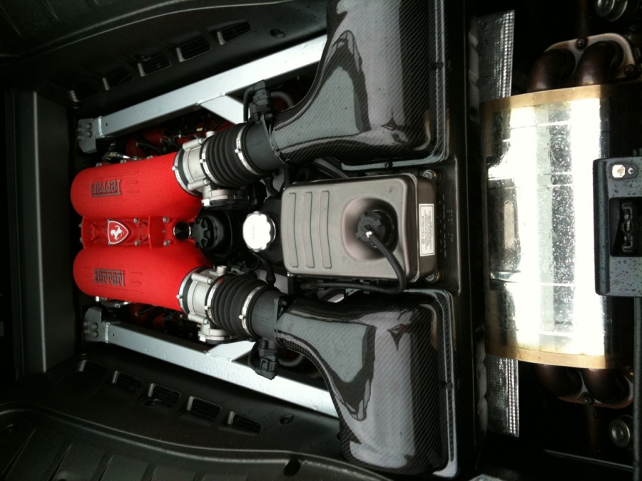

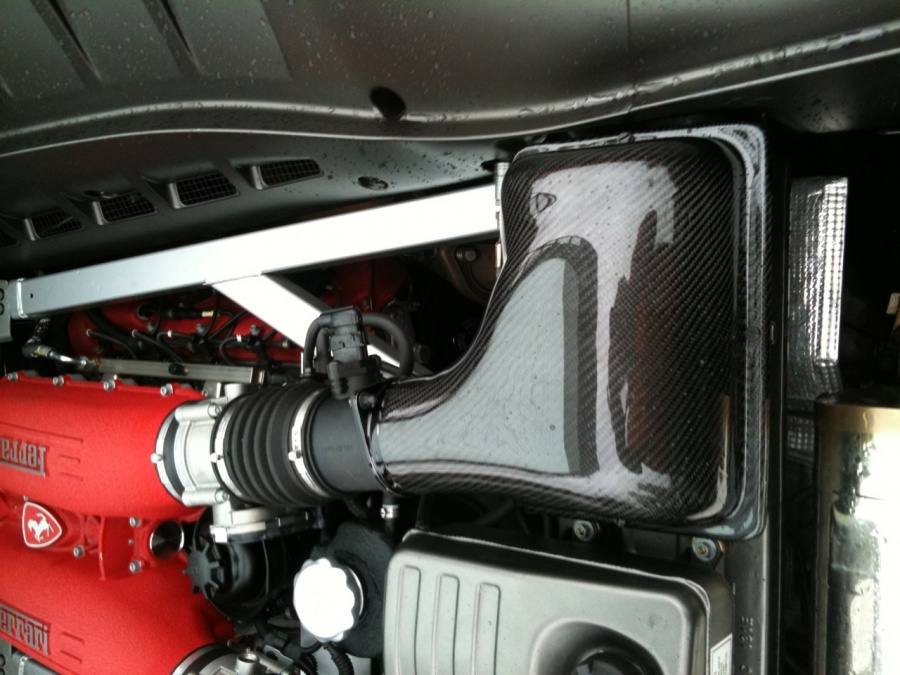

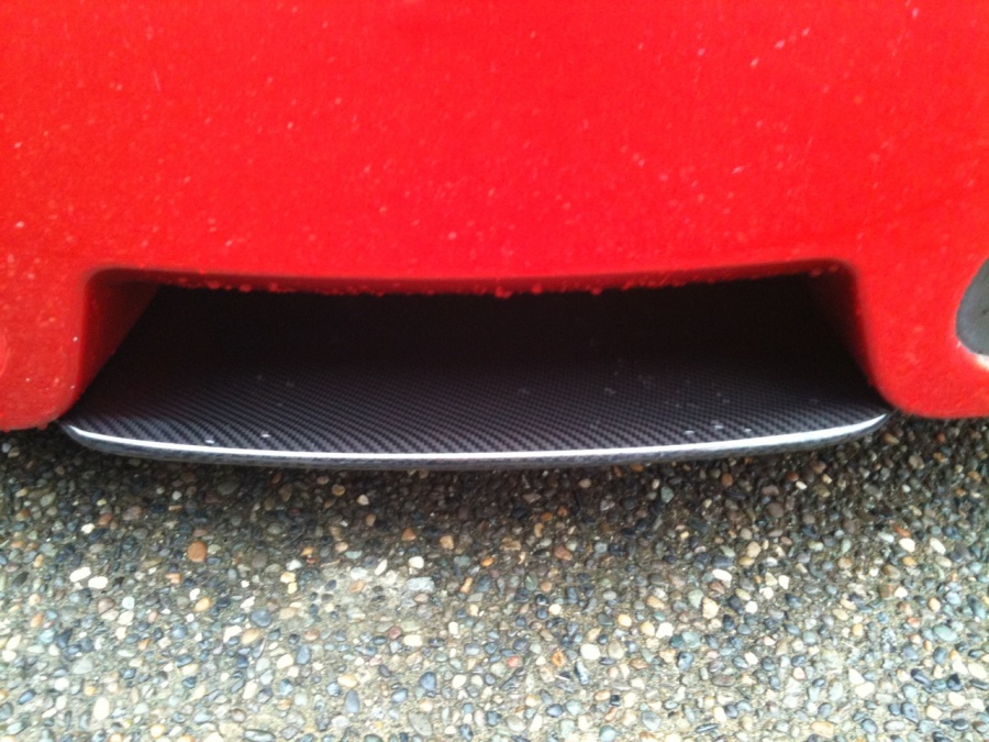

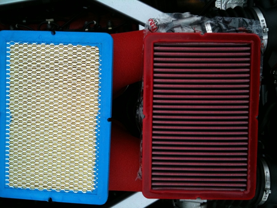

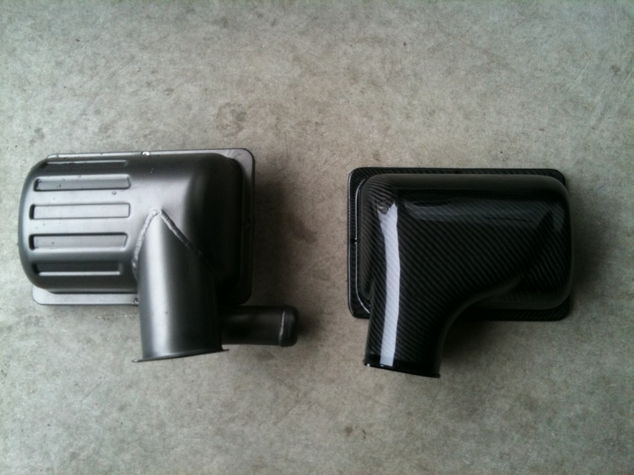

Anyways, got the parts I ordered from Fabspeed yesterday and decided to install the stuff that I can do myself this morning before work. Here is how it went:
Carbon front splitter was a cinch and it took only 20 minute including unpackaging the boxes, getting my tool out and figuring out which allen key to use. The carbon fibre piece is significantly lighter then the piece that came off the car. Probably 20% of the weight of the OEM part. It's a small piece so you'll save maybe 2 or 3 pounds off the nose. Build quality was very good. There are a couple of pics of this.
The carbon air box cover were very light as well but the factory aluminum airboxes were almost just as light except for the capped of pipe piece coming out of the underside of it. Not sure what the original intent of this pipe was. Removal of the cover was real easy. Changing both covers and air filters was 40 minutes tops including clean-up. The BMC air filter was significantly lower profile with less folds than the OEM paper filter. The BMC filters come pre-oiled and were a perfect fit.
