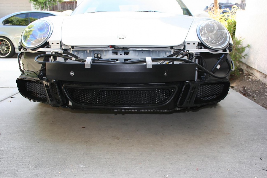

Old Aug 5, 2008 | 07:23 AM
rmag's Avatar
Joined: Jul 2006
Posts: 394
From: Virginia
Rep Power: 35
rmag is infamous around these parts
Installed
Old Aug 5, 2008 | 07:41 AM
photosteve's Avatar
Joined: May 2008
Posts: 117
From: nova
photosteve is a splendid one to beholdphotosteve is a splendid one to beholdphotosteve is a splendid one to beholdphotosteve is a splendid one to beholdphotosteve is a splendid one to beholdphotosteve is a splendid one to beholdphotosteve is a splendid one to beholdphotosteve is a splendid one to behold
rmag, that looks great!
I think I have seen you driving araound Tysons. Could that be you?
Old Aug 5, 2008 | 07:48 AM
rmag's Avatar
Joined: Jul 2006
Posts: 394
From: Virginia
Rep Power: 35
Yep that would be me

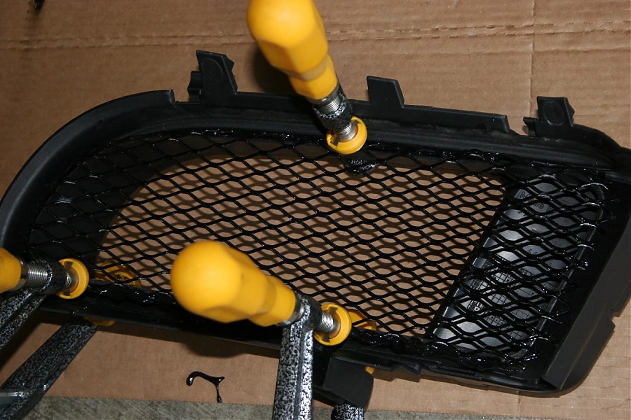

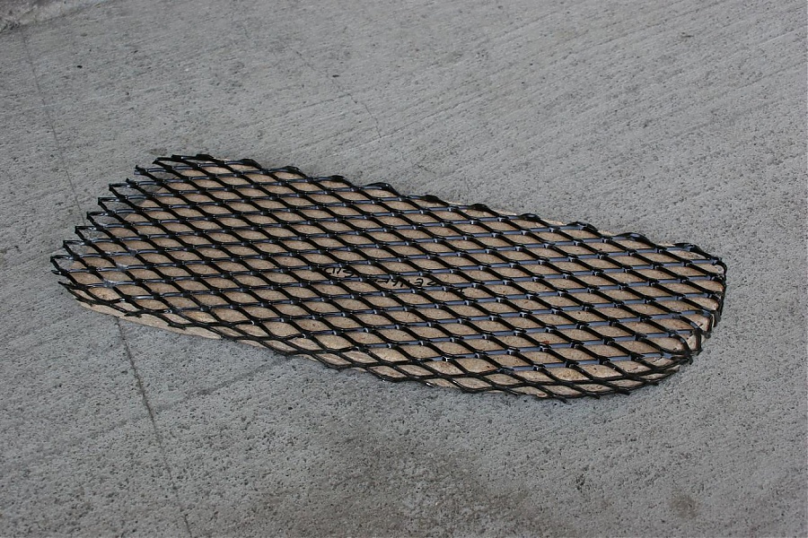

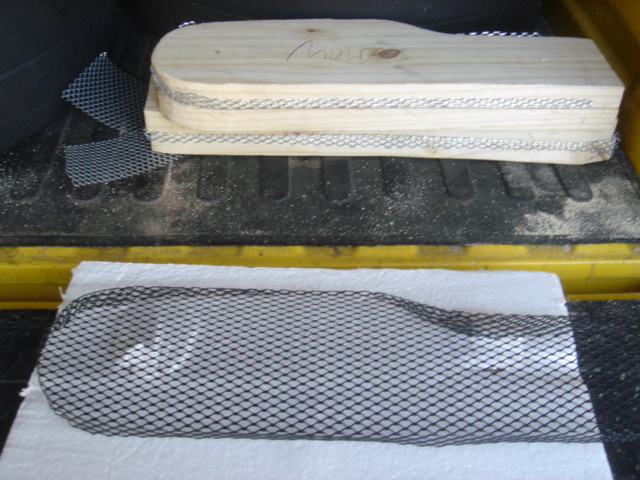

I am worried about forming stainless mesh. Does it bend? I made a form for my 996 GT3 and used aluminum fine mesh. It formed easily and kept a nice shape.
Old Aug 5, 2008 | 10:24 AM
Daytonaviolet's Avatar
Posts: 1,468
From: Bay Area, CA
Rep Power: 78
Daytonaviolet is infamous around these parts
Originally Posted by XLR8N
Fern
yes it does bend. i can bend the whole length of the mesh with my hands but probably not as nicely as the aluminum fine mesh. i believe the stainless steel mesh will take more of an impact and will not warp or flex as much when rocks and debris hit it.

Nice job making a form. I did my first set hand forming them. Took forever and was a pain in the ***! When these become toast, next set I'm going to create a form first like you!

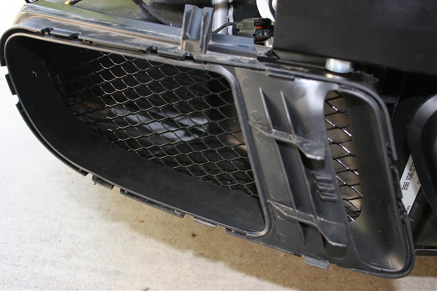

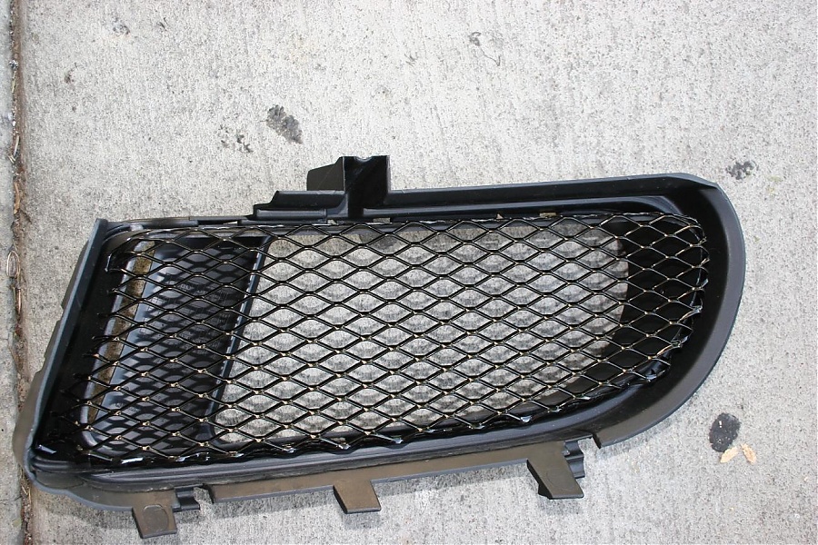

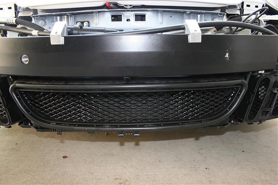

finally got some time to work on the grilles today. here are a few pictures before putting the bumper back on.

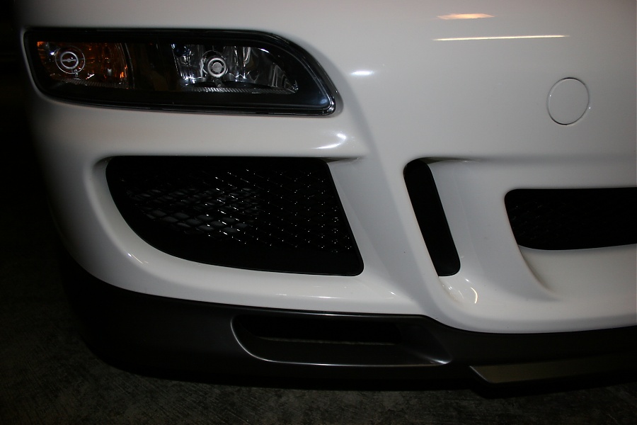

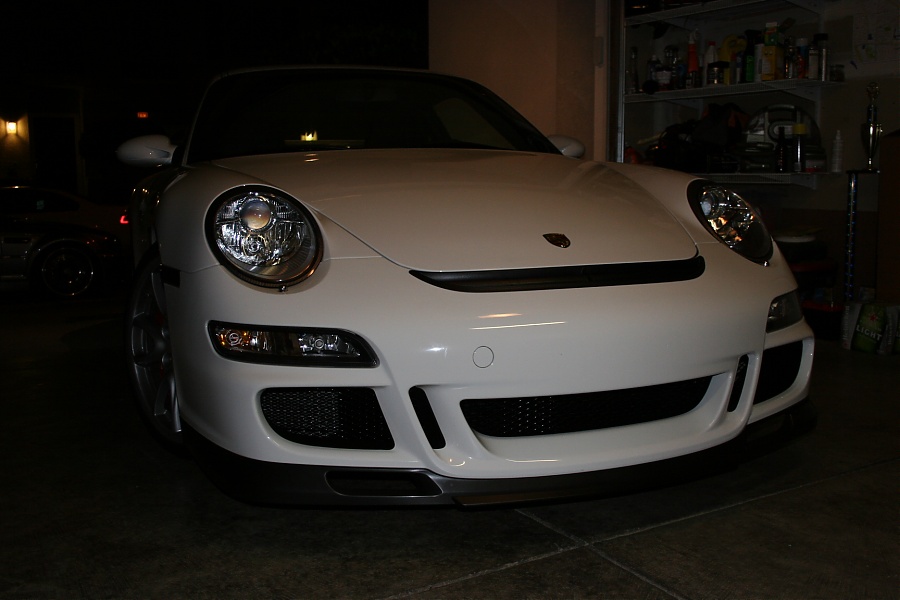

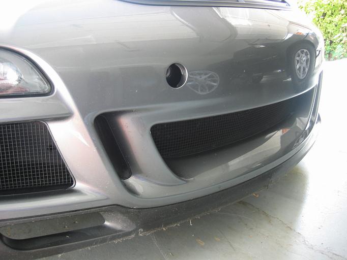

some of the pics on the car.. bumper not on yet

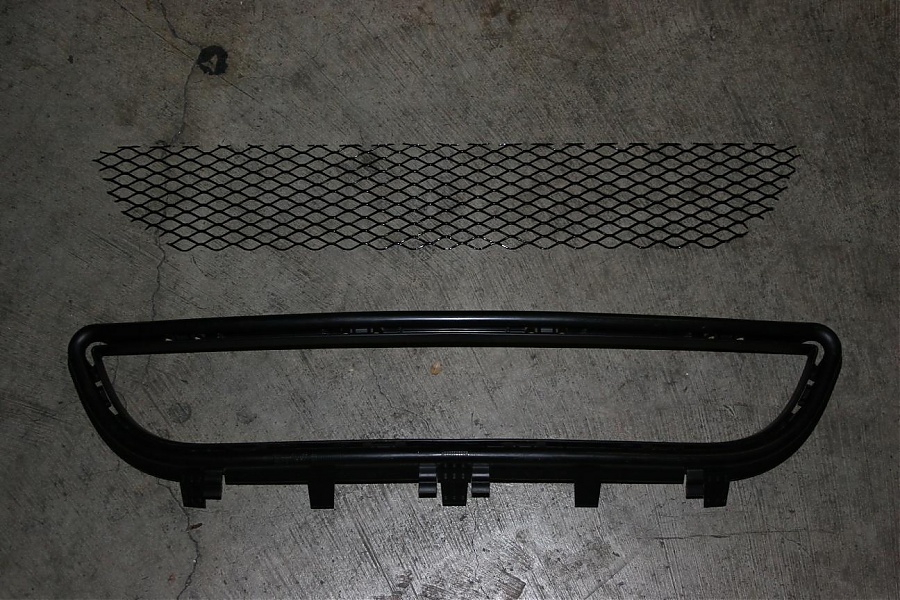

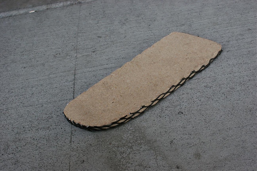

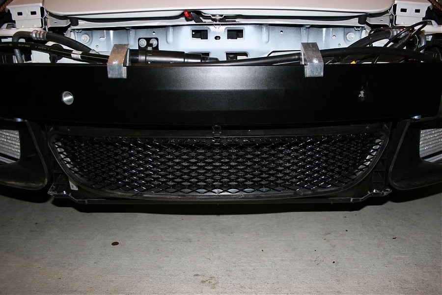

the center's require no bending. just cut to fit and it sandwiches in place.

Finally see the finishing touch. How long did part 2 take? Looks good man. You just save yourself $250. Congrats.

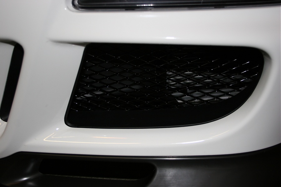

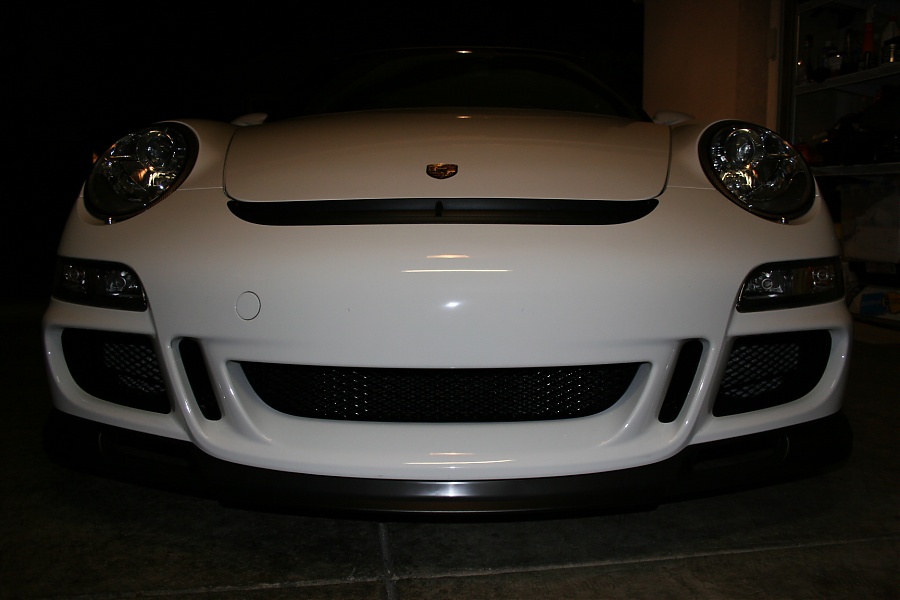

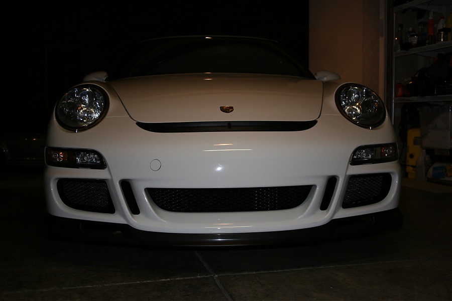

finally got the bumper back on. i also put on the RS extended lip since i had the bumper off

looking good Fern

Damn, those pictures look like my front end now.
