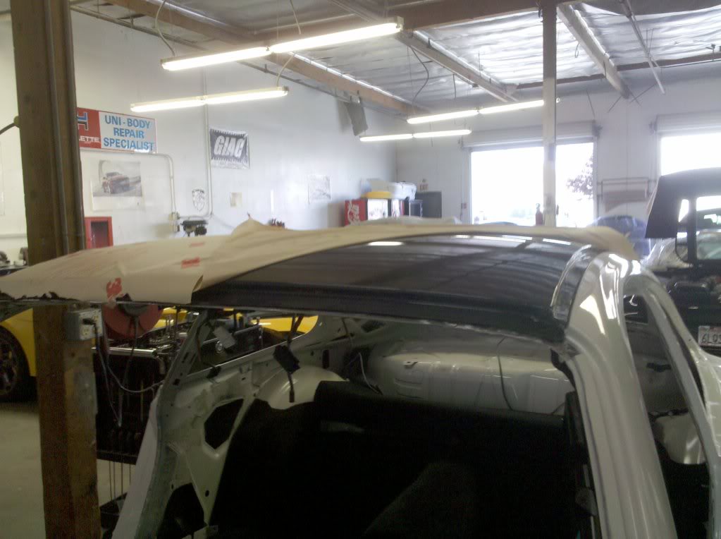

I'm doing it to my '07. Name:  2010-05-07135924.jpg
It's stripped down because I was also having RS quarters with GT2 rocker panels installed at the same time. Having a GT3 with the mandatory sunroof irritated me to no end, so I decided to change it up. If I had a 997.2 without a sunroof I don't know if I'd go through the trouble. I'll post pics of the completed project later, but the shop did a job that ended up looking like it came from the factory that way.
