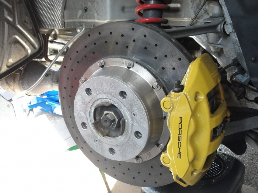

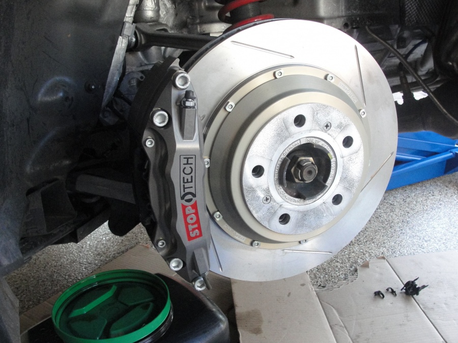

Save your money for another mod......or an aftermarket brake system (Stop Tech STR or Brembo)
The advantage was there on the 997.1 cars because the ceramic rotors are bigger, now they are same size.
I have a set from mine.....in a box......not sure what I will do with them
If you track with them, use P50 motorsports pads.....but you will have to change the pads on the street, the P50's are dangerous when not at temp

I disagree with the need to use P50 motorsports pads with PCCB rotors when tracking and the constant need to switch pads when not trailer-ing the car because the P50s are not usable on the street. Those that want to mod their GT3's to be like Cup cars for track driving would need to trailer their GT3 since any car set up for dedicated track driving would not be street-able. The GT3 exercise was developed by Porsche as a great compromise that provides track worthy capabilities that simultaneously allows the car to be driven to and from the tracks with only the use of the PASM sport selection button. The standard PCCB's as they were meant to be used addresses brake squeal, fade resistance, and temperature independence (consistent friction hot or cold), as well as dusting appearance regardless of how they are used. I really doubt that most of the people who feel the need for race mods are already at that level where they can drive the stock components at 100% of the systems capability before needing to move the goal posts or limitations to better stopping distances, later braking, etc. I've spoken to people who have switched to iron rotors and more aggressive race pads. When all is said and done the costs savings is not that much.
