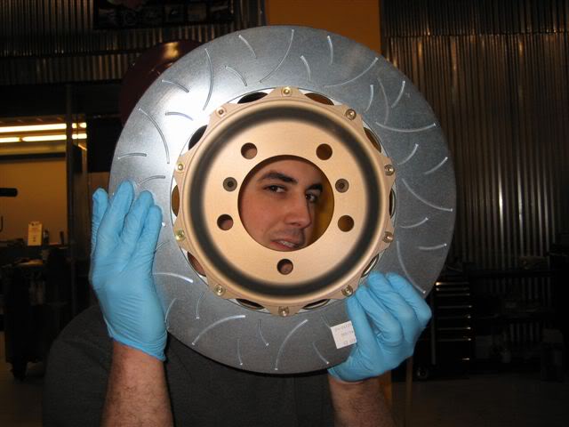

Originally Posted by jbxea1
The slotted Brembos are expensive, but claim to be more durable than the stock rotors and save about 3 pounds per corner. I replaced my front rotors with OEM stock mid Summer this year. I was thinking that when I have to replce the rears, I would upgrade all four corners to the Brembos.
they aint cheap but they are the $hit
380 mm .1 RS Pccb replacement
I run them all 4 corners with rs29 pads
