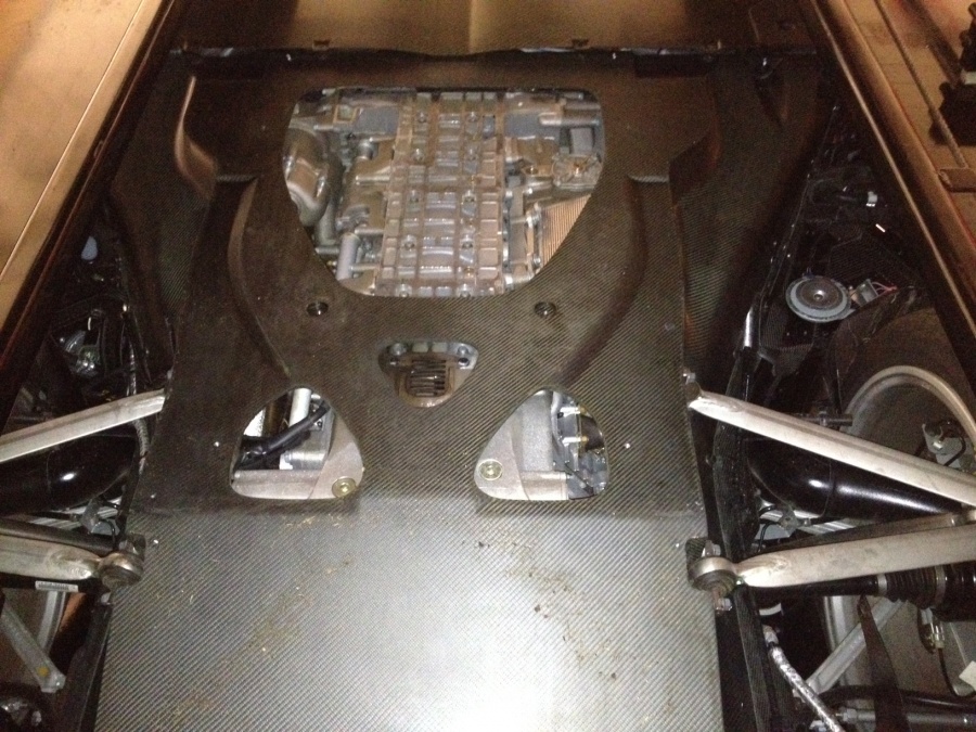

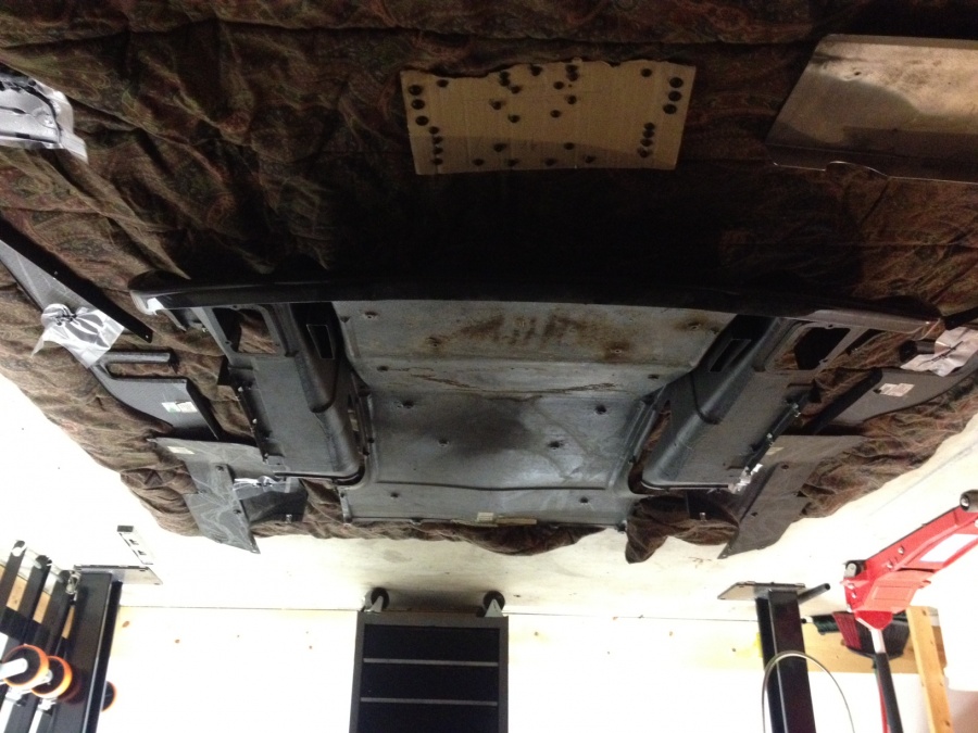

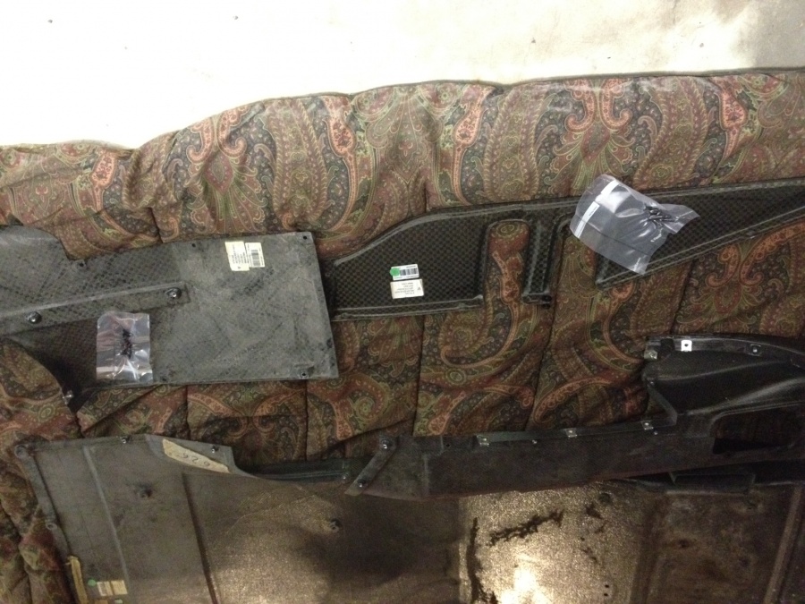

All done with the oil change, it wasn't that bad, to be honest. Took about a total of 5 hours, but was going slow. It could easily be done without a service manual, but having the service manual didn't hurt to verify all screw locations, etc.
It just takes time because there are a TON of screws, I think it's right around 80, give or take 5, to get the pieces off. There are no shortcuts around that one, it is what it is.
If any other GT owners read this and need encouragement, feel free to PM me, I could walk you through it. Only tools really needed were a T30 torx (I have a stubby one which helps in some places), a T20 torx (there are 6 that require the T20), a 13mm socket, and a torque wrench (I have a nice little compact 1/4" drive torque wrench that did wonderfully)
The torque settings for all the underbody panels are 4.5ftlbs (6nm) and I also checked the strainer while I was at it.
And no, the rear wheels do not need to be removed at all. It only makes it mildly more difficult, but barely.

This was pre-oil change, and pre-clean up of panels. They were fairly dirty down there, as you can see.
