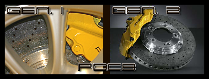

How do you tell the Gen1's from the Gen2's?

LoneRegister,
Here's a photo to show the main difference. The hole orientation is the main indicator.

Originally Posted by GTThree
LoneRegister,
Gen 2 does not look correct, despite the hole pattern. Both pics show are grayish disk, which is Gen 1. Gen 2 looks a lot more like normal steel in color, but is clearly not steel with close inspection. The color is the same as Ferrari carbon composite brakes, which are not gray.

GTThree's Avatar
Joined: Mar 2006
Posts: 47
GTThree is just really niceGTThree is just really niceGTThree is just really niceGTThree is just really nice
Shhh, but the photo I used for the Gen. 2 is directly from the 997 GT3 section of the Porsche site. Probably correct, wouldn't you think? The Gen. 1 is a shot from my 996 GT3.
The article I provided also shows a Gen 1 brake. My keychain has a Gen 1 brake. I suspect PCNA does not want to admit the flaws in Gen 1 (at least flaws I have heard about on this site, such as cracking). I have Gen 2 PCCBs on my club coupe and like them a lot. I can't say they work better than steel brakes (big reds), because my last 997 had black calipers (which worked just fine). I have not tracked my car, yet.
