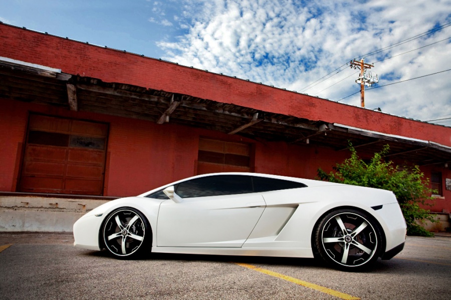

Here is the 20x12 on a 325x25x20. You can run this tire on a 20x12 but the manufacturer has to have the right offsets. All I can say is that if your wheels are sticking out of the fender, and I was in your position with the knowledge I have about wheels. They are supposed to fit inside the fender not out side and you can take pictures of it and send it to them and your credit card company and either demand new wheels and if they don't I would call your credit card company and dispute it. But if Forgiato says thats what its supposed to look like and they really said that to me I would have hung up and called my credit card company right away. Assuming that's how you paid.
