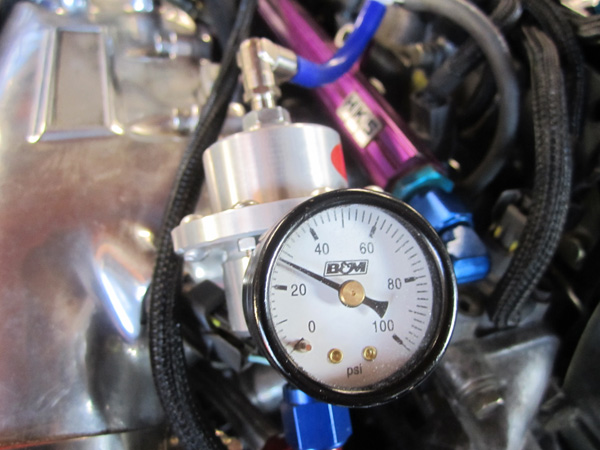

Sard Big FPR
B&M Fuel Pressure Gauge

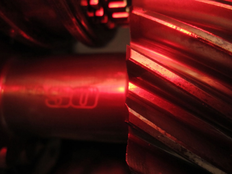

Crank .. New R34 N1 Crank.. Pic included

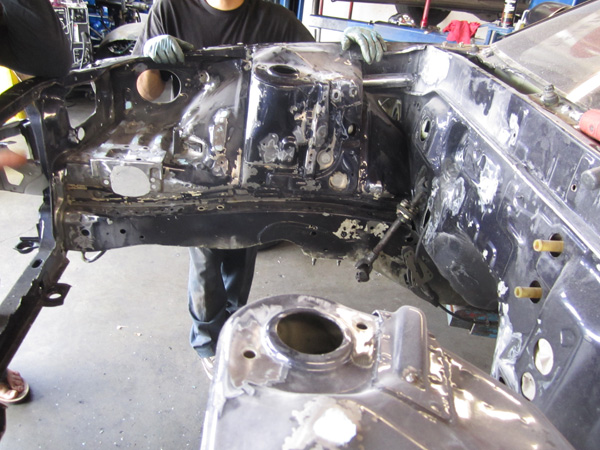

Now besides all that.. the fun part. We have been spending over a week already on rewiring the entire car. Not only that but we are tucking everything from brake lines to fuel lines... The goal is just to see the turbo and the engine..

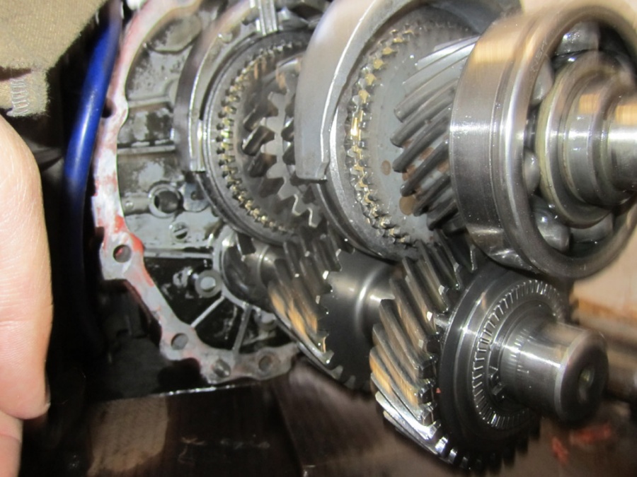

Files attached for the setup.. I might also replace the OsGiken with the Greedy Sequential.. Not sure need to look at ratios.

Things being upgraded:

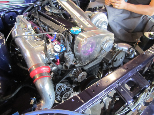

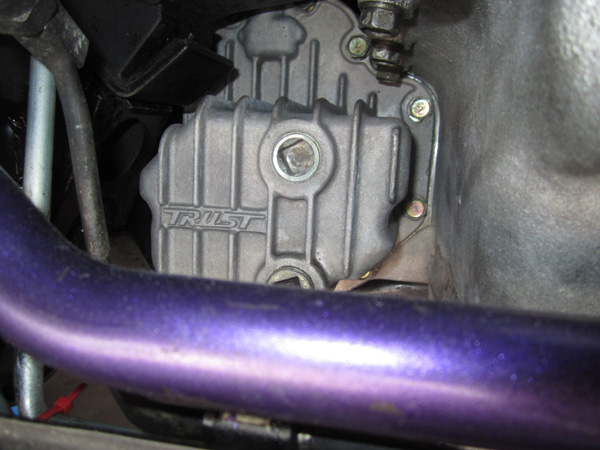

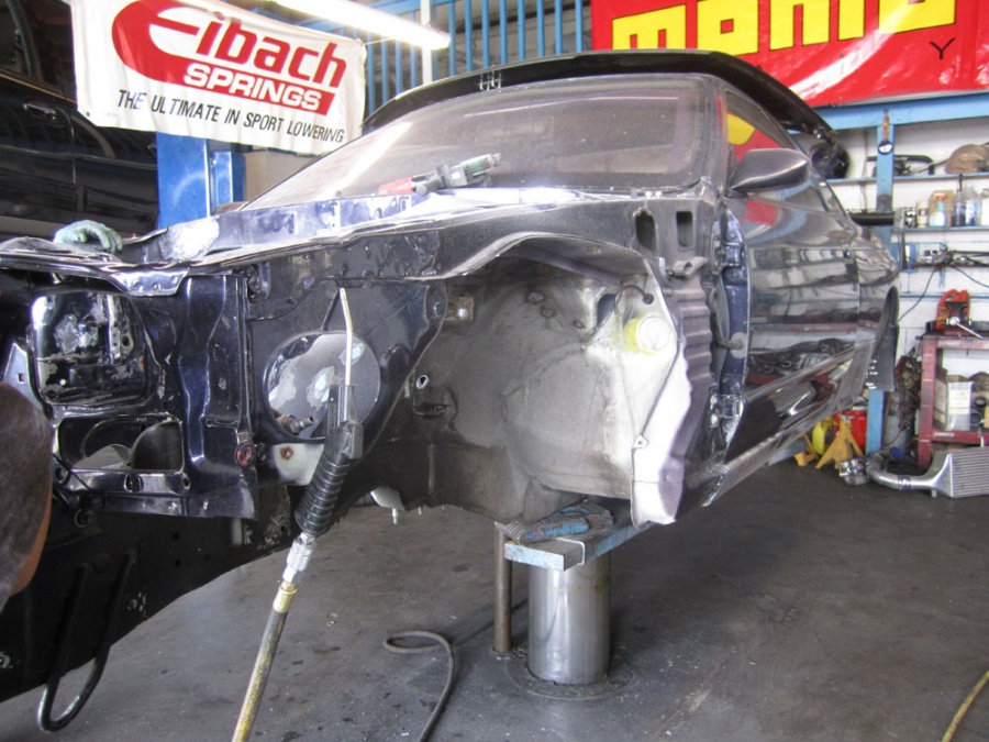

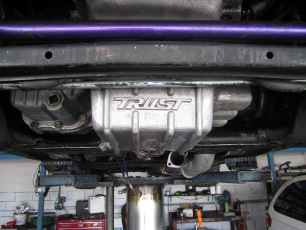

So we been working hard on the car. Will upload pics tonight.

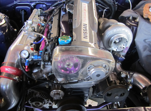

The engine is back in the car. Waiting on the ATI pulley to finish the motor. Re-wired the ENTIRE CAR. Yes that is correct over 3 weeks have been spent on redoing the entire cars wiring and tucking. The engine pictures are amazing.
I also upgraded the .61 AR to the 1.0 AR on the HKS T04z and added full meth injection. With all the mods on the car we feel 750-800awhp is not a problem. So we are tunning the car for a mild 91 octane at 450 hp and then WILD 91 octane with full meth at about 750hp.. Should be great. The car is about to be repainted next week. But as you can see the engine bay was repainted already.

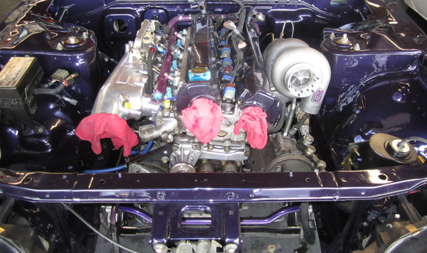

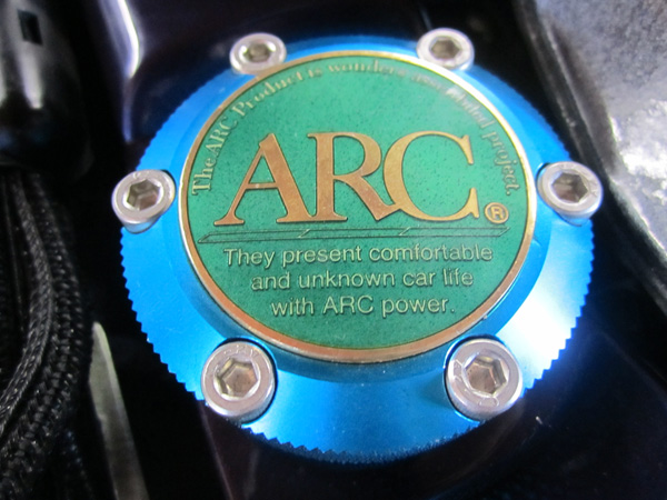

full pic of engine bay after being painted. We are redoing the breaklines to full braided, same with the clutch lines. We are keeping the Fuse box under the hood just for convenience. The meth kit is being install on monday from AEM. We turned the car on today to check the wiring and all looks great. Turned on with no problem. Now we are going to tear down the entire car again and clean everything while the car is painted. Once thats all done. The ATI dampening pulley should be back in my hands, and the car will be needing a tune.
