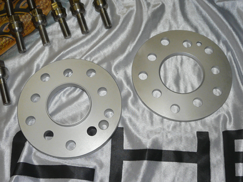

Spacer Photo Please
I do not understand how a spacer works.
Would someone please post a photo of a spacer.
Does it make the wheel / car interface weaker than stock?
Thanks, JohnnyB

Here's how one of the various suppliers word it:
"If you want to have a wider look spacers are what you need, and these spacers will do the trick, these are not your universal wheel spacers but Wheel Spacers made for your Porsche. The factory Porsche Wheels are a little to tucked, these spacers give your wheels that look that is almost flush to your Rear Quarter Panels or Front Fenders, helping you achieve that wider look and that nice wheel well finished look, you not only signifincatly improve the appearance but you also improve handling, these Wheel Spacers maximizes vehicle track width for great looks, lowered roll center, and increased lateral stability."

Do the spacers lessen the amount of threads the lug nuts purchase?
Old Sep 5, 2010 | 08:03 PM
dallascajun's Avatar
Joined: Sep 2009
Posts: 1,215
From: Dallas
Rep Power: 82
dallascajun has a brilliant futuredallascajun has a brilliant futuredallascajun has a brilliant futuredallascajun has a brilliant futuredallascajun has a brilliant futuredallascajun has a brilliant futuredallascajun has a brilliant futuredallascajun has a brilliant futuredallascajun has a brilliant futuredallascajun has a brilliant futuredallascajun has a brilliant future
If I understand your question correctly, you can use standard bolts with 5mm spacers, but for anything thicker than a 5mm spacer, you need longer bolts.
For instance:
7mm spacers require 40mm bolts
14mm spacers require 45mm bolts
Make sense?

^using stock bolts for 5mm spacer is pushing the edge. would not recommended. gotta get new longer bolts for it.
