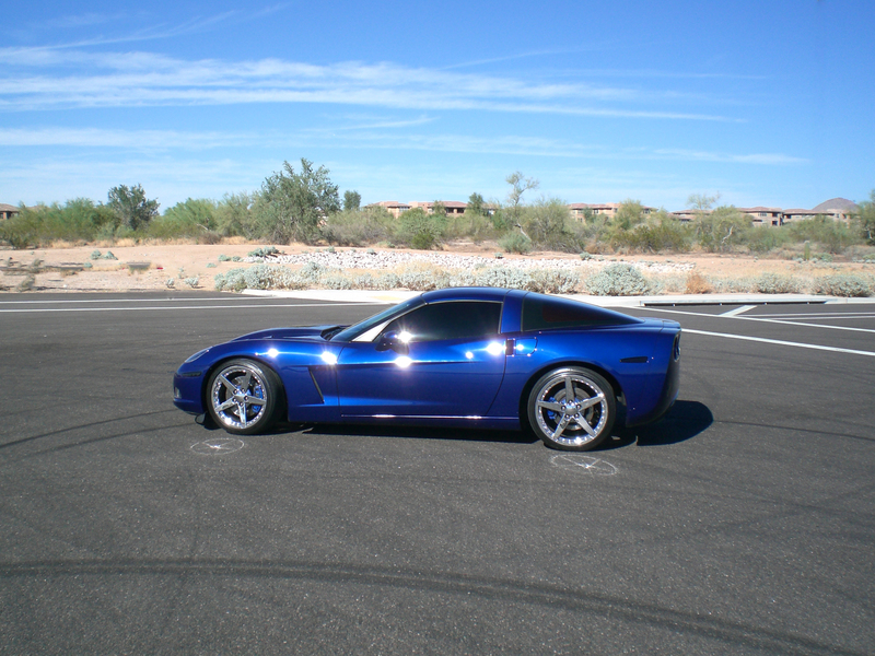

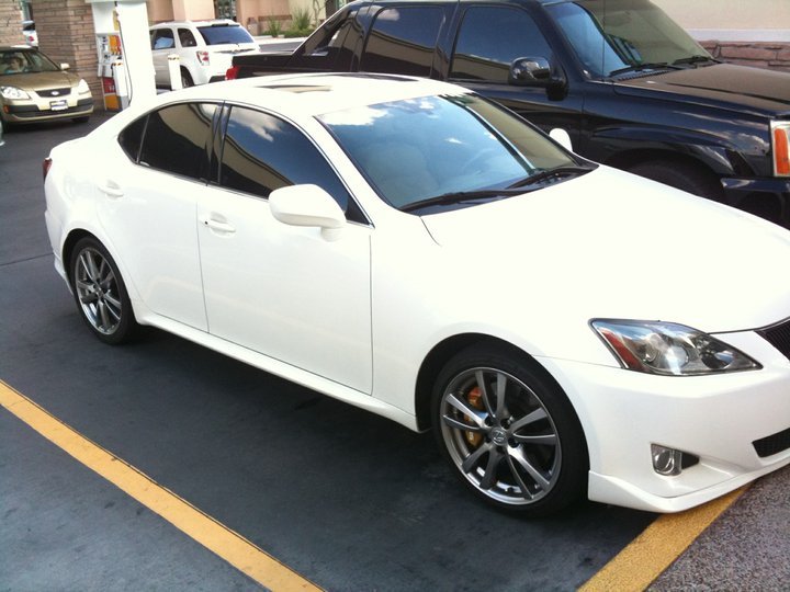

Go to autozone and get the 'duplicolor metal cast' spray paint. Its the metallic high heat stuff that has two steps. You buy a silver ground coat as the undercoat and then the top coat you choose whatever color you want. Its not specifically advertised as caliper paint, but its rated for even higher temperatures than some calipers paints.
The easiest way to do this job is to not even take anything off other than the rims. Turn the wheel and take off the rim. Cover all the stuff that could possibly be oversprayed onto with tape and newspaper. You don't have to worry too much about the surface of the rotor, as it will be burned off within the first couple minutes of driving. Then do a couple good coats, starting from the silver base coat. Follow the directions. I think you have to wait for it to dry or 'bake in the sun' for an X amount of time. After its dry, stick on a Porsche sticker that you got from online. Then add a top layer of the high heat clear coat.
Your all done! Ive done this to both my corvette and lexus, and it has turned out great. 60k miles later, the Lexus ones are still perfect and 30k miles later the corvette ones are still nearly perfect (other than the serious amount of stuck on brake dust!).
Don't buy into and of the expensive 'caliper kits'. They are nothing more than relabeled cheaper paints. The only better way to do it is powder coating, and that's not so much of a DIY job.
... If you cannot get the right angles to get all of the caliper, without taking them off then you will have to take them off. The easiest thing to do would be to get a small box that's just big enough for you to place the calipers on, without having to disconnect the brake line. So you take them off the rotor, but keep the brake line on and just place the calipers on the box and go from there. I had to do this for the Corvette but not for the Lexus.
I couldn't find better pictures on my computer, but here are the results:
