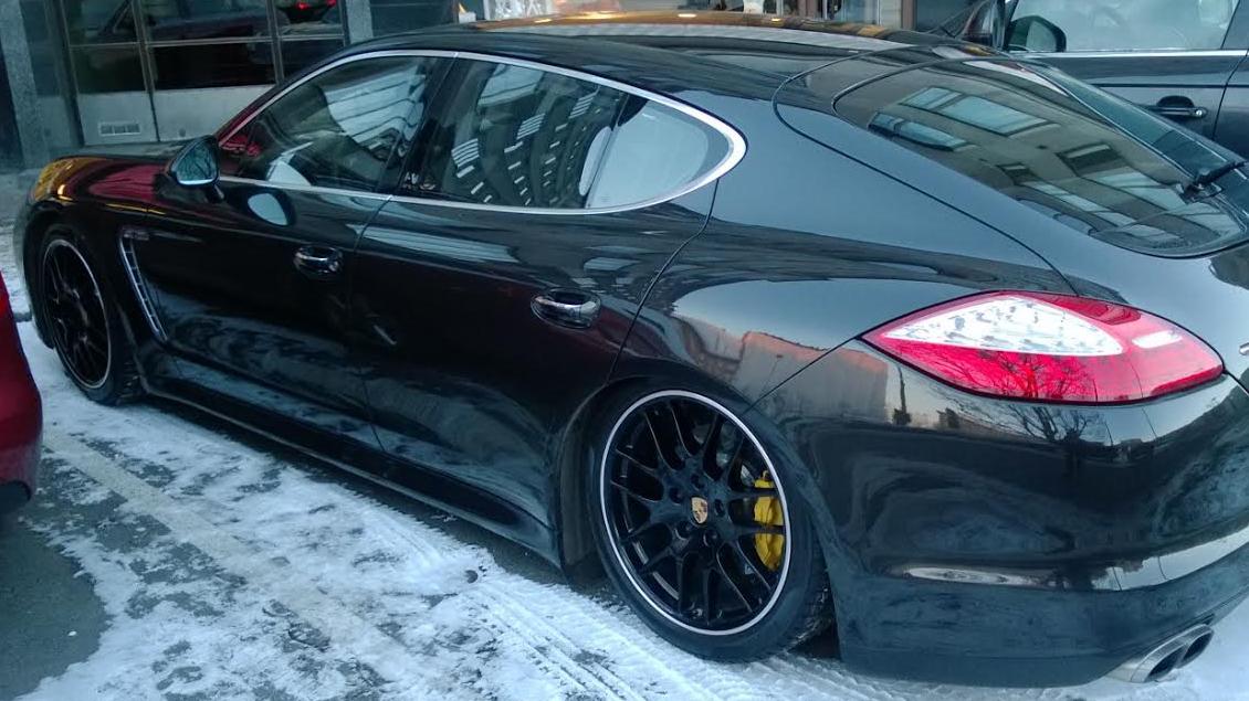

Any ideas? Air suspension compressor failure?
The weird thing it is in the back, not the front. We had -12C
Looks hot though...

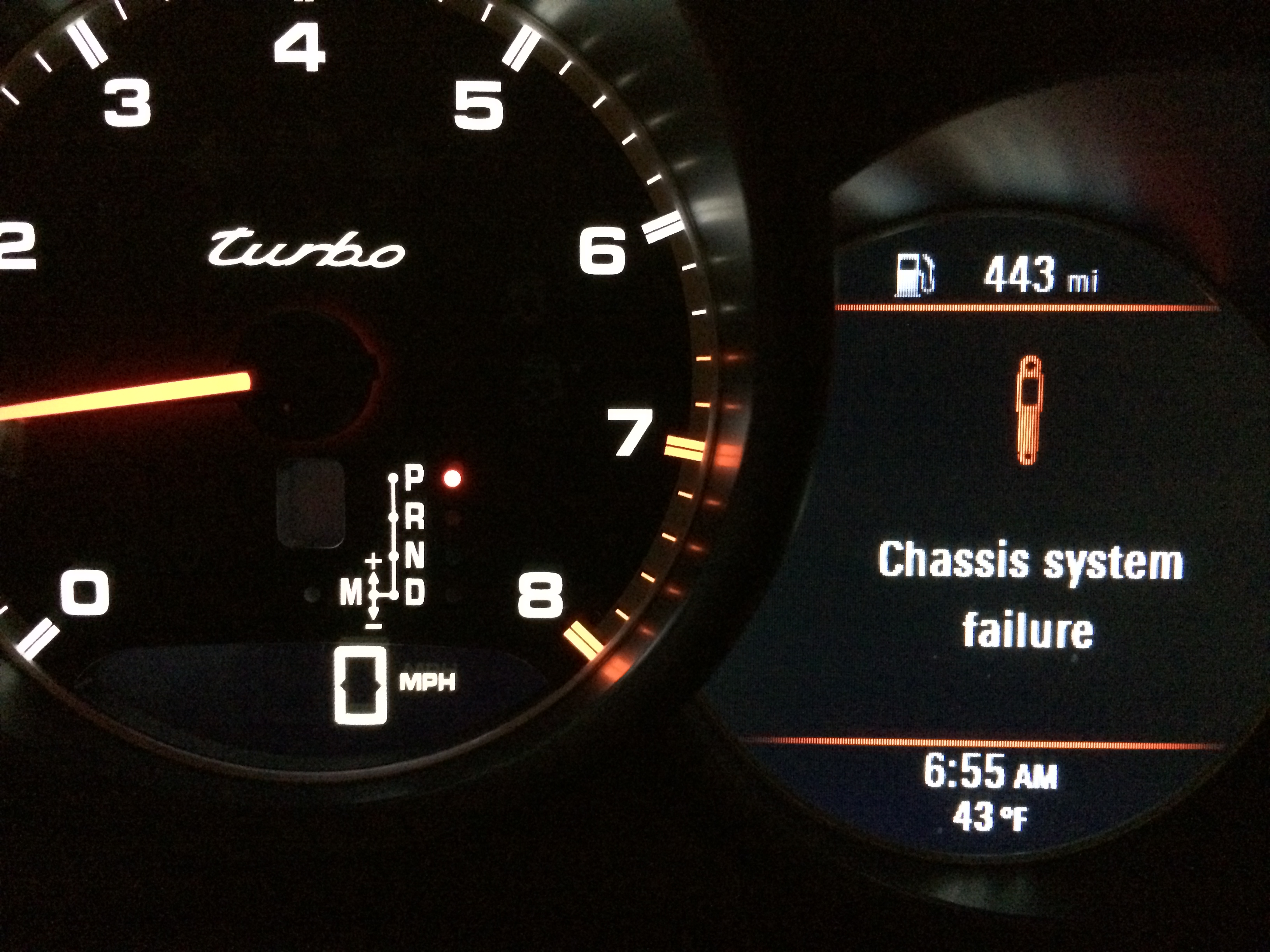

I recently got this message on my PTT (see pic). The car was in the garage (as it always is overnight), I started her up to go to work, and this message immediately appeared. I noticed nothing different about the car, so I backed it out of the garage, shut her off, and restarted her. Message didn't appear and hasn't appeared since. I had the car in to the dealer to replace a tire (see my recent rant about potholes and Pirelli Sotozero tires) and they couldn't find anything wrong with it. No fault codes, nothing. It's been really cold here so maybe that had something to do with it. Who knows. I just hope it doesn't reappear.

What are the odds. I just had the same indicator show up on my car literally 3 hrs ago and the wheels in the back looked exactly like yours. I turned off the car, waited 10 mins, restarted it and the indicator went away and it leveled itself off. Very weird.
I will have the dealer look into it so it doesn't happen again.
